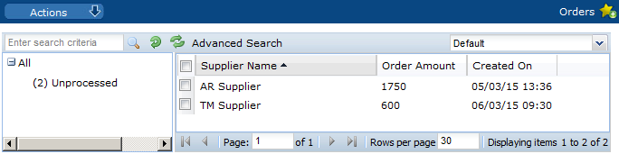

This option is used to manage registration order requests.
To work with orders:
Select Order Requests. The list of orders appears. It is sorted into processed and unprocessed orders.

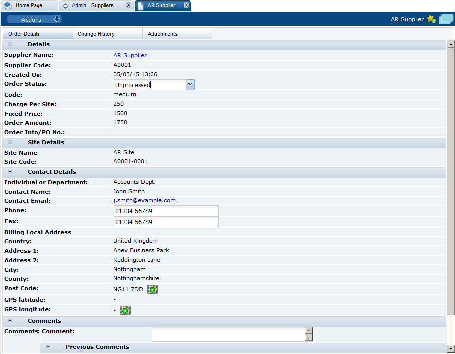

To see the details for an order, select the order and then select the View action. A new tab opens with the order details in read-only mode. For an example of the content, see Figure 7-4.
To edit an order, select the order an then select the Edit actions. A new tab opens with the order record in edit mode.
Order status: Choose the status from the drop-down list. The status can be updated to Processed once the supplier has been billed.
Contact Details: The Phone and Fax fields can be updated.
Comments: Enter any comments.

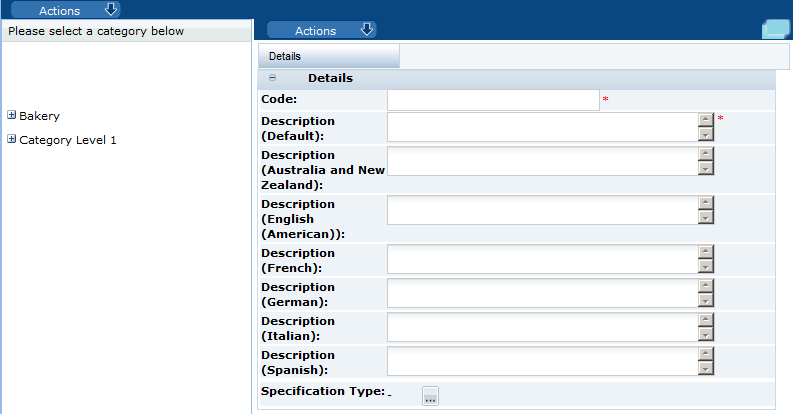

Select the Business Categories option in the left pane. The list of defined business categories appears in the right pane. Each top-level category can be expanded to show its child categories.
To edit a category entry, select the entry in the left pane and then select the Edit action in the right pane. The category opens in edit mode. The descriptions and specification types can be edited. For an example of the content of this page, see Figure 7-8.
To create a new top-level category:
Click Create new top-level category. The Business Category Details page opens.
Enter the details for the new category:
Enter the code. This is a mandatory field.
Enter the description for the default language. This is a mandatory field. Enter any translations.
To select the specification types for this level, click the icon. The Select Specification Types dialog box appears. Select the specifications for this level and click Ok.
Select the Save action. The business category is added to the list of categories.
To add child categories, select the top-level category and then select the Add Child Category action.
Enter the details for the child level and select the Save action.

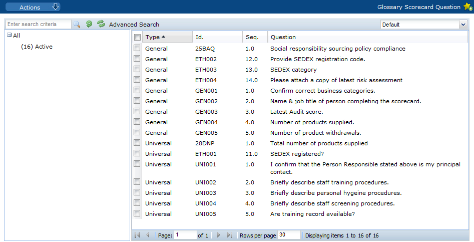

Select the Scorecards option from the Admin drop-down list. The following options are available in the left pane:
Each scorecard template is comprised of a series of questions which may be selected from this glossary.
To edit a question, select the question and then select the Edit action. A tab opens with the record in edit mode.

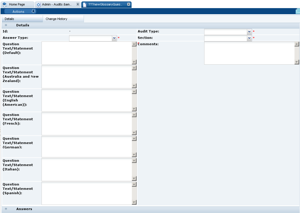

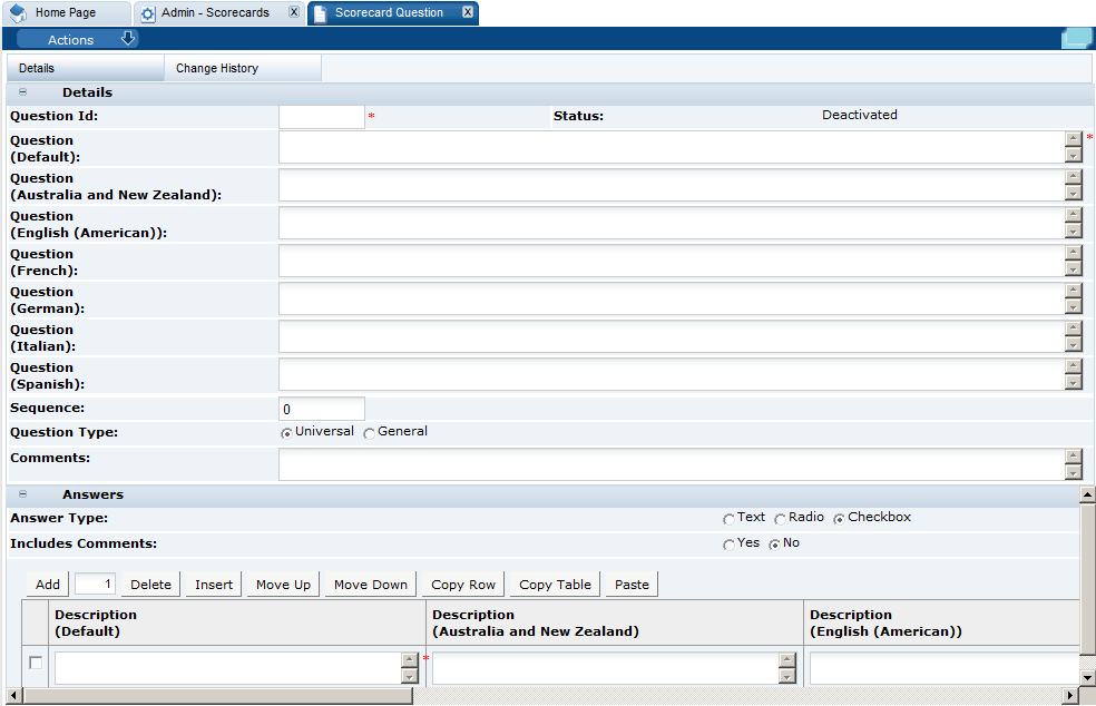

To create a new scorecard question:
Select the New Question action. The Scorecard Question tab opens.
In the Details section:
Question Id: Enter the ID for this question. The ID must be between 3 and 10 characters and unique. The value cannot be changed once the question has been created. This field is mandatory.
Status: The status is set to Deactivated.
Question: Enter the question in the default language. This field is mandatory.
Sequence: Enter the sequence number for this question. The sequence number is used to set the default order of questions within the scorecard template.
Question Type: Select the type of question:
Universal questions are automatically added to a scorecard template. These questions may be removed and individually re-added as required (if configured in System Parameters to allow removal).
General questions are manually added to a scorecard template from the questions glossary.
Comments: Enter any comments. This field is not mandatory.
In the Answers section:
Answer Type: Select the type of answers allowed for this question.
Includes Comments: If set to Yes, a text field is included in the questionnaire to enable the user to enter any comments.
To add an answer choice, click Add. Enter the answer in the default language. This is a mandatory field. Enter any translations.

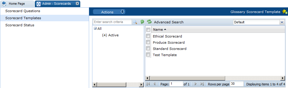

Scorecards provide a means for the retailer to assess their suppliers on an on-going (or ad hoc) basis against a set of predefined criteria. Scorecards are made up of a series of questions which may be answered by the suppler as a self-assessment or completed by the retailer.
Any number of types of scorecard can be configured, with the option to use weighted scoring for the overall grading of suppliers' responses. On completion of a scorecard, the next one can be automatically scheduled based on a predefined periodic or quarterly frequency.
Scorecard templates define the rules that control the behavior of the different types of scorecards. Every scorecard is created from a template which defines the rules for how it behaves within the system, that is, the set of questions and permitted answers, the setting of basic default values, and whether certain fields are used or hidden.
To edit a template, select the entry and then select the Edit action. A tab opens in edit mode to enable you to edit the template. For an example of the content, see Figure 7-22.

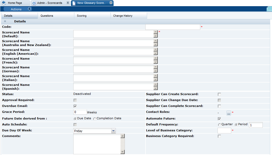

To create a new template:
Select the New Scorecard Template action. The New Scorecard Template tab opens.
Table 7-1 describes the fields in the Details section.
Table 7-1 New Scorecard Template Fields
| Field | Description |
Code |
Enter a unique code for this template. This field is mandatory. |
Scorecard Name |
Enter the name for the template in the default language. This field is mandatory. Enter the translations. |
Status |
The status is set to Deactivated. |
Supplier Can Create Scorecard |
If checked, the supplier user can choose to create this type of scorecard. The default is unchecked. |
Supplier Can Change Due Date |
If the supplier can create this type of scorecard and this field is checked, the supplier user may also change the due date of this type of scorecard. The default is unchecked. |
Supplier Can Complete Scorecard |
If checked, the supplier user may choose to complete this type of scorecard. The default is unchecked. |
Approval Required |
If the supplier can complete this type of scorecard and if this field is checked, the retailer user is required to approve this scorecard before the supplier can complete it. The default is unchecked. |
Grace Period |
Enter the number of days or weeks after the scorecard's due date when it becomes overdue. |
Overdue Email |
If checked, an email is automatically generated to the supplier if the supplier has not completed the scorecard by the time it becomes overdue. |
Contact Roles |
Select the roles for which supplier users receive the notifications if the scorecard becomes overdue. The field is mandatory. |
Future Date Derived From |
These fields are used to control the rules for automatically scheduling subsequent scorecards of this type, and when a scorecard becomes overdue. |
Automate Future |
Auto Schedule |
Default Frequency |
Due Day Of Week |
Level of Business Category |
Enter the number of levels of business category to be recorded for this type of scorecard. Set to zero if none are required. This is a mandatory field. |
Business Category Required |
If checked, the business category becomes mandatory when the scorecard is completed. |
Comments |
Enter a comment regarding this template. |
Set the questions for this type of scorecard in the Questions tab using the tables of questions for Universal, General, and Ad Hoc Questions:
Universal questions are automatically added.
General Questions are selected from the glossary of Scorecard Questions.
Ad Hoc questions can be entered specifically for this type of scorecard.
Once the questions have been added, the Refresh Preview action can be used to show the scorecard as it will be presented to the supplier.
Select any scoring rules for this type of scorecard in the Scoring subtab.

To add a checklist question:
Select the New Checklist Question action. The New Glossary/Question tab opens.
Id: This is a unique identifier of each question. It is automatically assigned as an incrementing sequence number.
Audit Type: Select the type of audit associated with this question from the drop-down list. This field is mandatory.
Answer Type: Select the type of answer associated with this question from the drop-down list. This field is mandatory.
Section: Select the section of the questionnaire from the drop-down list. This field is mandatory.
Question/Text Statement: Enter the question in the default language. This field is mandatory. Enter any translations.
Comments: Use this field to enter a comment regarding this checklist question glossary entry.
In the Answers section: The table of Answers is automatically built based on the selected answer type. The table is only applicable for Single Choice and Multi Choice answer types. For more information, see "Checklist Answers."

Scorecards |
Allow creation of Scorecards from Scorecards list |
If checked, scorecards can be created from the scorecards list views. If not checked, scorecards can only be created directly from within a Site record. |
Scorecards |
Grace period |
Select if the scorecard completion overdue grace period is in days or weeks. |
Scorecards |
Email Agent run on |
Controls which days of the week reminder emails are generated for overdue scorecards. Specific days can be selected. Buttons are available to select or clear all days. |
Scorecards |
Allow ad hoc (non glossary) questions |
If checked, scorecard templates have the option to have questions added that do not appear in the questions glossary. |
Scorecards |
Allow removal of universal questions |
If checked, whether universal questions may be removed from a scorecard template (if not, all universal questions will appear on every scorecard type |
Urgent Items |
Show Alert Items |
If set to Yes, Alert KPIs are shown in the UIM. Default is Yes. |
Urgent Items |
No. Days Before Alert Response is overdue |
Number of days before this KPI is shown. Default is two days. |
Urgent Items |
Show scorecards |
If set to Yes, scorecards are shown in the UIM. Default is Yes. |
Urgent Items |
Scorecard Overdue Off-set days |
Number of days before an overdue scorecard is shown. Default is two days. |
