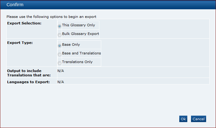

To export all glossaries:
Select any glossary and then select the Export action from the actions menu. The Glossary Export dialog box opens.
Set the Export Selection option to Bulk Glossary Export.
Set the following filters as required:
Using the Export Type filter:
This defaults to Base Only which means that all base files will be exported, and the following filters are set and locked to N/A:
Output to include Translations that are
Limit Languages to Export
If set to Translations Only, this will export all translations files for any of the selected languages.
Using the Output to include Translations that are filter:
This defaults to Populated and Blank, which exports all glossaries that have a value for any of the selected languages.
If set to Populated, the system will export all glossaries that have a value for any of the selected languages.
If set to Blank, the system will export all glossaries that have no value for any of the selected languages.
Using the Languages to Export filter:
This always begins with no languages shown as it is assumed the export will be for all languages.
Selecting one or more languages will limit the export to only those languages.
Note: Selecting more than five languages will result in an error. |
Click Submit or Submit Go to Manage Batch Jobs. A batch job is submitted to export glossaries using the filters set. All the relevant glossaries will be exported as XLS files which are compressed into a ZIP file and stored as an attachment on the job.
To export a single glossary:
Select the required glossary and then select the Export action from the actions menu. The Glossary Export dialog box opens.
If set to Base and Translations, this will export all base and translations files for any of the selected languages.
Click Ok. This will initiate the download of a ZIP file containing files according to the filters set.

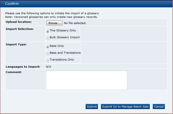

To import glossaries:
Select any glossary and then select the Import action from the actions menu. The Glossary Import dialog box opens.
Note: As the upload of files is limited to 10 MB, this may not be sufficient if you are attempting to upload all the glossaries for the system. An Administrator may therefore need to temporarily increase the File attachment size limit parameter. |
Click Browse to locate and attached the file containing the glossary files.
Note: The file being imported may be a single base file or a ZIP file containing one or more base and translation files. The system accepts CSV, XLS, or XLXS file formats. |
Set the Import Selection option to Bulk Glossary Import.
Using the Import Type filter:
This defaults to Base Only which means that all base files will be imported, and the following filter will be set and locked to N/A:
Limit Languages to Import
If set to Base and Translations, this will import all base and translation files for any of the selected languages.
If set to Translations Only, this will import all translations files for any of the selected languages.
Using the Languages to Import filter:
This always begins with no languages shown as it is assumed the import will be for all languages.
Selecting one or more languages will limit the import to only those languages.
Enter a suitable comment into the comment field.
Click Submit or Submit Go to Manage Batch Jobs. A batch job is submitted to import glossaries using the filters set. All the relevant glossaries will be imported which will be stored within a ZIP file and as an attachment on the job.

To import a single glossary:
Select the glossary in the Admin area and then select the Import action from the actions menu. The Glossary Import dialog box opens.
Set the Import Selection option to This Glossary Only.
This defaults to Base Only which means that only the base file will be imported, and the following filter will be set and locked to N/A:
If set to Base and Translations, this will import a base file and translation files for any of the selected languages.
Click Submit or Submit Go to Manage Batch Jobs. A batch job is submitted to import a glossary using the filters set. All the relevant files will be imported which will be stored within a ZIP file and as an attachment on the job.
Note: If using the Glossary Import facility to load large numbers of additional ingredients to an Ingredients glossary that is already populated, the processing time may be significant due to the validation checks that are applied.For example, uploading 4,000 additional ingredients could feasibly take around 2 hours to complete the processing. In such a scenario, it may be desirable to split the uploads over multiple smaller batches. |
