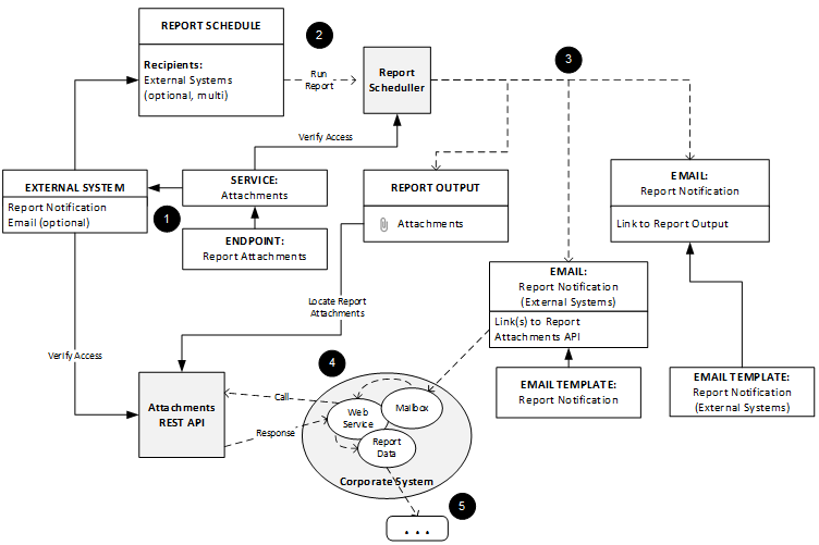

The following diagram describes the stages of the process for using the Report Attachment API to retrieve a report output.
Figure C-1 Process Flow for Using the Report Attachment API
Surrounding text describes Figure C-1 .
  1. To access the Report Attachment API, the external system must be registered in Brand Compliance as an External System with the ATTACHMENT service, the REPORT_ATTACHMENT_GET endpoint, and an email address assigned.
  2. When a report is scheduled, the external system is selected as a recipient.
  3. When the report runs, if the recipient is an external system, an email is sent containing a link to the report output attachment (may be more than one if multiple formats have been selected).
    In order to prevent the URI to the Attachment record being predictable, a 32-character non-sequential globalId key is used.
    The template of the REPORTNOTIFICATION email may be configured in the Brand Compliance Admin area; the default content is:
    Subject: Report [Report Name] is ready to view
    Body: The report [Report Name] has been created.
    Use the following link(s) to retrieve the attachment data from the attachment API.
    File name: [File Name].[File Type]
    [Link to Report Attachments API]
    File name: [File Name] File Type: [File Type]
  4. The external system initiates the call to the Report Attachment API. This may be triggered automatically on receipt of the email, or could be triggered by another event, by a scheduled job, or by a manual user action.
  5. The external system processes the returned messages and report attachment data according to its intended purpose. The data must first be decoded from Base64 encoding.
