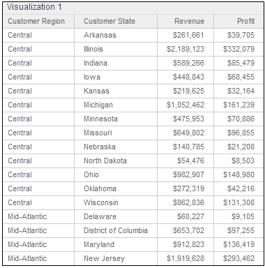

For example, a sheet contains a grid that displays revenue and profit data by geographical region and state. The values on the grid are calculated for each state, not each region, as shown below:

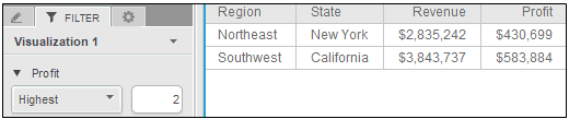

You want to display only the top two profit values, so you create a filter on the Profit metric’s values. The filter calculates the Profit metric values for the same attribute as the grid does, so the top two most profitable states are displayed, as shown below:

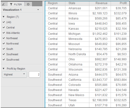

If you want to display the top two most profitable regions instead, create a top ranking filter, which allows you to specify the attribute to calculate the metric values for. A top ranking filter uses an attribute filter to specify the attribute for the metric calculation. To display the top two most profitable regions, create an attribute filter on region. Create a top rank filter, based on the region filter, that selects the two most profitable regions for display. The result is shown below:
