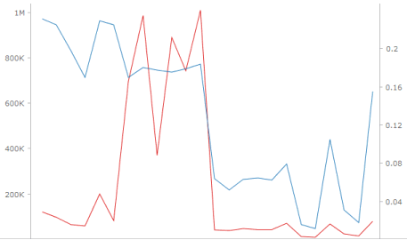

A dual-axis graph displays two different graph axes, displayed on opposite sides of the graph. This can be the left and right vertical axes, as shown in the image below, or the top and bottom horizontal axes. The following example is a dual-axis graph that displays the Profit and Profit Margin metrics on different axes, with different scales.

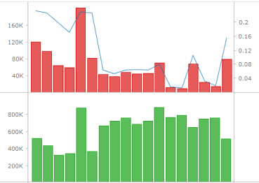

An example of adding a second dual-axis graph to a Graph visualization is displayed below.
