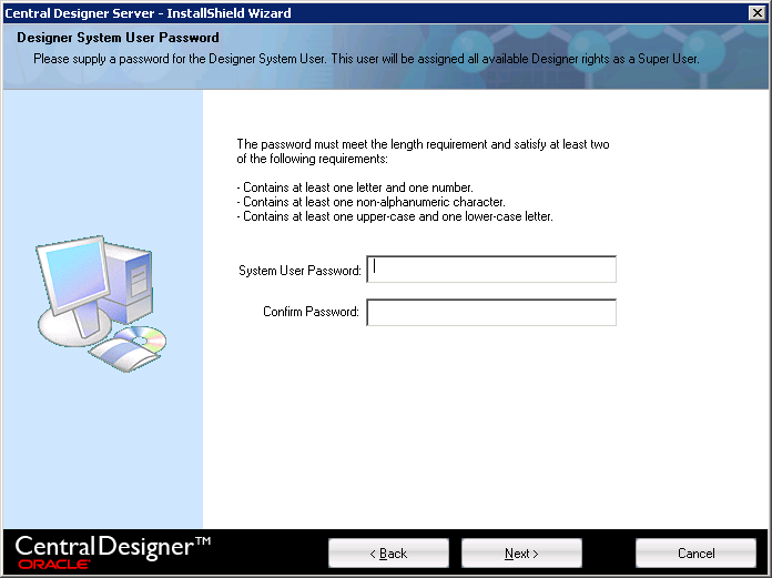

Note: Make sure that the user password meets the requirements listed on the page.
The following page appears.
The Central Designer application installs the system user by default. You can configure the lockout time for the system user separately from all other users. By default, this user is assigned the superuser and DesignerAdministrator roles.
Note: The password that you specify for the system user is also used for the archiveimporter user. For more information about this user, see the Administrator Guide.
