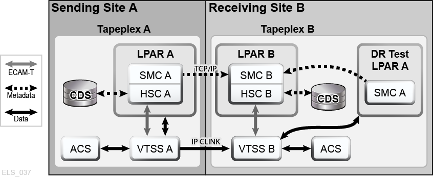

Take a look at a CTR as shown in Figure 3-1.
Figure 3-1 ELS CTR Configuration
Description of Figure 3-1 follows
Description of ''Figure 3-1 ELS CTR Configuration''
As Figure 3-1 shows:
  • CTR uses the connection between two VTSSs (CLINK) in two separate TapePlexes to send data from one VTSS to another. The connection can be either uni-directional or bi-directional.
  • CTR uses the services of the SMC client/server feature to send metadata from the sending TapePlex to the receiving TapePlex. Note that you do NOT need to use the client/server feature to communicate between SMC and HSC to use CTR, but you must define HTTP and SERVER commands in SMC to allow metadata to be transferred.
  • There are separate (and separately maintained) CDSs at each site, so that loss of connectivity or hardware availability within one site does not directly affect any of the other sites.
  • The configuration and physical connection requirements are simple and straightforward.
  • You can now run concurrent DR tests more simply and without disruption to existing work (without using the CDRT utility).
  • You can now do an automatic switchover of workload from one site to another.
  • The VTV volume ranges for the two TapePlexes are shown Figure 3-2. Note that each TapePlex has its own set of writable volumes and that these are mirrored on the other TapePlex by read-only versions.
  • The configuration shown has both VTSSs at the sending TapePlex connected to both VTSSs at the receiving TapePlex for maximum resilience.

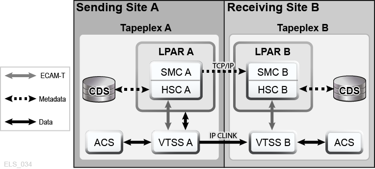

    In both Clustered VTSS and CTR configurations, you must ensure that the first 16 VTDs in each VTSS (0-F) are reserved for replication. These devices must be OFFLINE to MSP, and their paths must be online to each HSC server host. VTCS does not register the first 16 VTDs with SMC/HSC, which prevents mounting VTVs on these VTDs.
    Figure 3-2 Intra-Site VTV Volume Relationships
    Description of Figure 3-2 follows
    Description of ''Figure 3-2 Intra-Site VTV Volume Relationships''

    Figure 3-5 shows an example of CTR using business continuance.
    Figure 3-5 System During Business Continuance
    Description of Figure 3-5 follows
    Description of ''Figure 3-5 System During Business Continuance''

To continue with an example, there are two sites, TAPEPLXA and TAPEPLXB, each defined as its own TapePlex (HSC CDS), and that you have used the Cross-TapePlex Replication feature to replicate your critical VTVs from TAPEPLXA to TAPEPLXB. Figure 3-6 shows DR testing using CTR.
Figure 3-6 Disaster Recovery Testing Using Cross-Tapeplex Replication
Description of Figure 3-6 follows
Description of ''Figure 3-6 Disaster Recovery Testing Using Cross-Tapeplex Replication''
To perform a DR test at TAPEPLXB for TAPEPLXA's work, the following procedure is recommended:
  1. Ensure that the TAPEPLXB CDS contains one or more scratch subpools for TAPEPLXA output data which are separate from scratch subpools used for TAPEPLXB work.
    For examples, see "Policies for the Receiving TapePlex."
  2. Ensure that catalog and tape management data from TAPEPLXA is available.
  3. Bring up SMC on your TAPEPLXA test LPAR, defining its TapePlex as TAPEPLXB, specifying SERVER commands for one or more HSC hosts in TAPEPLXB.
  4. Begin executing your test workload.
    Your SMC will automatically have access to VTVs that existed either before or after the start of the test, because these are continuing to be replicated from TAPEPLXA. Ensure that the VTVs that your DR test will use are not scratched or altered by the TAPEPLXA TapePlex.
  5. When the test is complete, scratch all VTVs in the DR test subpool(s) used by the test.
    When using this approach, no special CDS is required, and no special rules are needed to ensure that two separate HSC systems can share hardware resources. However, this method requires that the DR test be executed using current data, or at least data that is currently available. Note that your DR test output and your TAPEPLXA replicated VTVs will use TAPEPLXB VTSS buffer space.
    Because the data that was replicated from the TAPEPLXA TapePlex is read-only, any attempts by the DR test to modify the data will result in message SMC0247, "Mount failed for write-protected VTV vvvvvv on drive dddd from SMC indicating that the VTV cannot be mounted." The occurrence of this message may indicate that your DR process does not have clearly defined application checkpoints (see "CTR VTV Read-Only Considerations"). If this is the case, the use of CTR for your DR strategy may not be a good choice.
