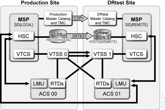

CDRT logically separates a portion of existing production real and virtual hardware and tape volume pools for the period of the DR test. This allows testing of your DR configuration while concurrently running production work, ensures the integrity of the production data, and minimizes conflicts for tape volumes and hardware resources.
CDRT creates a test copy of the production CDS. The production ELS subsystem and the DR test ELS subsystems therefore do not communicate with each other. Changes that occur in the DR test CDS are not reflected in the production CDS copy and vice versa. The DR test hosts exercise the logically separated hardware only. The production hosts continue to use all hardware with one exception: the DR hosts have exclusive use of any logically separated VTSSs during the DR test. Other resources, like RTDs, Multiple Virtual Cartridges (MVCs) and real scratch tapes, must be controlled by defining separate pools to each set of hosts.

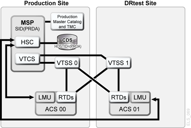

In some cases, there may be two VTSSs with the same name in both the production and test sites. In this case, the SPARE parameter of the DRTEST PRIMEPRD/CREATE utility specifies that the DR test VTSS has the same name as a production VTSS but is not physically the same device, allowing the production device to remain online during the test. Do not use the SPARE parameter for any other scenarios!
"Scenario 4: Clustered VTSSs with Production and DR Test Sites" uses clustered VTSSs to deliver data to the VTSS at the DR site. In this scenario, the cluster does not function during the DR test because the DR test VTSS is offline to production.
If production VTVs are modified in any way during the DR test, you must ensure that the modified VTVs are removed from the VTSS before varying the test VTSS back online to production. Otherwise, the modified VTVs can be picked up by the production site. To prevent this situation, StorageTek strongly recommends that the DR test is designed so that production VTVs are not altered by the test.
In a Clustered VTSS scenario there may be no VTDs in the test VTSS accessible to the production host. To allow ECAM communication from production to the DR test VTSS, specify the following in VTCS CONFIG:

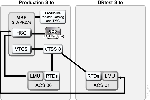

If the tape environment does not include either real tape or VLE MVCs, You can run CDRT in a shared VTSS environment. The DRTEST PRIMEPRD/CREATE SHARE parameter specifies that a VTSS is shared between production and DR test during the test. This environment enforces the following restrictions:
DRTEST CREATE cannot also define any DRACS or STORMNGR resources. That is, no data can be migrated from the shared VTSS to external media.

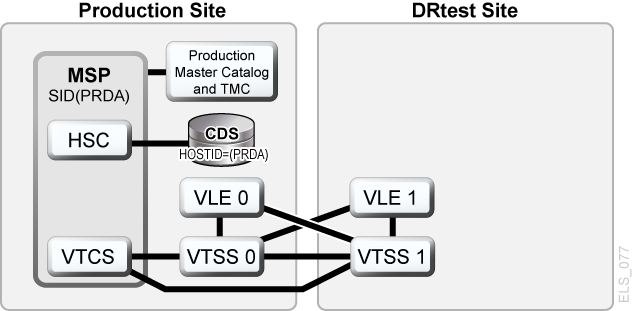

You define VLE resources using the STORMNGR parameter of the DRTEST PRIMEPRD and CREATE commands. Typically, the DR test resources are either ACSs or VLEs, although there is no restriction on using both.
Like physical MVCs, VLE VMVCs are defined using the POOLPARM/VOLPARM facility, with a range of VMVCs reserved for the DR test. The DR test also has read access to the production VMVCs as shown in the following example.

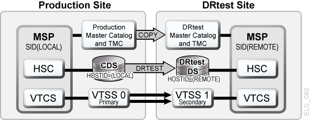

Note that the production and test sites can share a VTSS using the DRTEST DRVTSS SHARE parameter. Also note that the specifying a dummy DR ACS is no longer required for a shared VTSS or a DR test using VLE. Specifying a shared VTSS has the following restrictions:
The shared DR test VTSS should not have active RTD connections from either the production or DR test site.

At the Production Site, run the DRTEST utility (with the PRIMEprd keyword) to prepare the production CDS for the DR test.
For example, see "Example JCL for Scenario 1."
You only need to run PRIMEprd once in your environment, no matter how many DRTEST iterations you run, unless your configuration changes. If your DR test configuration changes in any way, then you need to rerun PRIMEprd. Note also that you do not have to run the DRTEST RESET utility after the DR test is complete. Although flags remain set in the production CDS, they have no effect on processing as long as the DR test is not active.
On the production system, use the HSC CAPPREF command to set all CAPs in the DR test ACS to manual mode.

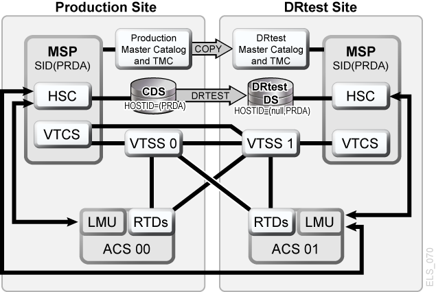

At the DR Test Site, run the DRTEST utility (with the CREATE keyword) against the mirrored or backup copy of the production CDS to create the new DR Test CDS for the DR test.
Each scenario provides a DRTEST CREATE example.
The CDSs must be allocated using the DD statements on the utility. Note that when NOUPD is used, only the SLSCNTL DD statement is required, and it can be either the actual primary CDS, a backup, or a mirrored copy.
Start the DR test at the production site, pointing to the DRTEST MGMTCLAS/STORCLAS definitions you created in Step 3.

This section tells how to use the DR Test software to set up the environment for start and stop DR testing. This section consists of the following information:
"Scenario 1: Production and Test Sites, ACS at Each Site, Spare VTSS at Test Site"
"Scenario 2: Production and Test Sites, ACS at Each Site, VTSS Takeover at Test Site"
"Scenario 3: Production and Test Sites, ACS at Each Site, No VTSSs"
"Scenario 5: Production and Test Sites, ACS and VLE at Each Site"
"Scenario 6: Production and Test Sites, VLE Only at Each Site"
"Scenario 7: Clustered VTSSs (Tapeless) with Production and DR Test Sites"
For information about the DRTEST command and DRTEST utility, see ELS Command, Control Statement, and Utility Reference. For information about CDRT messages, see ELS Messages and Codes.
For all scenarios, after the test, run the procedure in "Cleaning Up After a DR Test."In Scenario 1, there is a single ACS at both the production and test sites, and "spare" VTSS(s) at the test site used solely for testing (no requirements to migrate or restore "spare" VTSS contents). In normal operations, the production site writes and accesses VTVs on VTSSs at the production site, and output VTVs are always migrated immediately and duplexed to separate MVCs, one in each ACS. Figure 6-1 shows the system for Scenario 1 before running the DRTEST utility.
Figure 6-1 Spare VTSS Configuration - Before Running the DRTEST Utility
PRIMEPRD Step:
//DRTPRIME EXEC PGM=SLUADMIN,PARM='MIXED' //STEPLIB DD DSN=hlq.SEALINK,DISP=SHR //SLSPRINT DD SYSOUT=* //SLSIN DD * DRTEST PRIMEPRD + DRACS(01) DRVTSS(VTSS0) SPARE HOST(MSP1,MSP2)
CREATE Step:
//DRTCREAT EXEC PGM=SLUADMIN,PARM='MIXED' //STEPLIB DD DSN=hlq.SEALINK,DISP=SHR //SLSPRINT DD SYSOUT=* //SLSNEW1 DD DSN=hlq.DRTEST.SLSCNTL,DISP=(NEW,CATLG,DELETE), // UNIT=SYSDA,SPACE=(CYL,x) //SLSNEW2 DD DSN=hlq.DRTEST.SLSCNTL2,DISP=(NEW,CATLG,DELETE), // UNIT=SYSDA,SPACE=(CYL,x) //SLSNEW3 DD DSN=hlq.DRTEST.SLSSTBY,DISP=(NEW,CATLG,DELETE), // UNIT=SYSDA,SPACE=(CYL,x) //SLSIN DD * DRTEST CREATE NOUPDPRD + DRACS(01) DRVTSS(VTSS0) SPARE HOST(MSP1,MSP2)
Figure 6-2 shows the system for Scenario 1 (spare VTSS at test site) after running the DRTEST utility.
Figure 6-2 Spare VTSS Configuration - After Running the DRTEST Utility
In Scenario 2, there is a single ACS at both the production and test sites, but no "spare" VTSS(s) at the test site used for testing. In normal operations, the production site writes and accesses VTVs on VTSSs at both sites, and output VTVs are always migrated immediately and duplexed to separate MVCs, one in each ACS. In this configuration, you must demand migrate to zero one or more VTSSs at the test site and vary these VTSSs offline to the production system, so testing can take over the required VTSS resources. In addition, one or more LPARs at the test site function as displaced production systems, running in parallel with the actual production systems. Both ACSs are online to the production system.
Figure 6-3 shows the system for Scenario 2 (VTSS takeover at test site) before running the DRTEST utility.
Figure 6-3 VTSS Takeover Configuration - Before Running the DRTEST Utility
CREATE Step Only, PRIMEPRD Run Previously:
//DRTCREAT EXEC PGM=SLUADMIN,PARM='MIXED' //STEPLIB DD DSN=hlq.SEALINK,DISP=SHR //SLSPRINT DD SYSOUT=* //SLSNEW1 DD DSN=hlq.DRTEST.SLSCNTL,DISP=(NEW,CATLG,DELETE), // UNIT=SYSDA,SPACE=(CYL,x) //SLSNEW2 DD DSN=hlq.DRTEST.SLSCNTL2,DISP=(NEW,CATLG,DELETE), // UNIT=SYSDA,SPACE=(CYL,x) //SLSNEW3 DD DSN=hlq.DRTEST.SLSSTBY,DISP=(NEW,CATLG,DELETE), // UNIT=SYSDA,SPACE=(CYL,x) //SLSIN DD * DRTEST CREATE NOUPDPRD + DRACS(01) DRVTSS(VTSS1) HOST(MSP1,MSP2)
Figure 6-4 shows the system for Scenario 2 (VTSS takeover at test site) after running the DRTEST utility.
Figure 6-4 VTSS Takeover Configuration - After Running the DRTEST Utility

As shown in Figure 6-7, in normal operations, Scenario 4 is a Clustered VTSS configuration used for DR, with Production and DR Test sites cross-connected to the Production and DR Test ACSs. At the Production Site, VTSS0 is the Primary, and VTSS1 is the Secondary at the DR Test Site.
Figure 6-7 Primary/Secondary Clustered VTSS Configuration - Normal Operations
//DRTCREAT EXEC PGM=SLUADMIN,PARM='MIXED' //STEPLIB DD DSN=hlq.SEALINK,DISP=SHR //SLSPRINT DD SYSOUT=* //SLSNEW1 DD DSN=hlq.DRTEST.SLSCNTL,DISP=(NEW,CATLG,DELETE), // UNIT=SYSDA,SPACE=(CYL,x) //SLSNEW2 DD DSN=hlq.DRTEST.SLSCNTL2,DISP=(NEW,CATLG,DELETE), // UNIT=SYSDA,SPACE=(CYL,x) //SLSNEW3 DD DSN=hlq.DRTEST.SLSSTBY,DISP=(NEW,CATLG,DELETE), // UNIT=SYSDA,SPACE=(CYL,x) //SLSIN DD * DRTEST CREATE NOUPDPRD + DRACS(01) DRVTSS(VTSS1) SHARE HOST(MSP1,MSP2)
What if you want to use the DR Test Site for testing? Figure 6-8 shows the system for Scenario 4 during the DR test.
Figure 6-8 Primary/Secondary Clustered VTSS Configuration - During Test

In Scenario 6, there is a single VTSS with a VLE attached at each site. The VTSS at the test site is not a spare and is used by the production site during normal operations. The output VTVs are always migrated immediately and duplexed to separate VMVCs, one in each VLE.
In this configuration, you must demand migrate to zero one or more VTSSs at the test site and vary these VTSSs offline to the production system, so testing can take over the required VTSS resources. In addition, one or more LPARs at the test site function as displaced production systems, running in parallel with the actual production systems. Both VLEs are online to the production system.
Figure 6-11 shows the system for Scenario 6 before running the DRTEST utility.
Figure 6-11 VLE Only Configuration - Before Running the DRTEST Utility
