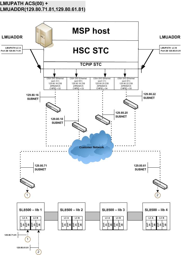

For this implementation, a dual LC configuration is one pair of LCs installed and network connected to one library in a string. This is the only valid configuration. Figure 3-1 shows an example of this configuration.
The following rules apply to a dual LC configuration. Both LCs
Should be connected to all hosts
Can be powered on at all times
Must be connected to both LAN 0 and LAN 1.
In the event of a failure from the active LC, an automated switch occurs and the standby assumes the active LC role. The HSC is informed and notifies the operator of the switch. Most outstanding requests are re-driven and all future library requests are sent to the newly activated LC. Once the failed LC is repaired and powered on, it assumes the standby role.
An operator SWitch command is provided for those occasions when it becomes desirable to dynamically activate a standby LC. The operator issues the Switch command, and the standby LC assumes the active LC role after instructing the former active LC to initiate a reboot. If the former active LC reboots successfully, it assumes the standby LC role.
Warnings and precautions apply to operating in a dual LC environment. See "Redundant LC Operational Overview" and become familiar with these requirements.Network connections must be specified for both the active and standby LCs when the HSC is installed.
Library requests cannot be automated if all network connections paths are offline to the LC, or if all network connection paths are inoperative. In a Redundant Electronics environment, if all network connection paths are inoperative to the active LC, use the HSC SWitch command to move the workload to the standby LC.

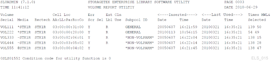

VOLRPT INCLUDE(NONMEDEQ)
This request produces a report of all volumes for which the media label on the cartridge does not match the VOLPARM media type.
The character preceding the Media indicates the type of mismatch detected. The character '*' means that the label did not match the VOLPARM media code. The character '-' means that there was no VOLPARM matching the volume. Note that these volumes also have a scratch subpool of '*NON-VOLPARM*'. The '@' character means that the volume had no physical media label.
Sample output of this command is shown in Figure 3-2.
Figure 3-2 Volume Report (Unmatched VOLPARM and External Label)

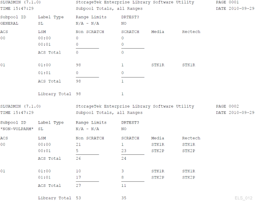

If your subpool totals only show volumes in the *NON-VOLPARM* pool, you want to get a detailed list of these volumes. There is no special control card to select these volumes, but the INCLUDE(NONMEDEQ) can be used. You also see any volumes where the VOLPARM media does not match the media on the volume label.
You can obtain a report showing subpool totals by subpool, library location, and media type without listing individual volumes by running the command:
VOLRPT SUMM(SUBPOOL) NOVOL
Sample output of this command is shown in Figure 3-3.
Figure 3-3 Volume Report (Scratch Subpools)

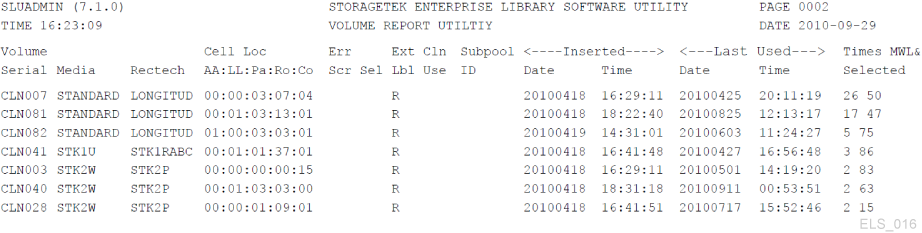

You can produce a report containing only cleaning cartridges, sorted by use count, using the following:
VOLRPT VOL(CLN%%%) SORT(USE) DESCEND
Sample output is shown in Figure 3-4.
Figure 3-4 Volume Report (Cleaning Cartridges)
The clean use count is actually the field labeled "Times Selected" at the far right. The field labeled "Cln Use" in the middle of the report indicates Y when a cleaner is overuse.

Managing scratch volumes basically means having enough scratch volumes, but not too many, and having them in the right place (preferably in an LSM with sufficient drives types compatible with the volume media). Table 3-1 describes the scratch volume management tasks and associated tools.
Table 3-1 Scratch Volume Management Tasks and Tools
| Task | Tool | Notes |
Maintain Sufficient Quantities of Scratch Cartridges |
In general: Use the If you are running low on scratch volumes, run scratch synchronization, redistribute scratch volumes, and then add more scratch volumes, in that order. For more information, see "Adding Scratch Volumes." |
Synchronizing CDS Scratch Status with TMS Status |
As described above, scratch synchronization can free scratch volumes. Typically, you do scratch synchronization after your daily TMS run. |

Displaying Scratch Subpool Information |
Display SCRatch |
This only displays scratch subpool information for the host the command is executed on; to display all scratch subpool information use the VOLRPT utility. |

Hopefully, you defined sufficient cleaning cartridges when you configured ELS. If not, Configuring HSC and VTCS tells you how. After you define the cleaning cartridges, enter them as described in "Entering Cartridges." There are some additional things you can do with MNTD (either through the PARMLIB member or command) to manage cleaning cartridges.
To manage cleaning cartridges, HSC requires them to have external labels with prefix CLN followed by 3 numeric digits. Some LTO cartridges, however, have external labels that are not in this format. In this case, contact your Oracle representative for information on obtaining external labels for LTO cleaning cartridges.To automatically select a cleaning cartridge when a drive needs cleaning, set the ”auto clean” option on:
MNTD AUTOCLN(ON)
The drive cleaning process selects a cleaning cartridge in the LSM that is closest to the drive that needs cleaning. After the clean operation is completed, the ”float” option determines whether the cartridge is returned to its home cell (float off) or assigned a new home cell in the current LSM (float on). Setting float on reduces pass-thru operations and thus enhances performance:
MNTD FLOAT(ON)
The POOLPARM MAXCLEAN parameter specifies the maximum number of cleaning operations for a given set of cleaning cartridges. For ELS to automatically eject cleaning cartridges that have exceeded their MAXCLEAN value, enter:
MNTD EJCTAUTO(ON)
If you are running ExLM, you may prefer letting ExLM manage ejecting cleaning cartridges on a scheduled basis. In this case, set ”auto eject” off. This is very useful for a ”lights-out” datacenter.
Without ExLM, auto-ejection is the recommended technique, otherwise you have to manually schedule cleaning with the CLEAN command and manually eject the cartridge when it is used up (spent) as described in "Manually Ejecting Used Cleaning Cartridges." Auto-ejection requires an available CAP. If a CAP is not available, a manual eject is required.
Newer drives identify spent cleaning cartridges and notifies ELS regardless of the MAXCLEAN usage count. If ”auto eject” is on, the cartridge is ejected when the library detects the ”spent” condition. Otherwise, ExLM can be used to schedule the ejection of ”spent” cleaning cartridges.
After you eject a cleaning cartridge, you usually want to enter a new cartridge to replace the used one. If you want to enter a cleaning cartridge whose volser is not yet defined to ELS, see Configuring HSC and VTCS for information on defining cleaning cartridges.
