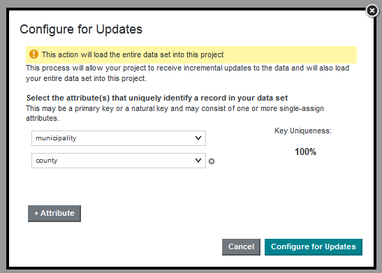

A data set must be configured for Incremental updates before you can run an Incremental update against it. This procedure must be done from the Project Settings > Data Set Manager page in Studio.
The data set must be configured with a record identifier for determining the delta between records in the Hive table and records in the project data set. If columns have been added or removed from the Hive table, you should run a Refresh update to incorporate those column changes in the data set.
When selecting the attributes that uniquely identify a record, the uniqueness score should be as close as possible to 100%. If the record identifier is not 100% unique, the total record count decreases by the number of records that have duplicate or missing identifiers. In this example, the Key Uniqueness field shows a 100% figure:
Configure for Updates dialog

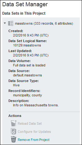

After the data set is configured, its entry in the Data Set Manager page looks like this example:
Note that the Record Identifiers field now lists the attributes that were selected in the Configure for Updates dialogue.
