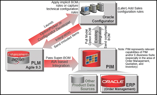

The process integration for variant management integrates Agile PLM with Oracle E-Business Oracle Configurator (CZ) and enables Agile PLM users, by using Oracle Configurator, to view different User Interfaces (UIs), created for the same Bills of Material (BOM) model, based on the user login or profile. Oracle Configurator Developer (OCD) responsibility helps the user to define rules, customize the UI, and then publish the UI based on different parameters such as application, usages, and effective dates.
Figure 9-1illustrates the cross-application integration process for the Variant Management solution.

This chapter focuses on the Agile PLM to Oracle Configurator integration flow. Other flows are discussed in the previous chapters. It also discusses the additional attributes needed for variant management in the other integration flows.

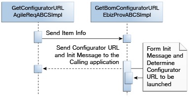

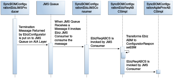

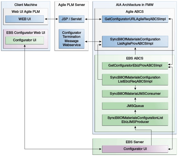

Figure 9-3 and Figure 9-4 illustrate the variant management option picker integration services orchestration.
Table 9-1 lists the activities involved in the variant management integration services orchestration related to the option picker and Oracle Configurator.

1. |
Invoke GetConfiguratorURLAgileReqABCSImpl process. |
Launch the Oracle Configurator Option Picker servlet from Agile PLM. It invokes the process to obtain the Configurator URL. |
2. |
GetConfiguratorURLAgileReqABCSImpl invokes GetConfiguratorURLEbizProvABCSImpl. |
An invoke activity in GetConfiguratorURLAgileReqABCSImpl transforms AgileGetConfiguratorURLABM into GetConfiguratorURLEBM. It also invokes GetConfiguratorURLEbizProvABCSImpl. |
3 |
GetConfiguratorURLEbizProvABCSImpl process forms initial message. |
GetConfiguratorURLEbizProvABCImpl transforms GetConfiguratorURLEBM and forms the initial message needed to launch the Configurator UI. It determines the Configurator URL from the Oracle E-Business Suite Profile option. |
4 |
GetConfiguratorURLEbizProvABCSImpl sends the response to GetConfiguratorURLAgileReqABCSImpl. |
GetConfiguratorURLAgileReqABCSImpl transforms the message into AgileGetConfiguratorURLRespABM with the Configurator URL and the Configurator UI is displayed. |

6 |
· Selecting Finish in the Configurator UI invokes SyncBillOfMaterialsConfigurationEbizJMSProducer. |
This will send a termination message through the integration to the JMS Queue. |
7 |
JMS Queue invokes SyncBillOfMaterialsConfigurationEbizJMSConsumer. |
When the message is received in the queue, the process invokes the JMS Consumer and sends SyncBillOfMaterialsConfigurationListABM. |
8 |
SyncBillOfMaterialsConfigurationListEbizReqABCSImpl invokes SyncBillOfMaterialsConfigurationListAgileProvABCSImpl. |
SyncBillOfMaterialsConfigurationListEbizReqABCSImpl receives SyncBillOfMaterialsConfigurationListABM and transforms it to SyncBillOfMaterialsConfigurationListEBM. SyncBillOfMaterialsConfiguationListEBM transforms the ABM and returns the Super BOM and selected option information to Agile PLM through SyncBillOfMaterialsConfigurationListAgileProvABCSImpl. Note: The SyncBillOfMaterialsConfigurationListAgileProvABCSImpl composite uses the oracle/wss_http_token_client_policy (or oracle/wss_username_token_over_ssl_client_policy integrated with Agile PLM 9.3.4 or 9.3.5 Web Service Security enabled) client security policy while calling ConfiguratorTerminationService hosted on the Agile server. The security credentials for this are stored in the csf-key AgileWebServicesKey on Fusion Middleware (FMW). The Agile username and password need to be setup correctly so that the Agile service is invoked successfully from the AIA composite in the FMW layer. |
The process integration for Variant management flow includes a list of services and two transaction boundaries.

The integration services for the variant management process integration are:
This ABC service requests the Oracle Configurator URL from Oracle E-Business Suite. It can be used in Agile PLM to select the option information.
The requester ABCS transforms AgileGetConfiguratorURLABM into GetConfiguratorURLEBM to obtain the Oracle Configurator URL.
This service receives the response from GetConfiguratorURLEbizProvABCSImpl with Oracle Configurator URL.
This ABC service forms the initial message needed to launch Oracle Configurator UI and determines the Configurator URL from the Oracle E-Business Profile Option BOM: Configurator URL of UI Manager.
GetConfiguratorURLEbizProvABCSImpl transforms GetConfiguratorURLEBM into Oracle E-Business ABM.
GetConfiguratorURLEbizProvABCSImpl sends a response to GetConfiguratorURLAgileReqABCSImpl.

SyncBillOfMaterialsConfigurationListEbizReqABCSImpl receives SyncBillOfMaterialsConfigurationListABM.
SyncBillOfMaterialsConfigurationListEbizReqABCSImpl transforms SyncBillOfMaterialsConfigurationListABM into the SyncBillOfMaterialsConfigurationListEBM.
In case of an error in the SyncBillOfMaterialsConfigurationListEbizReqABCSImpl service, the Web Logic Server (WLS) Java Message Service (JMS) store based resubmission lets you use the message resubmission utility to resubmit a faulted message.
The queue used by SyncBillOfMaterialsConfigurationListEbizReqABCSImpl service is a WLS JMS base queue. For more information resubmission, see "Using the Message Resubmission Utility/ WLS JMS based Resubmission "in Oracle® Fusion Middleware Infrastructure Components and Utilities User's Guide for Oracle Application Integration Architecture Foundation Pack.
