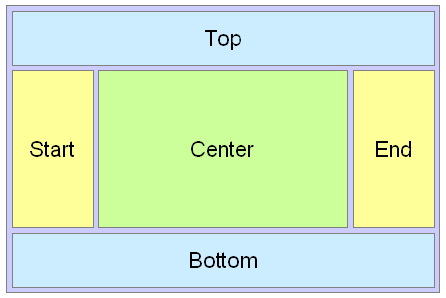

Screen Shot(s)
panelStretchLayout screenshot
A panelStretchLayout component showing the various facets.
