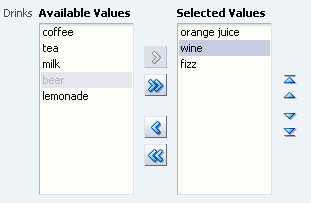

The selectOrderShuttle component provides a mechanism for selecting multiple values from a list of values by allowing the user to move items between two lists, and reordering that list of values. It includes all the functionality of selectManyShuttle, and has an equivalent API. The only functional difference is that selectOrderShuttle will present the user with the ability to reorder the list of selected values, and will deliver ValueChangeEvent when the order changes. See the documentation for selectManyShuttle for further information on using the shuttle.
If you use readOnly="true", be sure the values to be reordered are selected values, as it is the trailing list that displays in this context.
