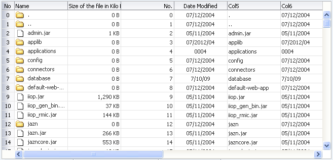

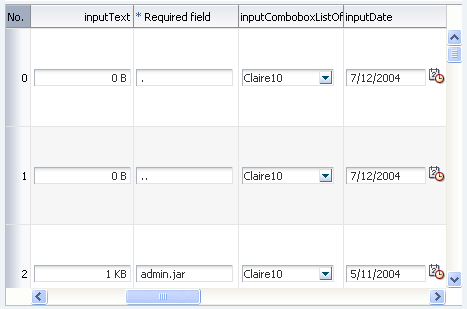

Table is used to display tabular data. It also supports row/column selection (both single and multiple), sorting, record navigation. Table is not meant for use as a layout component of disparate information. For more information about this, see the Accessibility Guidelines section.
Detail Stamp can be selectively displayed for rows in the table by EL binding the "rendered" attribute of the "detailStamp" facet to "true" or "false". The EL binding can contain references to the table "var" attribute since during rendering it will be executed in the context of the row. Disclosure icon is displayed only for rows which have rendered="true".
Components that themselves support stamping are not supported within this facet of the table, such as table, treeTable, tree, region or carousel.
Banding is a technique where groups of rows (or columns) are displayed with alternating background colors. This helps to differentiate between adjacent groups of rows (or columns).
The "rowBandingInterval" attribute on the Table controls how many consecutive rows form a row group (for the purposes of banding). If this is "0" all rows will have the same background color. If this is a positive number then adjacent row groups will have different background colors.
The "columnBandingInterval" attribute on the Table controls how many columns form a column group (for the purposes of banding). If this is "0" all columns will have the same background color. If this is a positive number then adjacent column groups will have different background colors.
