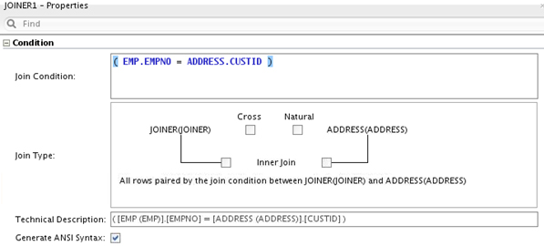

ODI does not have this property on the mapping level, but the ODI Join component has a property called Generate ANSI Syntax which has the same functionality.
The value of ANSI SQL syntax on the OWB mapping is migrated to the Generate ANSI Syntax property of the ODI Join component.
Join Condition on the OWB Join operator is migrated to Join Condition on ODI Join component. However, the OWB Join Condition references its own operator's input attributes, which is not supported in ODI; thus, the ODI Join Condition is configured to reference the attributes of the upstream sources to the OWB input attribute.

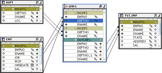

OWB mapping description: two sources joining together, the join condition is standard join (not outer join). No "Join Input Role" is specified on input attribute groups of Join operator.
Join Condition is: INGRP2.DEPTNO = INGRP1.DEPTNO and INGRP1.EMPNO > 1000
The generated code (only displays the select clause) from OWB side is:
SELECT "EMP"."EMPNO" "EMPNO", "EMP"."ENAME" "ENAME", "DEPT"."DNAME" "DNAME" FROM "DEPT" "DEPT" JOIN "EMP" "EMP" ON ( ( "DEPT"."DEPTNO" = "EMP"."DEPTNO" ) ) WHERE ( "EMP"."EMPNO" > 1000 )

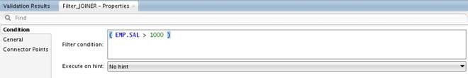

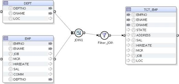

When this kind of mapping is migrated to ODI, the ODI mapping should look as follows:
The join condition for JOIN1 is: ( DEPT.DEPTNO = EMP.DEPTNO )
The filter condition for Filter_JOIN1 is: ( EMP.EMPNO > 1000 )
The operator JOIN1 in OWB mapping is migrated to a Join component followed a Filter component in ODI.

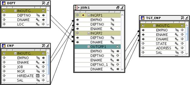

The mapping is much similar with the mapping in scenario 1. The only difference is the join condition is not a standard join. It is an outer join using (+) style.
JOIN_CONDITION is: INGRP2.DEPTNO(+) = INGRP1.DEPTNO
SELECT "EMP"."EMPNO" "EMPNO","EMP"."ENAME" "ENAME", "DEPT"."DNAME" "DNAME" FROM "DEPT" "DEPT" RIGHT OUTER JOIN "EMP" "EMP" ON ( ( "DEPT"."DEPTNO" = "EMP"."DEPTNO" ) )

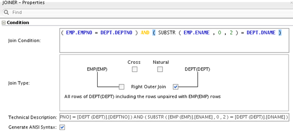

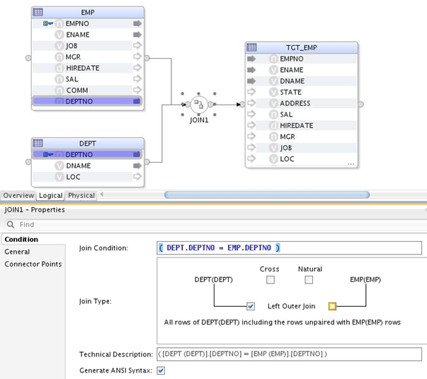

The migrated ODI mapping should look as follows:

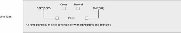

The join condition is set to DEPT.DEPTNO = EMP.DEPTNO, and the join type is set to DEPT RIGHT_OUTER join EMP.

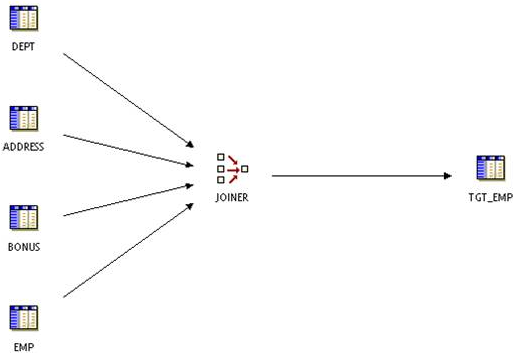

Two sources joining together, the join condition is standard join, but "Join Input Role" is specified on some of the input attribute groups of Join operator. Take the following OWB mapping as an example:
The Join Input Role of INGRP1 is set to OUTER.
Join condition is: INGRP2.DEPTNO = INGRP1.DEPTNO
SELECT "EMP"."EMPNO" "EMPNO", "EMP"."ENAME" "ENAME", "DEPT"."DNAME" "DNAME" FROM "DEPT" "DEPT" LEFT OUTER JOIN "EMP" "EMP" ON ( ( "DEPT"."DEPTNO" = "EMP"."DEPTNO" ) )

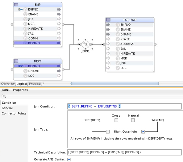

The migrated ODI mapping looks like the following:
The join condition is set to DEPT.DEPTNO = EMP.DEPTNO, and the join type is set to DEPT LEFT_OUTER join EMP.
In this case, OWB will use Join Input Role to generate code and ignore the (+) style. The migrated mapping will be the same as Scenario 3.

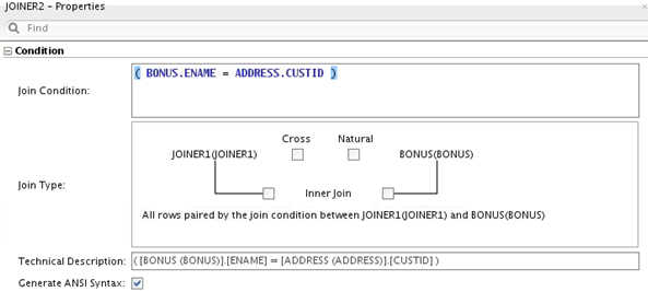

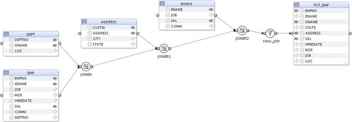

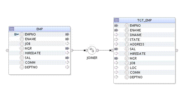

The migrated ODI mapping looks like this:
The properties of JOINER would be:
The properties of JOINER1 would be:
The properties of JOINER2 would be:
The properties of Filter_JOINER would be:

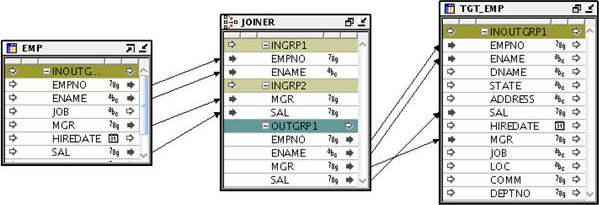

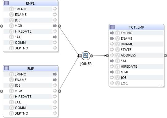

The following mapping is allowed in OWB, but it is not well supported in ODI 12.1.2.
One source table operator is connected to two input groups of the Join operator.
To support this mapping in ODI 12.1.2, the source table operator is migrated twice, producing an ODI mapping like:
ODI 12.1.3 can support the self join just as the way OWB does, so there is no need to migrate the source table operator twice, and the mapping is migrated to ODI 12.1.3 as below:
EMP component is connected to JOINER component twice by 2 input connector points of JOINER component.

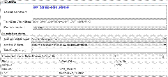

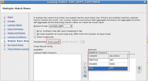

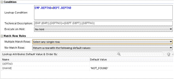

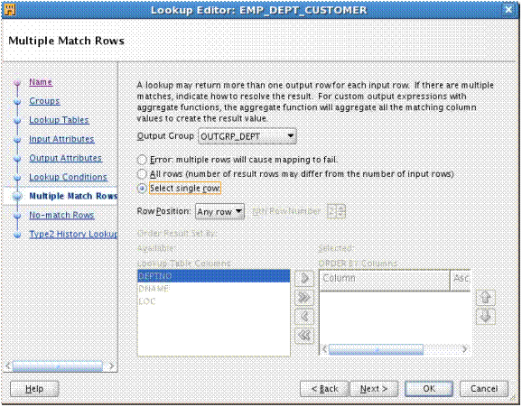

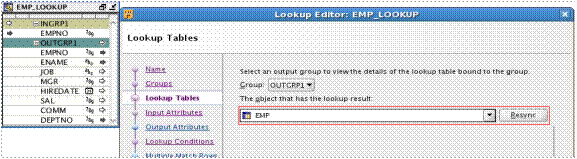

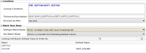

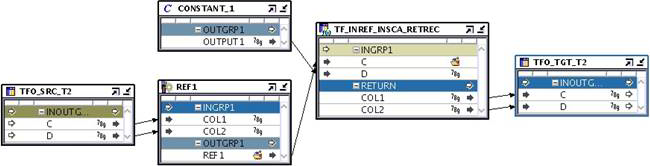

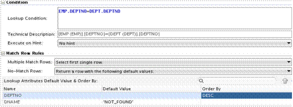

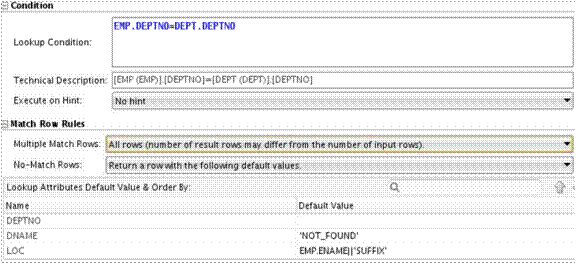

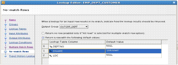

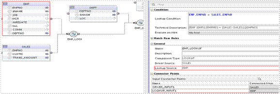

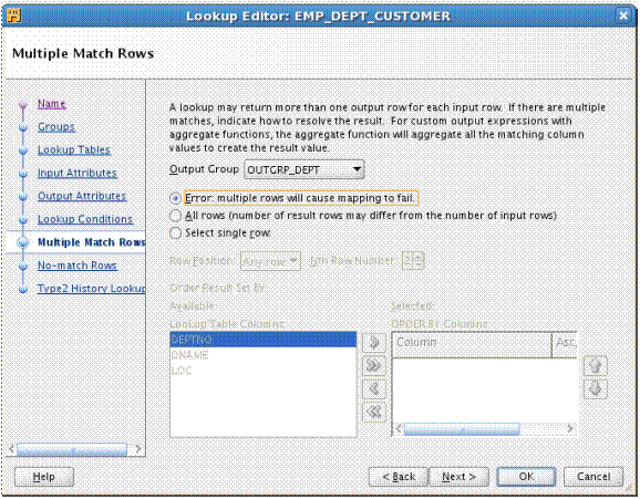

The OWB Lookup operator is not migrated to ODI directly. Instead, each of its input/output attribute group pairs is migrated to an ODI Lookup component.
If the OWB Lookup operator has multiple input/output attribute group pairs, the resulting ODI Lookup components are chained together as a binary tree.
Properties of the input/output attribute group pairs are migrated to properties of the ODI Lookup components.

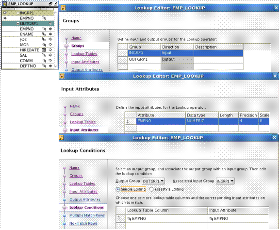

The OWB in group and input attributes will be omitted after the lookup condition converted to ODI.
<OWB In Group, Attributes, and Lookup Conditions>
The OWB Lookup Table is migrated as ODI Lookup Operator's <Lookup Source> and show up in the mapping.

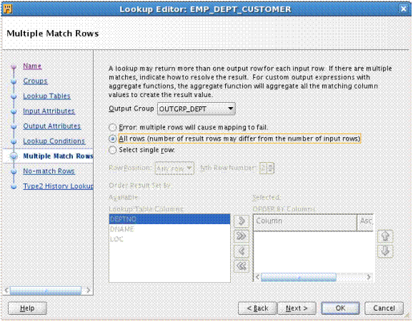

The OWB Multiple Match Rows Rules are migrated to ODI's <Multiple Match Rows>, <Nth Row Number> and <Lookup Attributes default value & order by> - Column <order by>
<OWB Multiple Match Rows – Error>
<ODI Multiple Match Rows – Error>
<OWB Multiple Match Rows - All Rows>
<ODI Multiple Match Rows - All Rows >
<OWB Multiple Match Rows - Single Row - Any Row>
<ODI Multiple Match Rows - Select Any Single Row>
<OWB Multiple Match Rows - Single Row - First / Last Row>
<ODI Multiple Match Rows -Select Single First / Last row>

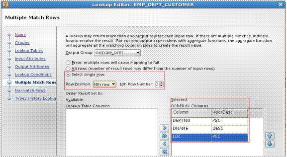

<OWB Multiple Match Rows - Single Row - Nth Row>
<ODI Multiple Match Rows - Select Single Nth Row>
OWB No Match Rows Rules are migrated to ODI No Match Rows Plus <Lookup Attributes Default Value & Order By> Default Value.
<OWB Match No Rows - Using Predefined Value>
<ODI Match No Rows - Using Default Value>

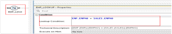

| Lookup Condition | Lookup Condition |
| Each Group's Lookup Table | Lookup Operator's Lookup Table |

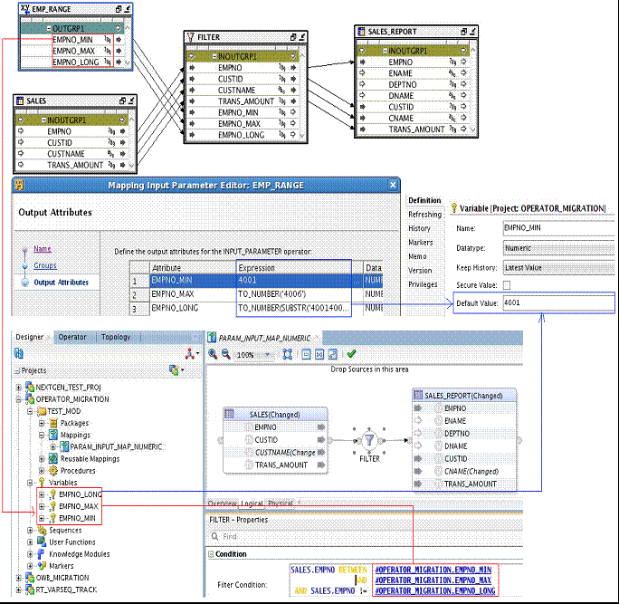

Each attribute of an OWB Mapping Input Parameter operator is migrated as one ODI variable under the project tree panel.
The default value of an attribute in the OWB Mapping Input Parameter operator is migrated as the default value of the ODI variable. If the default value is not set, the expression of the attribute is used instead.
By default, the attribute name is migrated to the ODI variable name. If the name already exists, a number is automatically appended to create a unique name. If multiple attributes of the same name are migrated, increasing numbers are used to create unique names.

The following diagram provides an example of how the OWB Mapping Input Parameter is migrated to ODI. In this diagram, note the following:

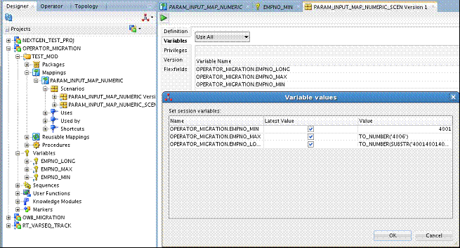

Each attribute inside the Mapping Input Parameter EMP_RANGE is migrated to a standalone variable; for example, EMP_RANGE.EMPNO_MIN is migrated to the ODI project variable EMPNO_MIN.
The attribute's default value or expression is migrated to the ODI variable's default value; for example, the expression 4001 of EMP_RANGE.EMPNO_MIN in OWB is migrated to the ODI variable EMPNO_MIN's default value of 4001.
The downstream expressions of OWB Mapping Input Parameter attributes are parsed to use the variable; for example, the FILTER condition expression has been converted to #OPERATOR_MIGRATION.EMPNO_MIN.
Once a mapping that contains an Input Parameter operator been migrated to ODI, it can be executed through the generated mapping scenario. During the execution, all the ODI variables migrated from OWB will be populated with the default value (OWB input parameter attribute's default value or expression). If necessary, you can change the value as needed, as shown in the following figure:

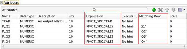

The OWB Pivot operator is migrated to the ODI Unpivot component.
| OWB Property Name | Description | ODI Property Name | Note |
| Business Name
(LOGICAL_NAME) |
Business Name
(BUSINESS_NAME) |
| Physical Name
(NAME) |
Name
(NAME) |
If the OWB name includes the string "pivot", it is changed to "unpivot". |

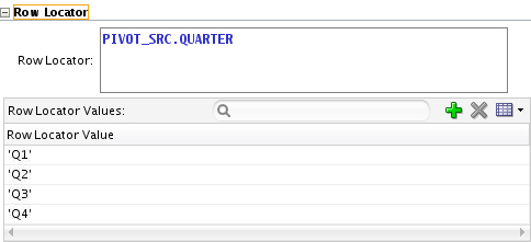

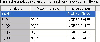

The output attribute that is set as the row locator of the OWB Pivot operator is migrated to the value of the Row Locator property of the ODI Unpivot component.
Map attribute groups of the OWB Pivot operator are migrated to connector points of the ODI Unpivot component. No specific properties for attribute group of Pivot operator need to be migrated.
Input attributes of the OWB Pivot operator are not migrated.
Output attributes are migrated. Name, Data Type, Length, Precision, Scale, Second Precision and Description are general properties described in "Mapping Attribute". Migration of the Row Locator property is described in "Row Locator". The Expression property of the OWB Output attribute is migrated to the Expression property of the ODI Output attribute.

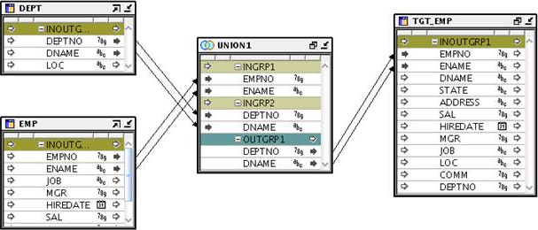

The operator attribute groups of the OWB Set operator are migrated to ODI component connector points. No specific properties need to be migrated for attribute groups of the Set operator.
Input attributes of the Set operator are not migrated.
Output attributes are migrated. The Output attribute of the ODI Set component can have multiple expressions. Each expression is associated with an input connector point. During migration, the expressions for the ODI attribute will be constructed according to the input attributes of the OWB Set operator. Take the following mapping as an example:
Union1 is a Set operator in OWB. It has two output attributes, and the two input attributes INGRP1.EMPNO and INGPR2.DEPTNO are mapped to OUTGRP1.DEPTNO.
Because INGRP1.EMPNO is connected from EMP.INOUTGRP.EMPNO and INGRP2.DEPTNO is connected from DEPT.INOUTGRP.DEPTNO, the expressions for the output attribute UNION1.DEPTNO in the ODI Set component are set to refer to EMP.EMPNO and DEPT.DEPTNO.

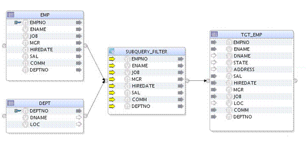

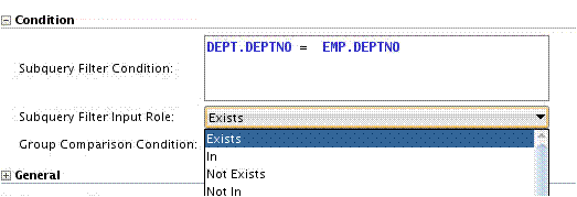

The OWB Subquery Filter operator is migrated to the ODI Subquery Filter component.
The physical name of the Subquery Filter operator is migrated to the Subquery Filter component name. The description is migrated to the component description.
The OWB Subquery Filter operator has two attribute groups: input attribute group and inout attribute group. The input attribute group of the OWB Subquery Filter operator is migrated to the ODI SUBQUERY_FILTER_INPUT connector point of the ODI Subquery Filter component. The OWB inout attribute group of the Subquery Filter operator is migrated to the ODI DRIVER_INPUT connector point and the output connector point. The two connector points use the default name instead of the OWB inout attribute group name.
Attributes in the input attribute group are not migrated. Attributes in the inout group of the OWB Subquery Filter operator are migrated to output attributes of the ODI Subquery Filter component.
An output attribute of the Subquery Filter component has two expressions. The following example describes how these two expressions are set during migration.
Using the following OWB mapping as an example:
This OWB mapping is migrated to the following ODI mapping:
The expressions for each migrated attribute are as follows:
For output attributes of the OWB Subquery Filter operator that are connected from an upstream attribute, the expression of these output attributes is set to the ODI DRIVER_INPUT connector point, and the expression references the upstream projector attribute.
In the previous OWB mapping, the attribute SUBQUERY_FILTER.INOUTGRP1.EMPNO is connected from EMP.EMPNO. After migration to ODI, the expression set on the DRIVER_INPUT connector point is EMP.EMPNO.
For output attributes of the OWB Subquery Filter operator with an IN Matching Attribute property set, the expression of this property is set to the SUBQUERY_FILTER_INPUT connector point.
For example, if the IN Matching Attribute value is DEPTNO, when migrating to ODI, DEPT.DEPTNO is set as the expression for the SUBQUERY_FILTER_INPUT connector point in ODI.

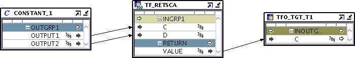

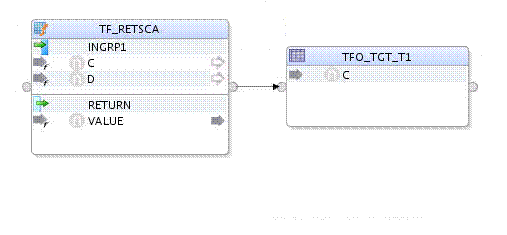

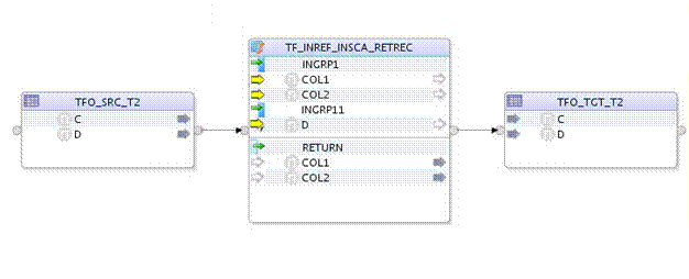

Scenarios for the Table Function operator in OWB mappings are as follows.
OWB mapping:
Mapping in ODI after migration:
The OWB output attribute group RETURN is migrated to the output connector point RETURN in ODI.
OWB output attributes in the group RETURN are migrated to output attributes in the connector point RETURN in ODI.

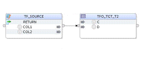

OWB mapping:
The operator CONSTANT_1 is not migrated. The expressions on its attributes are migrated to the ODI Table Function component attribute.
The OWB input attribute group INGRP1 of the Table Function operator is migrated to the input connector point INGRP1 in the ODI Table Function component. Attributes in the group INGRP1 are migrated to attributes in the connector point INGRP1. The property PARAMETER_TYPE of the input connector point INGRP1 is set to SCALAR.
The OWB output attribute group RETURN is migrated to the output connector point RETURN in ODI. Attributes in the group RETURN are migrated to attributes in the connector point RETURN. If the property RETURN_TABLE_OF_SCALAR of the output attribute in OWB is set to true, the expression of the corresponding output attribute in ODI is set to TABLE_FUNCTION_NAME.COLUMN_VALUE.
The following figure shows an OWB mapping for which the data type for attribute C in the operator TF_INREF_INSCA_REFREC is a PL/SQL Ref Cursor type, and the operator REF1 is responsible for constructing the Ref cursor.
If the input attribute group contains one or more REF_CURSOR type attributes in the Table Function operator in OWB, an input connector point is added for each REF_CURSOR type in ODI. If the REF_CURSOR type is constructed by a Constructed operator in OWB, the input attribute group of the Construct operator is used to define the REF_CURSOR input connector point for the Table Function component in ODI.
In this scenario, the OWB mapping in the preceding figure is migrated to the ODI mapping in the following figure:
Source TFO_SRC_T2 is connected to TF_INREF_INSCA_RETREC through the input connector point INGRP1. The property PARAMETER_TYPE of INGRP1 is set to REF_CURSOR. The property PARAMETER_TYPE of INGRP11 is set to SCALAR.

The Row Locator of the OWB Unpivot operator is migrated to the value of the Row Locator property of the ODI Pivot component.
The expression of the Row Locator in OWB must be redirected so that it references the attribute of the upstream source during migration.
Row Locator values in OWB are migrated to Row Locator values in ODI.
Row Locator and Row Locator values in ODI are as follows:
Map attribute groups of the OWB Unpivot operator are migrated to connector points of the ODI Pivot component. No specific properties for the attribute group of the Pivot operator need to be migrated.
Output attributes are migrated. Name, Data Type, Length, Precision, Scale, Second Precision, and Description are general properties described in "Mapping Attribute".
Properties in the Unpivot transform are as follows:
The matching row of the output attribute in OWB is migrated to the matching row of the output attribute in ODI. The expression of the output attribute in OWB is migrated to the expression of the output attribute in ODI. The expression must be redirected to reference the attribute of the upstream source.
The following figure shows these properties in ODI:
