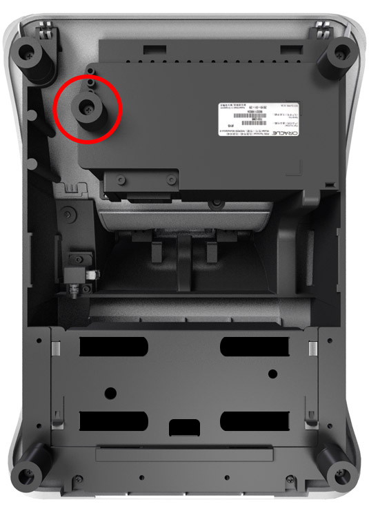

  2. Unscrew and remove the fifth rubber foot located in the upper middle of the stand. This hole will be used to secure the Adjustable Stand to the counter.
    This figure shows the location of the fifth foot on the bottom of the Adjustable Stand.

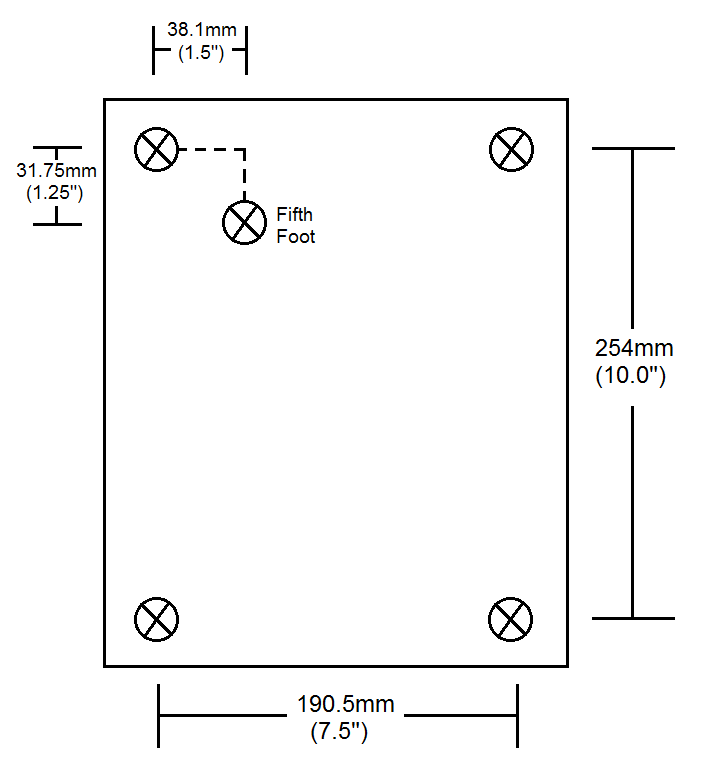

  3. Use the following dimensions to map out the location on the counter where the stand and fifth foot will sit.
    This figure shows the dimensions of the bottom of the stand and where the fifth foot sits.
  4. Mark the position of the hole for the fifth foot on the counter, and then use a drill to create the hole.
