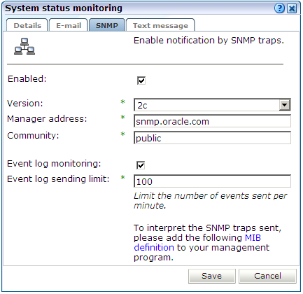

As with KPI and SLA violations, you can configure system event notifications to be sent via SNMP traps. In this case, each event reported in the Event log (described in Section 15.7, "Working with the Event Log"), becomes a separate SNMP trap.
To configure SNMP traps for system events, do the following:
Select System, then Status, and then Status notification. The System status monitoring screen appears.
Click the SNMP tab. The dialog shown in Figure 15-4 appears.
Ensure that the Enabled and Event log monitoring check boxes are checked. Note that if not, no event SNMP traps for system events are generated.
Use the Event log sending limit field to specify the maximum number of SNMP traps that will be send within a 1-minute period. This feature is useful to prevent flooding the recipient SNMP manager with excessive numbers of traps. For example, consider the case in which 500 events are reported within a 1-minute period. In principle, each of these would become separate SNMP traps. However, if the send limit is set to 100, only the most serious 100 events would result in SNMP traps being generated.
See Section 8.5.6, "Using SNMP Notifications" for information about using the other fields in the dialog.

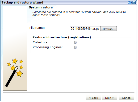

To create or restore a backup, do the following:
Select System, then Maintenance, and then Backup and restore. The dialog shown in Figure 15-8 appears.
Use the radio buttons to selected the required operation. When ready, click Next.
If you selected the Restore system from file option in Figure 15-8, the dialog shown in Figure 15-9 appears.
Click Browse to locate and select the required backup file.
By default, administration information about your Collectors and Processing Engines is not restored. However, you can use the Collectors and Processing Engines check boxes to specify that this information should also be restored. Be aware that Collectors and Processing Engines configured on your system at the time the backup was created, but which have since been removed, will be added to the restored system. Similarily, Collectors and Processing Engines currently configured on your system, but which were not configured at the time the backup was created, will be disabled. When ready, click Next.
