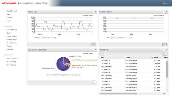

After login, you should see a web page similar to the one in Figure 2-1. The menu on the left provides general Operations Monitor functions and individual product features. The main features are described in "User Interface".
In the top-right corner, the current logged-in user is displayed.
Figure 2-1 Operations Monitor Web Interface

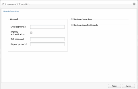

To change the default administrator password:
In the top-right corner of the Operations Monitor web interface, select admin and then select My Profile.
The Edit own user information dialog box opens, as shown in Figure 2-2.
In the Set password field, enter a new password.
In the Repeat password field, re-enter the password used in the Set password field, which verifies that the password value was entered correctly.
Click Finish.

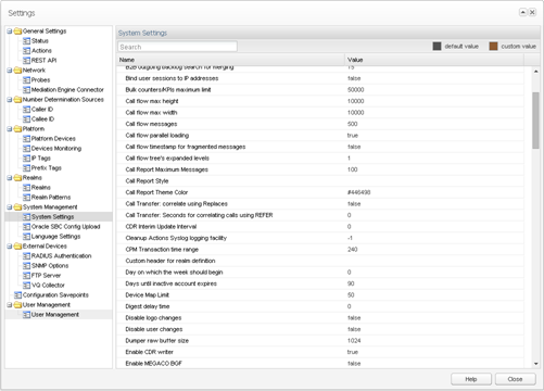

These options can be found in the System Settings menu entry from the Settings window. For more information, see "System Settings".
Figure 2-3 shows the Operations Monitor Settings page.

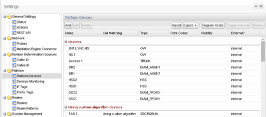

Figure 2-4 shows the Platform Devices Settings page.
In order to correlate sessions end-to-end correctly, you need to define your network topology by configuring the devices (network equipment) that process and relay the sessions and registrations in your network. For instructions on how to do this, see "Platform Devices".

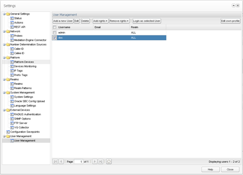

Operations Monitor offers a comprehensive system to manage user permissions that allow you to restrict certain views and functions for users.
Figure 2-5 shows the User Management page.
You can customize restrictions per user for certain pages, tabs, and product features. For example, you can restrict the ability to view raw SIP messages, change settings, and the option to create PDF reports (Figure 2-6 shows an example). For details about how to define users and assign rights, please refer to the "User Management" section of this manual. For more information on restrictions extended to single phone numbers/subscribers, see "Realms Definitions".
