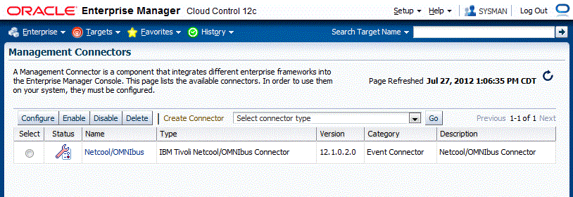

The connector instance appears as unconfigured in the Connector Setup page. Figure 3-1 shows an unconfigured IBM Tivoli Netcool/OMNIbus connector instance.
To configure the connector:
From the Setup menu of Enterprise Manager Cloud Control as Super Administrator, select Extensibility, then Management Connectors.
The Management Connectors page appears, which lists all created connector instances.
The connector is already configured if a green checkmark appears in the Status column.Click on the name of the Netcool/OMNIbus Connector.

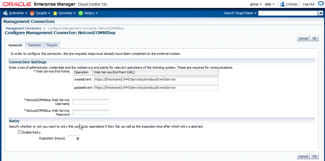

The General tab of the Configure Management Connector page appears, as shown in Figure 3-2.
Provide the required settings. See Providing General Settings for details.
Click OK.
The Management Connectors page reappears. The row for the Netcool/OMNIbus Connector should have a check mark in the Configured column.
If you chose HTTPS as the protocol to establish a connection between Netcool/OMNIbus and Enterprise Manager, make sure you have performed the steps specified in Configure Oracle Enterprise Manager to Use SSL.You can enable or disable a connector instance without needing to reconfigure or remove the connector from the system.
You can enable or disable a connector from the Management Connector page by selecting the connector and clicking either the Enable or Disable button. After a connector is disabled, the
icon appears under the Status column. By default, the connector instance is enabled as soon as it is configured.
Only enabled connectors are available to forward events.The following sections explain how to provide various configuration details:
The IBM Tivoli Netcool/OMNIbus Connector communicates with Netcool/OMNIbus through the web service for Netcool/OMNIbus installed in Installing the Web Service for Netcool/OMNIbus Front-End. All of the following fields are mandatory:
Web Service End Points: URL to use when creating and updating alerts in Netcool/OMNIbus. The web service for Netcool/OMNIbus uses the same URL for the createEvent and updateEvent operations. The default format for both operations is as follows:
https://[Hostname]:8443/services/omnibus/EventService
Modify the URL for both operations based on whether the web service for Netcool/OMNIbus was set up using HTTP or HTTPS.
For HTTP:
Change the protocol from https to http.
Replace [Hostname] in the URL with the host name or IP address of the system where the web service for Netcool/OMNIbus was installed.
Change the port number from 8443 to 8080.
For HTTPS:
Replace [Hostname] in the URL with the hostname or IP address of the system where the web service for Netcool/OMNIbus was installed.
For example:
If the web service for Netcool/OMNIbus was installed on a system with a host name of omnibusws, the following URLs would be configured for the different protocols:
For HTTP: http://omnibusws:8080/services/omnibus/EventService
For HTTPS: https://omnibusws:8443/services/omnibus/EventService
Netcool/OMNIbus Web Service Username: User name that was configured for accessing the web service for Netcool/OMNIbus in step 8 of the appropriate web service installation section:
Netcool/OMNIbus Web Service Password: Password that was configured for accessing the web service for Netcool/OMNIbus in step 9 of the appropriate web service installation section:
