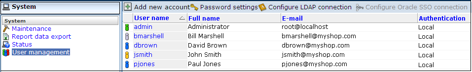

To start working with user definitions, select System, and then User management. The screen shown in Figure 14-1 appears.
This screen lists the currently defined system users. For each user account, their account name, full name, E-mail address, and authentication mechanism are listed. A user account's role and status is indicated through the color-coded scheme explained in Figure 14-2.
Figure 14-2 User Account Roles and Status

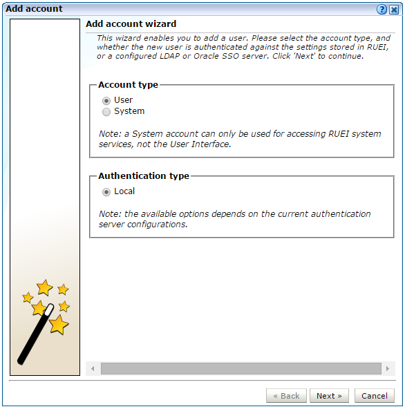

To create a new user, do the following:
Select System, then User management, and click the Add new account command button in the taskbar (see Figure 14-1). A dialog similar to the one shown in Figure 14-3 appears.
If an LDAP or Oracle SSO server connection has been configured (as described in Section 14.8, "Configuring LDAP Server User Authentication"), the dialog shown in Figure 14-3 lists an LDAP authentication option.
Use the radio buttons shown in Figure 14-3 to create a new user or system account and to specify whether the user should be authenticated against the settings held in the RUEI installation (this is the default), or against a configured LDAP or Oracle SSO server. When ready, click Next. If an LDAP server is configured, the dialog shown in Figure 14-4 appears. Otherwise, a dialog similar to the one shown in Figure 14-8 appears.

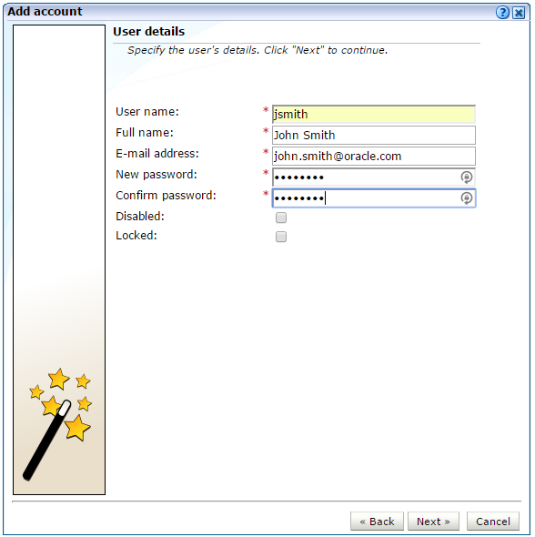

Use the dialog shown in Figure 14-8 to specify the following information for a new account:
The user name by which the user will be known within your RUEI installation. This must be a unique name. Users names are case sensitive. Note that if Oracle SSO server user authentication is enabled, the user is automatically created as an Oracle SSO user. In this case, specified user name must be the same as that defined within the Oracle SSO server.
The user's full name.
The user's E-mail address. This is the address to which reports and E-mail alerts will be sent. Ensure it is correct.
If the user will be authenticated against the settings held locally in the RUEI installation, you are required to specify and confirm a password for the new user. See Section 14.6, "Enforcing Password Security Policies" for information about password requirements. Note that the new password must be changed by the user within seven days or they are locked out.
Optionally, use the Disabled check box to disable the user at this time. You are free to enable them later.
If you selected user authentication against a configured LDAP server in Figure 14-3, you can click the Get user data from LDAP button to retrieve the user's settings from the configured LDAP server.
Click Next to continue. If you are adding a User account, proceed to step 4. If you are add a system account, as described in Section 14.1, "Introduction to Users and Permissions", proceed to step 5.

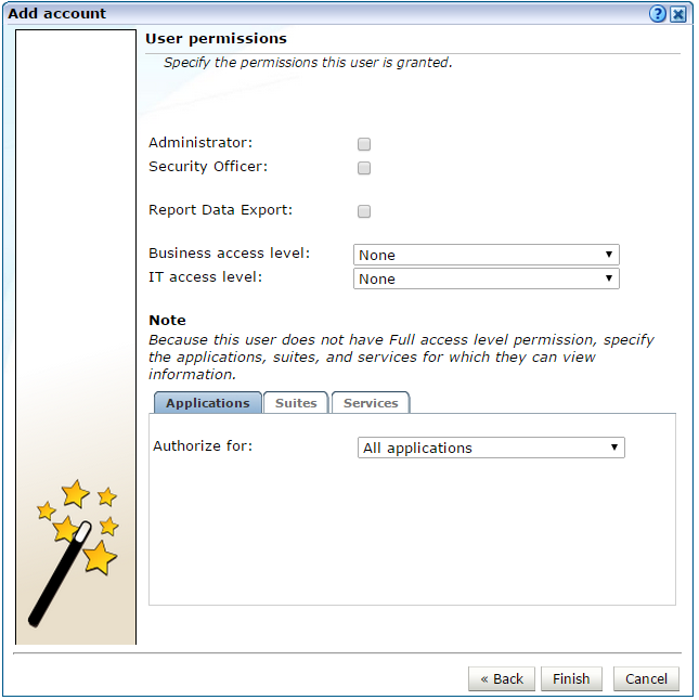

If you are adding a User account the dialog shown in Figure 14-5 appears.
Use the check boxes and menus to specify the role and permissions to be assigned to the new user. These are fully described in Section 14.2, "Understanding User Account Roles and Permissions". If the new user is assigned less than Full access level permission, you must use the Authorize for menu to specify the specific applications, suites, and services about which the user is authorized to view information.

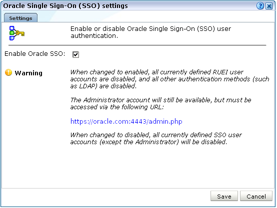

Note that when modifying an SSO user's account, and SSO authentication is disabled, the account is automatically converted to a locally authenticated account. Therefore, it becomes mandatory to specify and confirm a password for the user.

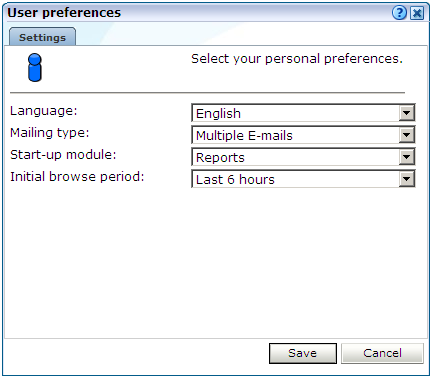

Table 14-6 User Preference Settings
| Setting | Description |
Language |
This is the language in which system messages and prompts appear. Currently, only English is available. |
Mailing type |
Specifies whether the reports the user receives are sent in multiple E-mails (one for each report) or bundled into a single E-mail. The default is multiple E-mails. |
Startup module |
Specifies the module in which the user starts their session. (For example, Reports, System, or User management). The default is the dashboard (described in Chapter 5, "Working With Dashboards"). |
Initial browse period |
Specifies the initial period selection when entering the Data Browser or reports facility. The default is the last 6-hour period. |
When ready, click Next. A dialog similar to the one shown in Figure 14-5 appears.
Optionally, use the check boxes and menus to specify the roles and permissions to be assigned to the user. These are explained in Section 14.2, "Understanding User Account Roles and Permissions". If the new user is not assigned Full access level permission, you should use the Authorize for menu to specify the specific applications, suites, and services they are authorized to view. When ready, click Finish for the changes you have made to take effect.

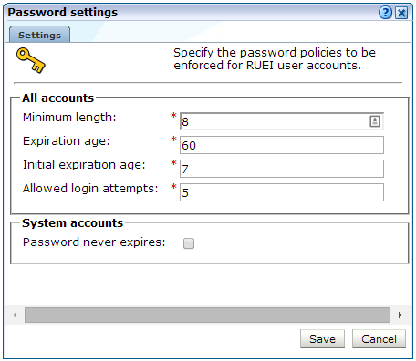

To control your installation's password enforcement, do the following:
Select System, then User management, and click Password settings. The dialog shown in Figure 14-10 appears.
Specify the information shown in Table 14-7.
Table 14-7 Password Settings for All Accounts
| Field | Description |
Minimum length |
Specifies the minimum number of characters that user passwords must contain. This must be between 8 -255 characters, and the default is 8 characters. |
Expiration age |
Specifies how often users are required to change their passwords. The default is 60 days. If set to 0, passwords will never expire. The maximum expiration period is 999 days. |
Initial expiration age |
Specifies the number of days after the creation of a new user account within which the initial password must be changed. This must be 1 - 30 days. It also specifies within how many days a user must change their password after it has been reset by an Administrator. The default is 7 days. |
Allowed login attempts |
Specifies the number of failed logon attempts after which a user account is locked. This must be between 1 - 10 times. The default is 5 times. |
To specify that system account passwords should not expire, enable the Password never expires option. When ready, click Save.
When creating and authorizing users, the following rules are automatically enforced:
User accounts are locked after a specified number of failed attempts. The account must be unlocked before the user can logon again (described in Section 14.5, "Modifying a User's Settings"). However, locked users will continue to receive mailed reports and alerts.
If a password's expiration period is set to 0, and later re-set to a non-zero value (or vice versa), all existing user accounts will adapt to the newly specified password expiration period.
A user password must have a minimum of eight characters. It must contain at least one non-alphanumeric character (such as $, @, &, and !).
A password cannot include the defined user name, or their first or last name. In addition, the user's last three passwords are also remembered, and cannot be re-used.
Passwords are case sensitive.

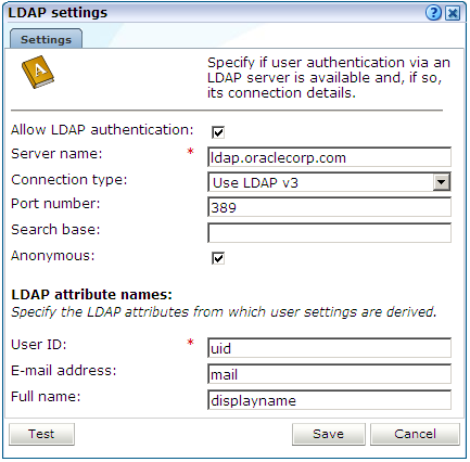

Configuring the LDAP Server Connection
To enable LDAP server authentication, do the following:
Select System, then User management, and then click Configure LDAP connection. Note that if an LDAP server connection has already been configured, the option is indicated as Modify LDAP connection. The dialog shown in Figure 14-11 appears.
Specify the information shown in Table 14-8.
Table 14-8 LDAP Settings Dalog Fields
Allow LDAP authentication |
Specifies whether an LDAP server is available for user authentication. The default is unchecked (disabled). |
Server name |
Specifies the host name or IP address of the LDAP server to be used. Note that protocol information (such as LDAP://) should be omitted from the server name. |
Connection type |
Specifies the LDAP version and connection method. The default is V2 (non-secure). |
Port number |
Specifies the port to which the LDAP server is listening. If necessary, discuss this with your System Administrator. The default port is 389 or 636 (for SSL encryption). |
Search base |
Specifies the location in the directory structure within which the user ID needs to be unique. This must be a valid DN. For performance reasons, this should be as specific as possible. The default is the root of the directory tree. |
Anonymous |
Specifies if the LDAP server lookup should be performed using an anonymous user. If unchecked, then a valid Distinguished Name (DN) must be specified, and the password for that user is requested when a new user is created. The default is to use an anonymous lookup. |
User ID, Email address, Full name |
Specifies the attributes that should be used to extract user settings from the LDAP server. The defaults are based on standard LDAP functionality. If necessary, you should discuss these attributes with your LDAP administrator. |

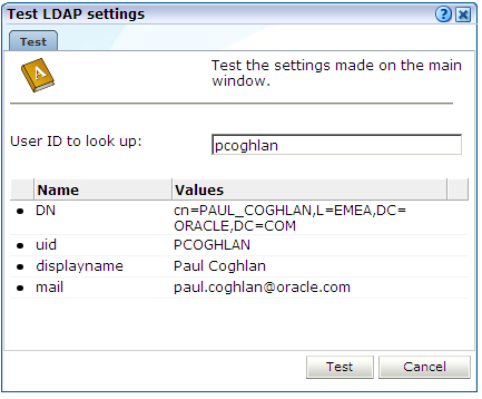

Optionally, you can click Test to verify whether a working connection to the LDAP server can be made. This is discussed in the following section. When ready, click Save.
Any changes you specify to the LDAP configuration settings take effect immediately.
As mentioned earlier, you can test the connection to the LDAP server. Do the following:
Within Figure 14-11, click Test. The dialog shown in Figure 14-12 appears.
Use the User ID to look up field to specify the user ID for which the LDAP server should search. This should be a valid user ID. When ready, click Test. Upon successfully finding the specified user's entry in the directory, their retrieved details are displayed. When ready, click Cancel. You are returned to the dialog shown in Figure 14-11.

To activate the SSO server, do the following:
Select System, then User management, and then click Configure SSO connection. Note that if an Oracle SSO server connection has already been activated, the option is indicated as Modify SSO connection. A dialog similar to the one shown in Figure 14-13 appears.
Figure 14-13 Oracle Single Sign-On (SSO) Settings Dialog
Use the Enable/Disable Oracle SSO check box to specify whether an SSO server is available for user authentication. The default is unchecked (disabled). When ready, click Save.
After enabling or disabling the Oracle SSO server, it is recommended that you logout and logon again to RUEI. This is to ensure that your RUEI installation reflects the change you have made.
