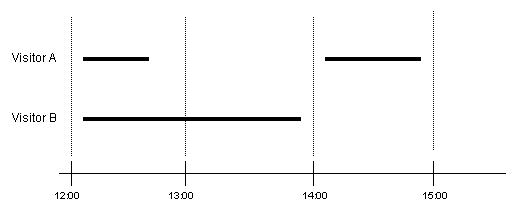

Consider the situation shown in Figure 3-4. Two visitors, A and B, both start browsing at 12:05. A's session ends at 12:45, while B's session ends at 13:55. Visitor A returns at 14:05, and leaves at 14:55.
On a hourly level, the number of concurrent visitor sessions is reported as shown in Table 3-2.
Table 3-2 Hour-Level Reporting
| Hour | Sessions |
12:00 |
2 (during 12-13 there two unique visitors seen). |
13:00 |
1 (during 13-14 there was one unique visitor seen). |
14:00 |
1 (during 14-15 there was one unique visitor seen). |
On a daily level, two concurrent sessions would be reported. However, when viewed on the monthly or two-day level, the number of sessions is reported. In this case, because of the elapsed idle time between A's two sessions, that is reported as three. In order to prevent differences between the number of reported sessions, you should ensure that the specified session idle time matches that of the monitored application.

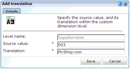

Translations for Custom Dimensions
Optionally, you can also define a set of translations for each unique source value reported for the dimension level. For example, you could define the service-based custom dimension "server ID" with the associated translations shown in Table 3-11:
Table 3-11 Example Custom Dimension Translations
| Value | Translation |
178349 |
Business Partnerships |
561808 |
Newsletter and Events |
405969 |
Catalog |
969533 |
Payment Handling |

Optionally, you can also define a set of translations for each unique source value reported for the dimension level. To do so, click Add new translations. The dialog shown in Figure 3-29 appears.
Specify the required source value and its translation. When ready, click Save.
Note that if the list of imported translations is very large, you can use the controls in the toolbar at the bottom of Figure 3-27 to scroll through the displayed list. In addition, you can use the search facility to locate a required translation. The search string can be specified in terms of either a source value or a translation. The use of wildcard characters (such as *) is not supported, and all characters are treated as literals.
