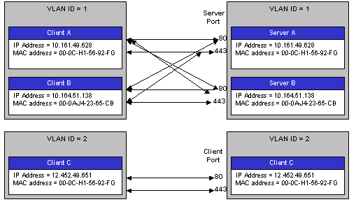

The TCP traffic can be analyzed across client and server IP and MAC address, as well as port number and VLAN ID. Each snapshot's scope in terms of network traffic information is shown in Figure F-1.

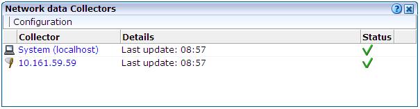

Within the Configuration facility, click the Show Collector status icon. Alternatively, select System, then Status, and then Collector status. The Network data Collectors window shown in Figure F-2 opens. This is fully explained in the Oracle Real User Experience Insight User's Guide.
Click the required Collector. The System (localhost) item refers to the Collector instance running on the Reporter system. Other Collectors within the network are represented by their IP address.
