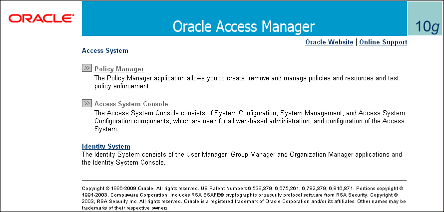

  1. Direct your web browser to The Oracle Access Manager server interface. If you are unsure of the required URL, you should contact the OAM system administrator. The page shown in Figure 7-1 appears.
    Figure 7-1 OAM Server Interface
    Description of Figure 7-1 follows
    Description of ''Figure 7-1 OAM Server Interface''

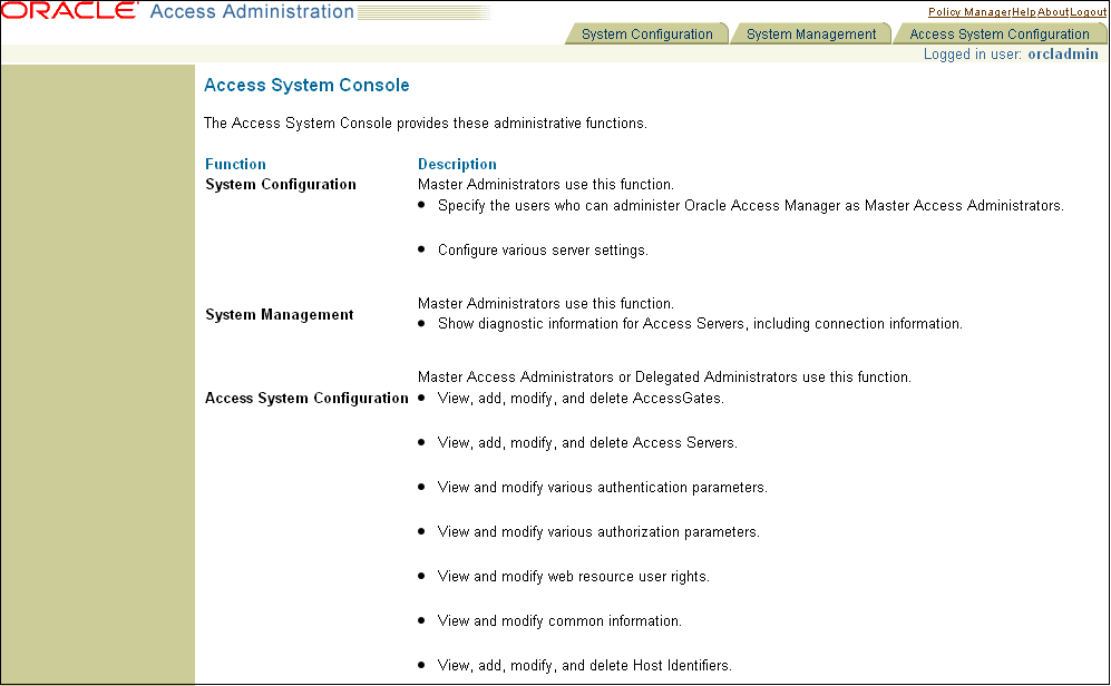

  2. Click the Access System Console link. The page shown in Figure 7-2 appears.
    Figure 7-2 OAM Access Administration
    Description of Figure 7-2 follows
    Description of ''Figure 7-2 OAM Access Administration''

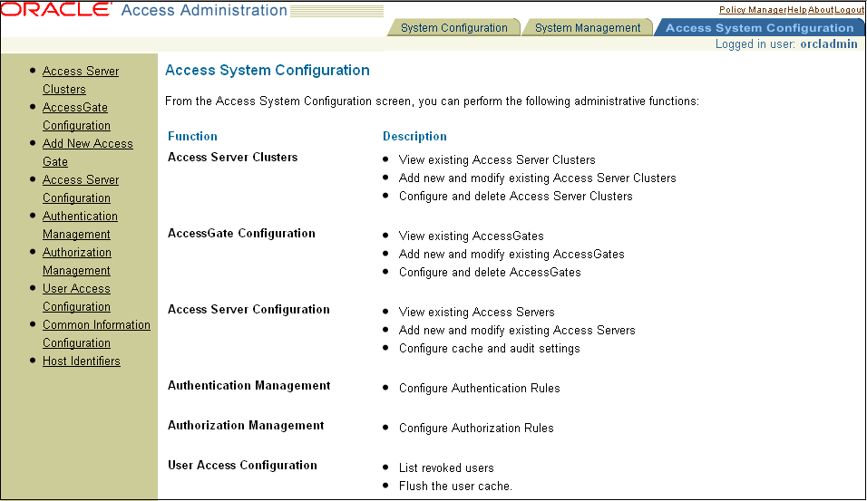

  3. Click the Access System Configuration tab. The page shown in Figure 7-3 appears.
    Figure 7-3 OAM Access System Configuration Page
    Description of Figure 7-3 follows
    Description of ''Figure 7-3 OAM Access System Configuration Page''

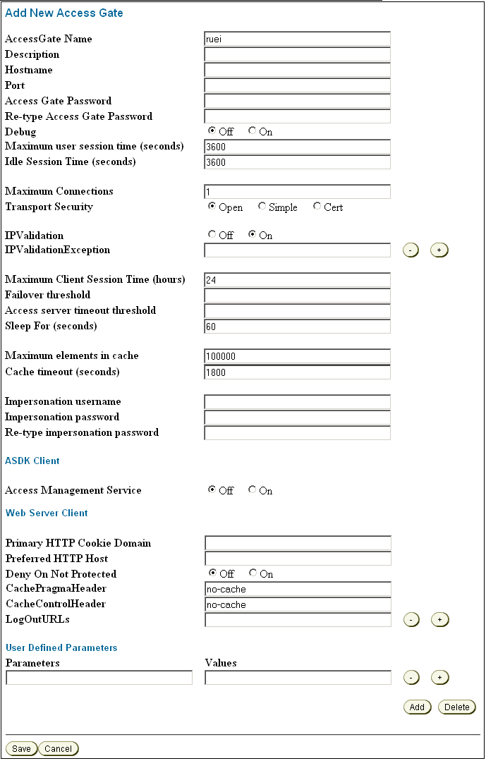

  4. Click the Add New Access Gate option on the left-hand side of the page. The page shown in Figure 7-4 appears.
    Figure 7-4 Add New Access Gate Page
    Description of Figure 7-4 follows
    Description of ''Figure 7-4 Add New Access Gate Page''
  5. Provide the following information:
    • Access Gate Name: specify a unique ID for the new Access Gate. For example, ruei.
    • Hostname: specify the hostname of the RUEI Reporter system.
    • Port: specify the port RUEI should monitor for OAM-based traffic. This should be port 443.
    • Access Gate Password: specify the password that should be used to authorize the RUEI Reporter system to access the OAM server.
    • Re-Type Access Gate Password: confirm the authorization password.
    • Preferred HTTP Host: specify SERVER_NAME.
    Note that the remaining fields can be left blank or with default values specified.
    When ready, click Save.
  6. Click the List Access Servers command button to connect the newly created Access Gate with the required Access Server. Select the required Access Server from the displayed list and, when ready, click Add.
    Note that if no Access Server is listed, Click Add and add the new access gate to the default Access Server.

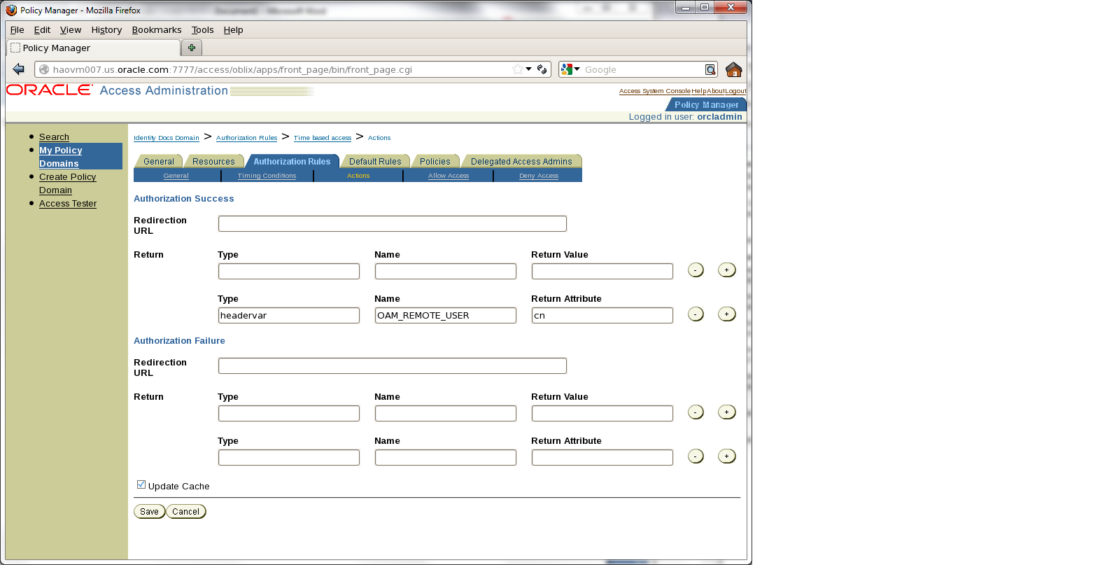

7.1.4.1 Configuring the OAM_REMOTE_USER Header Variable
To configure the OAM_REMOTE_USER header variable, complete the following:
  1. Click the Policy Manager link, as shown at the top of the screen in Figure 7-1, "OAM Server Interface".
  2. From the Authorization Rules tab, click Time based access, then click Actions.
  3. Under ”Authentication Success”, configure the following header variable:
    Type=headervar, Name=OAM_REMOTE_USER, and Return Attribute=cn.
  4. Click Save.
The following shows the Access Administration screen.
Figure 7-5 Access Administration
Description of Figure 7-5 follows
Description of ''Figure 7-5 Access Administration''
