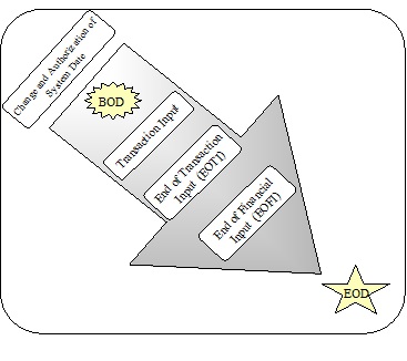

The End of Cycle operations consist of several stages. In this chapter we shall discuss in details the various stages that are a part of the cycle. The various stages in this cycle have been diagrammatically represented below:

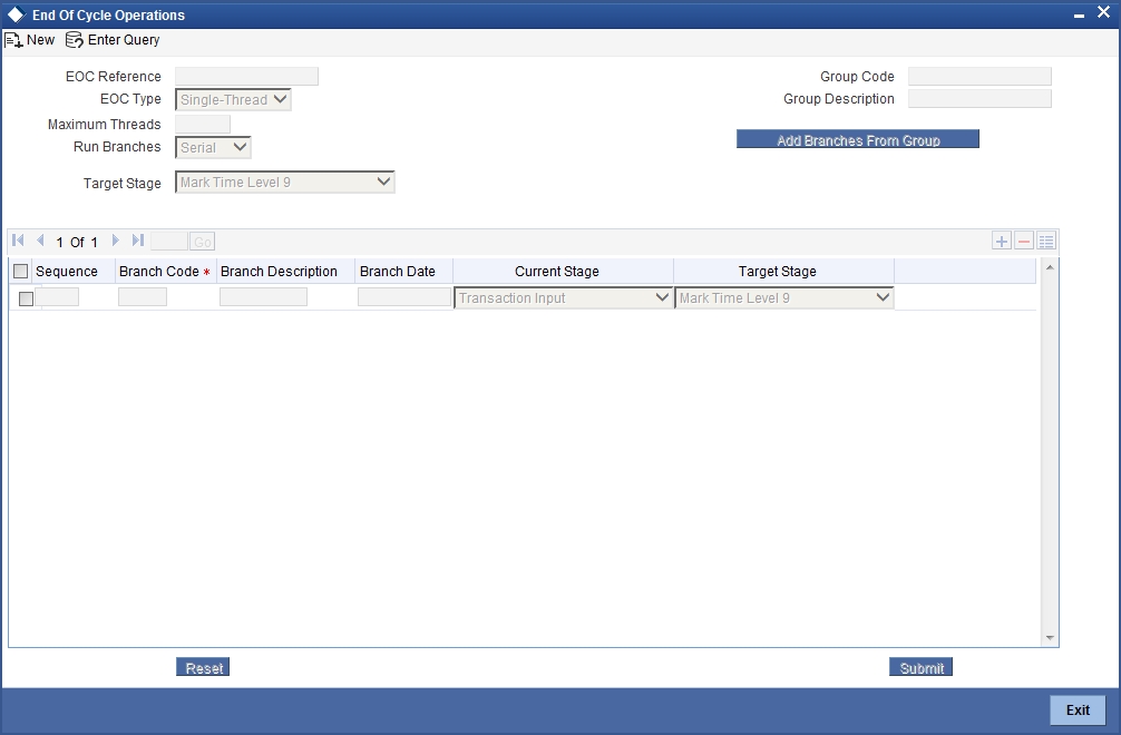

You can invoke the ‘End of Cycle Operations’ screen by typing ‘AEDSTART’ in the field at the top right corner of the Application tool bar and clicking the adjoining arrow button.
In order to initiate EOC operations, specify the following details:
EOC Reference
On clicking ‘Submit’ button, the system generates a unique EOC reference number.
Target Stage
As part of EOC operations, the system will process each selected branch from its current stage to the target stage. Select the target stage for all the branches from the adjoining drop-down list. This list displays the following stages:
You can select the appropriate one. The system defaults this as the target stage for all branches. However, you can modify the same for each branch.
In End of Cycle Operation, if EOC group code with End of Previous Day is selected, then the system validates the following on SUBMIT action:
The EOC Group for EOPD starts after EOD Cycle. EOPD group continues to run Mark End of Previous Day (MARK EOPD) and Post End of Previous Day Stages (POSTEOPD_1, POSTEOPD_2, POSTEOPD_3). This EOPD Group can be optional. The system supports if you prefer to run normal group. Normal Group runs from Mark End Of Transaction Input to Post End of Previous Day 3 (POSTEOPD_3).
Run Mode
Indicate the mode in which the EOC operation should take place. The system allows you to select any one of the following run modes:
EOC Type
Select a valid EOC operation type you need from the adjoining drop-down list. This list displays the following options:
Maximum Threads
Specify maximum number of sessions you need to maintain, if you have selected ‘Multi Thread’ as ‘EOC Type’.
Under EOC Branch Groups, the system displays the list all EOC branch groups that you have maintained. You can select one or more branch groups to proceed with EOC operations. Use the checkbox adjacent to each group to select it. Check against ‘ALL’ to indicate that the EOC has to be run for all the branches together.
Once you have selected the branch groups, click ’Populate’ button. Under EOC Branches, the system displays all branches grouped under the selected branch groups.
Note
The system does not display the branches for which EOC is already running.
You can add more branches to the list of branches displayed. Click add icon to add more rows to the list. Specify a valid branch code to set the target stage. This adjoining option list displays all valid branch codes maintained in the system. However, the option list will not display the branches for which EOC is already running.
To remove a branch from the list, check the box adjacent to the branch code and Click delete icon.
Once you have specified all the details, click ’Submit’ button. The system proceeds with the EOC process in Asynchronous mode after necessary validations.
You can use the ’Reset’ button to clear the list of branches. Further, you need to select the branch groups and individual branches again to proceed with EOC operation.

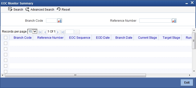

In Oracle FLEXCUBE, you can verify the status of EOC that you have submitted. The EOC Monitor screen displays the status of EOC process across branches. You can invoke the ‘EOC Monitor’ screen by typing ‘AESBRMTR’ in the field at the top right corner of the Application tool bar and clicking the adjoining arrow button.
The screen is as shown below:
Branch Code
You can filter your search by branch code. Select the branch code from the option list to view the status of the EOC processes for that branch.
EOC Reference Number
You can filter your search by the reference number of the EOC operation. Select the reference number from the option list to view the status of the EOC processes.
You will notice four buttons arrayed on the screen. The functions that each of these buttons performs are detailed below:
Search
For the specified criteria, on clicking ‘Search’ button, the system fetches the records.
Reset
Use this button to reset the search criteria.
Advanced Search
You can perform an advanced search defining more filter criteria.
Go to Page
Based on the number of records displayed per page, the system will fetch them on multiple pages. Enter the page number and use this button to navigate to that page.
On this screen, you can search for the EOC processes that are currently running. Specify the branch code or the EOC Reference number and click ’Search’ button. Based on the filters that you have set, the system displays the details of the EOC processes.
You can drill down to view the detailed information on a specific EOC process. Double click on the required row to view the details.

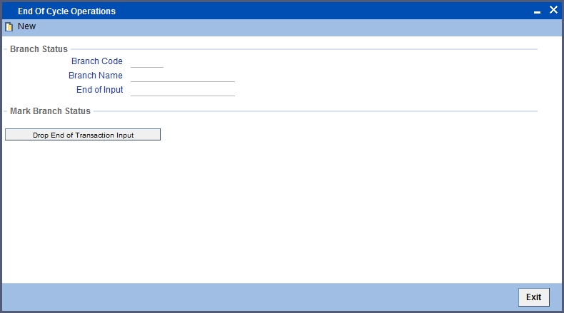

You may stop a running AEOD batch within the current branch using ‘End of Cycle Operations’ screen. You can invoke the ‘End of Cycle Operations’ screen by typing ‘EIDUEOTI’ in the field at the top right corner of the Application tool bar and clicking the adjoining arrow button.
The system displays the following details on this screen:
You can stop an AEOD process by clicking ’Drop End of Txn Input’ button on the screen. The system seeks a confirmation for going ahead with dropping. Once you confirm it, the system updates the status of the process as ‘End of Transaction Input’.

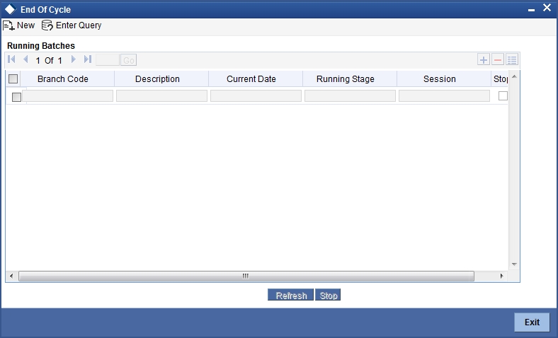

You can stop running EOC processes for specific branches using ‘End of Cycle’ screen. You can invoke the ‘End of Cycle’ screen by typing ‘AEDSTOP’ in the field at the top right corner of the Application tool bar and clicking the adjoining arrow button.
The system displays the running branches on this screen. Check the box under ‘Stop’, against the branches for which you wish to stop the process. Click ‘Stop’ button to stop the process for the selected branches.

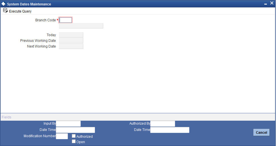

You can view details of the system date in the system dates table. You can invoke the ‘System Dates Maintenance’ screen by typing ‘STDDATES’ in the field at the top right corner of the Application tool bar and clicking the adjoining arrow button.
The default date will be displayed in the screen. For instance, on the first working date 1st of January, 1998; the system dates will be updated to read as follows:
Today s date = 01 January 1998
Previous working date = 31 December 1997
Next working date = 02 January 1998
Today’s date is defaulted from Next working date of the old record. Previous working date is defaulted from today’s date of the old record. The Next working date is picked up from the Local branch holiday calendar as maintained for your branch.
The only time you add a record in the system dates table is when Oracle FLEXCUBE is first installed in your branch. Subsequently, the dates will be updated by EOD operations.Click ‘Exit’ button to exit the screen. You will be returned to the Application Browser.
