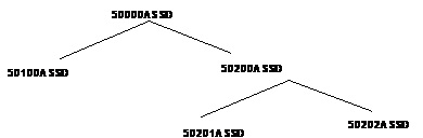

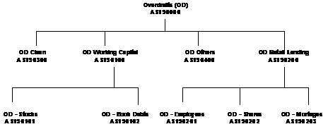

The GLs at the lowermost level are referred to as Leaf GLs. The balances and turnovers of leaf GLs are consolidated at higher level GLs called Node GLs. The GL at the top of the structure is referred to as the Head GL.

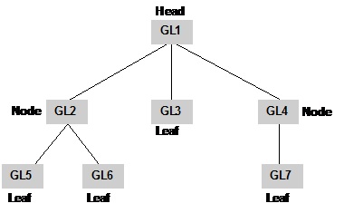

In the GL reporting hierarchy, a GL is a parent GL for GLs reporting to it. For instance, GL2 is the parent of GL 5 and 6, and GL1 is the parent GL for GLs 2, 3, and 4. The reporting GLs, GLs 5 and 6 in the first instance, are referred to as child GLs of GL 2. Similarly, GLs 2, 3, and 4 are child GLs with respect to GL1.
This multilevel GL structure can be maintained in the Chart of Accounts screen by the branch marked as the Head Office of your bank.

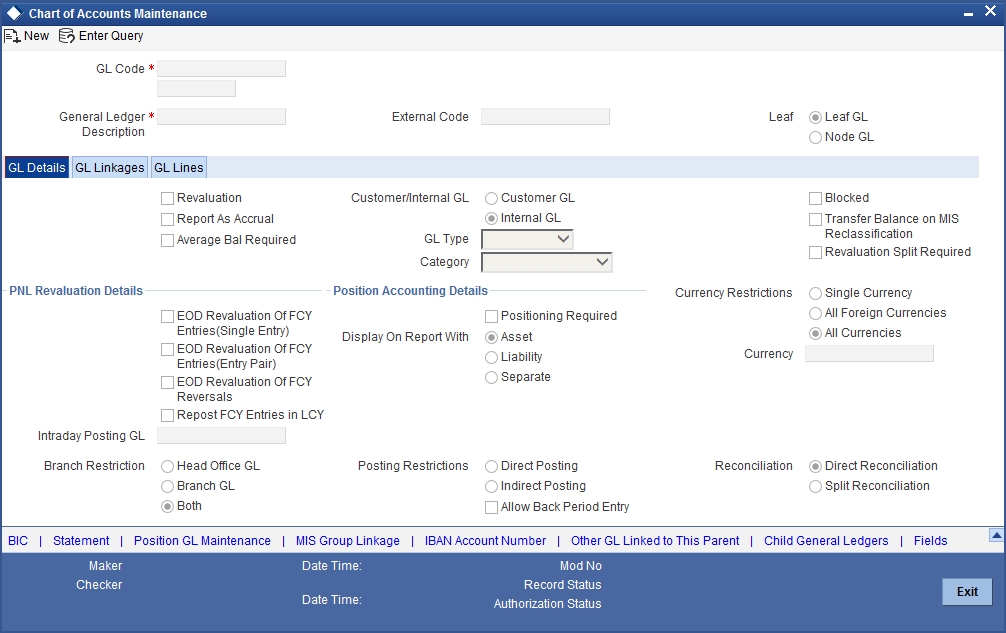

You can invoke the ‘Chart of Accounts Maintenance’ screen by typing ‘GLDCHACC’ in the field at the top right corner of the Application tool bar and clicking the adjoining arrow button.

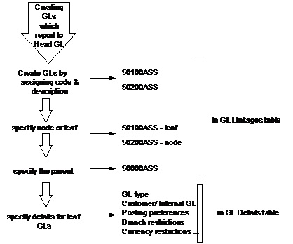

To define the details of a new GL, click new icon.
GL Code
In Oracle FLEXCUBE, a GL is identified by a Code. The length and composition of the code depends upon the GL Mask defined in the ‘Bank-wide Parameters’ Screen. The code that you enter can have a maximum of nine alphanumeric characters.
External Code
Using External Code, you can upload the existing record into Oracle FLEXCUBE, when the record is loaded for the first time. The old GL code will be defaulted as external code and you can enter new code and save it as well. External Code has to do nothing while entering new GL entries after installation of Oracle FLEXCUBE.
Description
You can enter a brief description to help identify the GL in this field. You can use this description for the internal reference of your bank.

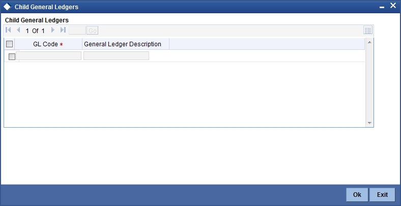

Leaf GL
In Oracle FLEXCUBE, a GL that you create can be one of the following:
A Node GL is one that reports to another GL and has other GLs reporting to it. In the reporting relationship, if a GL reports to another GL, but no GLs report to it, then it is a Leaf GL. A Head GL is a Node that does not report to another GL.
The Chart of Accounts detailed screen is designed with four tabs. By invoking the screens that correspond with these tabs you can create GLs and maintain a GL structure of your bank.
To define details for a GL, click on the tab titled GL Details. The details that you can specify for a GL depend on the type of GL that you create. If a particular field is disabled, it means that the field is not relevant to the type of GL that you are creating.
You can capture the GL Details in the following fields:

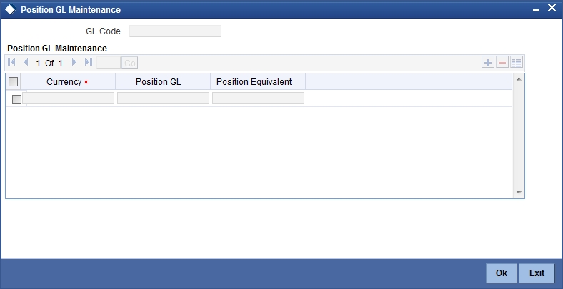

Positioning Required
You can retrieve the position of a foreign currency, any time, by opting for Position Accounting in your bank. When you opt for position accounting, you maintain a Position GL and a Position Equivalent GL for every foreign currency maintained in your bank. The Position GL reflects the current position in the currency. You can opt for position accounting while indicating your preferences in the Bank-Wide Parameters screen.
If you opt for position accounting while defining Bank-Wide Parameters, you can maintain Position GLs and Position Equivalent GLs for every foreign currency that your bank deals in. When maintaining the GLs in your bank, you can opt to link the different currencies, associated with the GL, to:
In the GL Category field, indicate if you are maintaining a Position GL or a Position Equivalent GL.
The position accounting happens event and entry pair-wise. Each entry is considered. If any currency mismatch is found then position accounting for each posting pairs are considered for position accounting.
Example
You have initiated an FT transaction where account is denominated in USD but the transfer amount is EUR. Charge is calculated in USD. In this case, the system will pass position entries for transfer amount as well as charge amount.
If transfer happens in USD from an USD account while charge is settled in EUR from an EUR account number position entry will be posted as no currency mismatch exists.

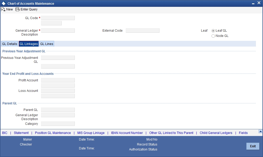

Click the tab titled GL Linkages from the Chart of Accounts screen to define linkages for the GL that you are defining.
In the GL Linkages screen you maintain the following:

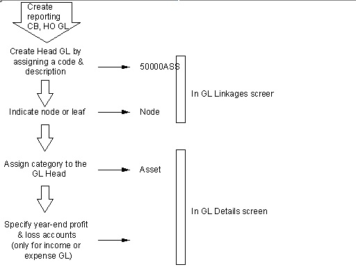

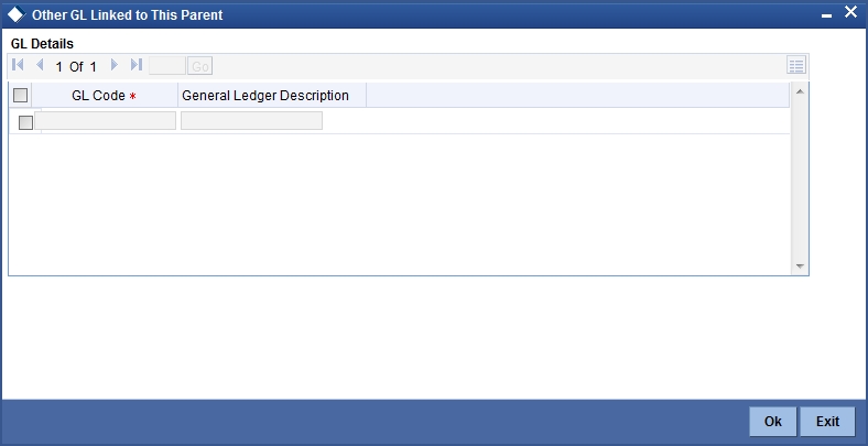

Parent GL
You can indicate the GL to which the current GL should report. This GL in effect becomes the parent of the current GL. You can select a parent GL from the option list available. The option list will contain only a list of Node GLs that you have already created.
Category
You can assign a Category only to a Head GL (a GL that does not report to another GL). If the GL that you indicated as the parent GL, is a Head GL the category assigned to it is also displayed.
Profit A/C
You can specify the accounts into which the year-end profit or loss entries for the GL should be posted.
The profit account is the account into which all income GL account balances are posted at the end of the year. On the last day of the financial cycle all balances from the account are posted into the year-end profit account. You can select an account code from the option list available.
Loss A/C
The Loss account is the account into which all expense GL account balances are posted at the end of the year. On the last day of the financial cycle, all balances from the loss accounts are posted into the year-end loss account.
You can specify the same GL for posting both your profits and losses.
Prev Yr Adj GL
You can indicate the GL to which the previous year’s adjustment entries for unrealized income and expense are to be posted. As a result the system automatically posts adjustment entries between Unrealised Income/Expense GL and an Adjustment GL for the interest/commission accrued in the Previous year, as these would already have moved to the year-end P and L GL during financial closure.

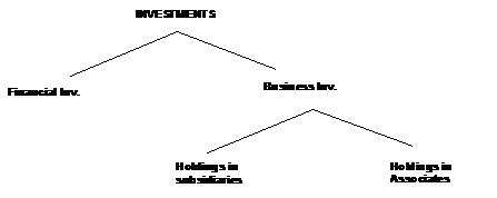

Assume you need to create a reporting line for your Head Office, representing investments of your bank. Under the head Investments, your Head Office wants information classified under financial investments and business investments.
Further, under business investments, you require to report holdings in subsidiaries and holdings in associates.
Solution
To create this new reporting structure, invoke the Reporting Lines Maintenance screen. First create the Head Reporting Line. In our example, it is Investments and assign it a description and a category - asset. Leave the parent details blank, since this does not report to another line.
Then create the lines at the second level, Financial investments, and Business investments. Indicate Investments as the Parent line for both these lines.
Thereafter, create the third level of GLs holdings in subsidiaries and holdings in associates respectively. Specify their parent line as Business investments. The category assigned to the Parent Line is defaulted.
The hierarchical structure of this Head Office reporting line would be as follows:

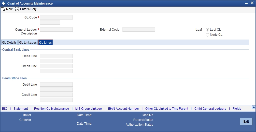

After you have defined Central Bank and Head Office lines, you can indicate the leaf GLs that should report to the line. While creating a GL, you can indicate the Central Bank or Head Office line to which it should report.
Click on the ‘Reporting Lines’ tab on the ‘Chart of Accounts Maintenance’ screen to indicate the reporting lines to which leaf GLs should report. A GL that you create can report to Central Bank and Head Office reporting lines.
For Central Bank reporting purposes, you should associate a GL with a debit and credit reporting line.
Debit Line
The Central Bank debit line indicates the line to which an account under a GL should report, if in debit.
Credit Line
Similarly, you can indicate the line to which an account under a GL should report, if in credit.
You can select a reporting line from the option list. The option list will contain a list of all the lines maintained in the Reporting Line Maintenance screen. The description of each specified reporting line appears alongside the line number. The debit and credit reporting lines you define for a leaf can be the same.
In order to include a GL under a Head Office reporting line, you should associate it with debit and credit reporting line.
Debit Line
The Head Office debit line indicates the line to which an account under a GL should report, if in debit.
Credit Line
You can select a reporting line from the option list. The option list will contain a list of all the lines maintained in the Reporting Line Maintenance screen. The description of each specified reporting line appears alongside the line number. The debit and credit reporting lines you define for a leaf can be the same. After you have made the required entries save the entries.
Click ‘Other GL Linked to this Parent’ button from the ‘Chart of Accounts’ screen to view the hierarchical position of any GL.
You can view the structural hierarchy of a GL based on two criteria:
For example, let us assume that your GL Head of Overdrafts is structured as follows:
Suppose AS190100 is on display in the field GL Code. On choosing the other GLs linked to this parent option, the following list will be displayed:
| GL Code | GL Description | ||
| AS190200 | OD Retail Lending | ||
| AS190300 | OD Clean | ||
| AS190400 | OD Others |
If you click on Child GLs for the Current GL the following list will be displayed:
| AS190101 | OD Stocks | ||
| AS190102 | OD Book Debts |
Thus by clicking on the second option under hierarchy level, you can view the list of GLs that report to the current GL.
To understand the sequence of steps involved in creating a new GL structure, let us take an example:
For example, assume you are creating an asset Head GL for bank balances held with other banks.
Your GL mask is defined as NNNNNAAAD in the Bank-wide Parameters screen. You assign a GL code 50000ASS D to the Head GL. D is the last element of the code, which is system generated and is called the check digit. It will be an alphabet of the English language if it is represented in the mask as d and will be numeric if it is represented as D.
Under GL 50000ASS, you want to create two sub-GLs - 50100ASS representing balances with Federal Reserve Bank and 50200ASS representing balances with Commercial banks.
Under sub-GL 50200ASS stand two GLs -- 50201ASS and 50202ASS representing balances with commercial banks in local currency and foreign currency respectively.
The hierarchical structure of this GL tree is as follows:
To create this new GL structure, invoke the 'Chart of Accounts' screen, the 'GL Linkages' screen is displayed. Click new icon. A new screen with no prior inputs will be invoked.
You can click on any of the four broad heads listed atop the screen to activate that screen. Follow the given sequence of steps:
Step 1:
Step 2:
Step 3:
and so on...

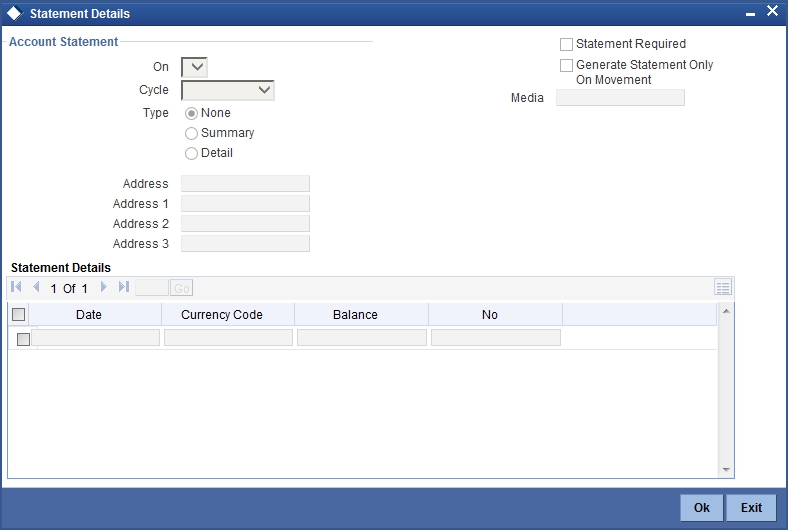

For each new GL that you define in the Chart of Accounts, you may need to generate a periodic statement of accounts for transactions involving the GL.
You can indicate whether a periodic statement of accounts needs to be generated for transactions involving the GL through the Statement Details sub-screen in the GL Chart of Accounts screen.
To specify the statement related details click on the ‘Statement’ button in the Chart of Accounts screen. The ‘Statements Detail’ screen will be displayed.
Indicate that an account statement is to be generated periodically by the system for the particular account by specifying the format in which the statement is to be generated.
The options available are:
Note
If you do not want a periodic statement of transactions involving the account, you can specify so by selecting the None option.
Cycle
Select the frequency at which the account statement should be generated from the adjoining drop-down list. This list displays the following values:
On
Select the start date and month for the generation of the statement based on the frequency that you specify from the adjoining drop-down list. For a weekly generation of the account statement, specify the day of the week on which account statements should be generated.
For a monthly generation of statement you can specify the day of month. To specify the day of the month for the monthly generation of statements enter a number between 1 and 31 (corresponding to the system date).
If you set the statement date to 30, then account statements will be generated on:
If you set the statement date to the 31st of the month, account statements will be generated on:
Note
For all other cycles, the account statement will be generated on the last day of that cycle. Based on the preferences that you specify, the system generates a statement of accounts automatically, as part of the end of cycle processing.
Generate
Choose to generate the statement of accounts only when there has been a movement of funds into the account or when funds have been transferred out of the account.
For instance, let us assume that on the 21st of August 2001, you have set the account statement generation frequency as Daily for the account LI0202308. On the 5th of September 2001, there has been no movement of funds in the particular account. If you have opted for the Generate Only on Movement option the system will not generate a statement message for 5th Sept 2001.
You can also choose to generate the statement of accounts regardless of whether or not there has been a movement of funds to and from the account.
Statement Required
There may be times when you would have maintained the relevant account statement details for a particular GL. However, you would like to generate the account statements only a month or two later. You can choose to stall the generation of account statement for a temporary period of time by keeping the statement required check box unchecked.
To enable the generation of account statements you can unlock the contract and uncheck this box to re-start the generation of messages.

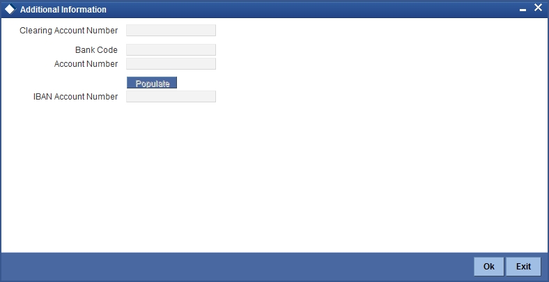

For an internal Leaf GL you can maintain the Clearing Account number to be used for outgoing payments where the internal GL is the remitter account. Click ‘IBAN Account Number’ button in the ‘Chart of Accounts’ screen.
The ‘Additional Information’ screen is displayed.
In this screen, you can specify the Clearing Account Number for the GLand the Bank Code of the GL. If a Clearing Account maintained for a GL is found in an uploaded incoming payment the System resolves the actual GL for the payment as per your maintenance in this screen.
Click 'Populate' button to default the IBAN Account Number based on bank code and account number. If the IBAN Number maintained for a GL is found in the incoming payment the System resolves the actual GL as per your maintenance in this screen.
When defining a GL in the Chart of Accounts, you must link all the foreign currencies linked to a GL to a Position GL, and a Position Equivalent GL if you have opted for position accounting in the Bank Wide Parameters screen.
If you do not want position accounting for a particular GL, do not choose the Positioning required option under Position Accounting Details in the Chart of Accounts. Click ‘Position GL Maintenance’ button in the ‘Chart of Accounts’ screen. The ‘Position GL Maintenance’ screen is displayed.
In this screen, you can:
You can choose to retain the Position GL that defaults (according to your specifications in the Currency Maintenance screen), or indicate a Position GL of your choice.
Note
You should maintain Position GLs before you can identify one for a GL that you are maintaining.

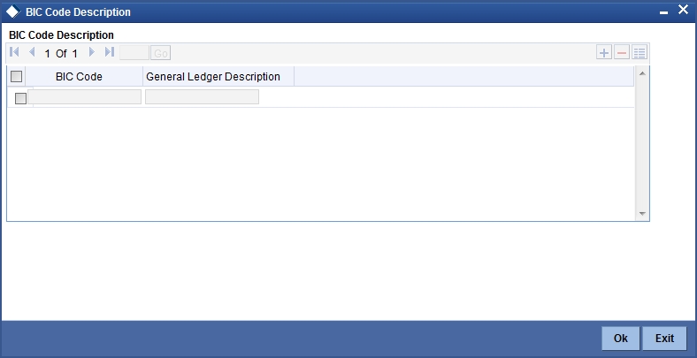

For a leaf GL, you can link the SWIFT BICs representing the sender entities that are authorized to specify the GL account as the debit account for a funds transfer transaction.
While uploading an incoming SWIFT payment message, and deriving the debit and credit accounts, the Oracle FLEXCUBE Straight Through Processing (STP) process checks whether the given Sender SWIFT BIC is authorized to specify a the Leaf GL as the Debit Account for incoming SWIFT payment messages.
To specify the Sender SWIFT BIC information for a leaf GL, click ‘BIC’ button in the ‘Chart of Accounts’ screen. The WIN BIC screen is opened, where you can specify the SWIFT BICs of the Sender entities that are authorized to specify the leaf GL as the Debit Account as the Debit Account for incoming SWIFT payment messages.
For details about how Oracle FLEXCUBE processes incoming SWIFT payment message transactions and for details about the STP process, consult the Funds Transfer user manual.
