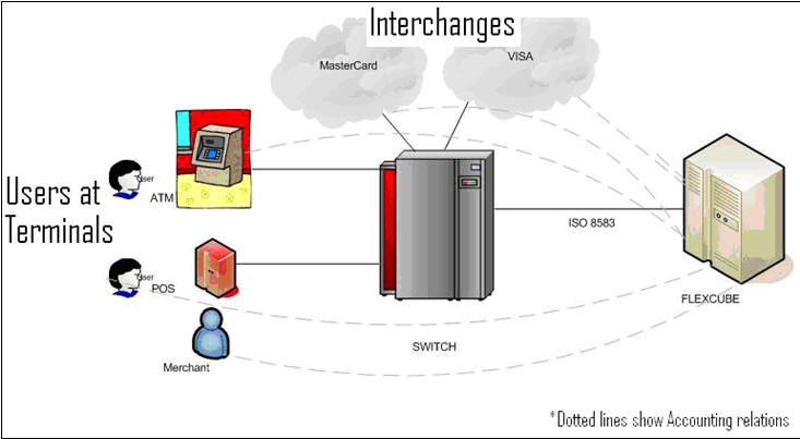

The following is a brief account of the Switch software domain and the components in a Cards Transactions Business network.
The following diagram illustrates the components in the switch network.
ATMs and POS Terminals are connected with the Switch Software system using proprietary message protocol depending on the upon the terminal device type. Switch software is also connected with ‘Interchanges’ like VISA and MasterCard.
A switch software system provides the following functionalities:
ISO8583 protocol is called the ‘Financial Transaction Standard for Card originated messages and Interchange message specifications’. This protocol provides for the exchange of information between an ‘Acquirer’ and an ‘Issuer’ for card transactions. The terms ‘Acquirer’ and ‘Issuer’ are explained below.
