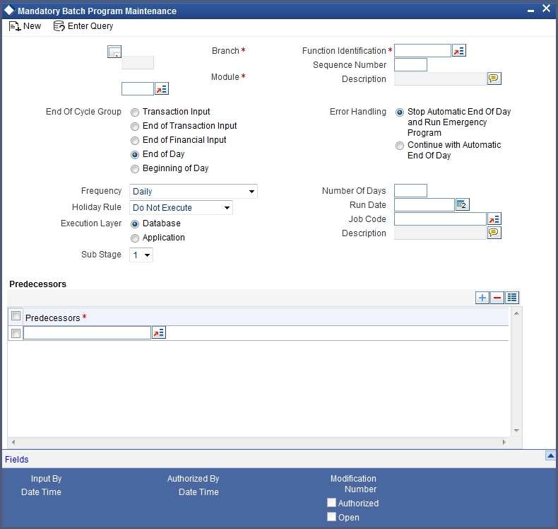

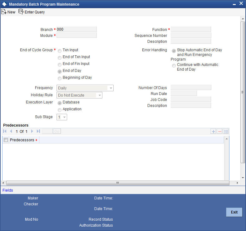

You are required to maintain the following sequence for ILM batches that need to be run, for any branch which is enabled for ILM. You can invoke the ‘Mandatory Batch Program Maintenance’ screen by typing ‘EIDMANPE’ in the field at the top right corner of the Application tool bar and clicking on the adjoining arrow button.

The various mandatory programs are show below:
IIBATCH processes the account structure based on the group code maintained at ‘Islamic Group Codes Maintenance’ level. This batch creates or updates the system accounts based on the account structure maintained for the ILM accounts.
IPEOD batch calculates the profit for the CASA and system accounts for the Mudarabah rate computed by the PDM batch.
Note
IP batch should run only if IIBATCH is successful. Hence, in IPEOD mandatory program, you need to maintain the field predecessor as IIBATCH so that the IP Batch will not run if IIBATCH fails.
