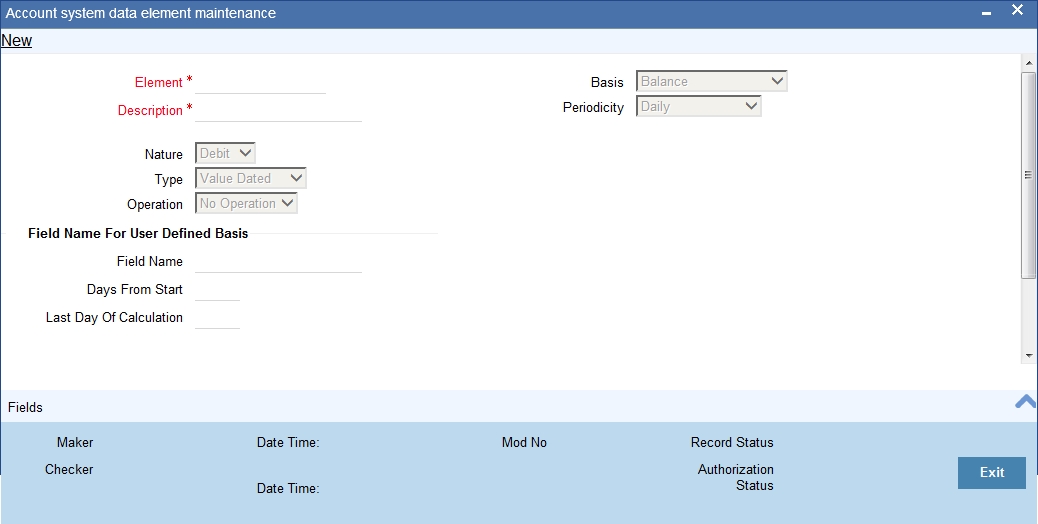

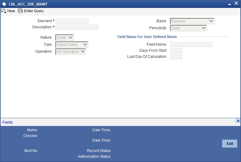

Element
Enter a unique ID for the System Data Element that you are maintaining.
Description
Enter a description of the SDE that you are maintaining in this field.
Nature
Once you fix the ‘basis’ on which you want to apply interest for the SDE that you are defining (either balances or turnovers which, in turn, could be as of the booking date or the value date), you have to specify the nature of the balance or turnover. The nature could be:
In the example discussed in the beginning of this section, we have seen various types of balances: on certain days there is a debit balance while on certain other days there is a credit balance in the account. These are referred to as debit balances and credit balances respectively.
Each balance in turn will have a periodicity and an aggregation operation attached to it. These two are explained subsequently.
Basis
Interest can be applied on this account differently, using different data as the basis. That is, you can apply interest on the basis of ‘item count’, the balance, or the turnover in the account. In Oracle FLEXCUBE, Balances and Turnovers are referred to as ‘Basis’. While balances will typically be used for interest application, turnovers could be considered for charges.

Type
If you have indicated that the system data element is to be calculated on the turnover of an account, you should specify the date to be used for calculation. The calculation date can either be:
Periodicity
The periodicity decides the period over which a balance or a turnover should be considered for interest application. This periodicity could be daily, monthly, quarterly (three months), semi annual (six months), or annual. When a balance or turnover has to be picked up for interest application, it will be picked up for this period.
An example for a balance with daily periodicity could be the daily net balance in the account. Similarly, the monthly minimum credit balance, monthly maximum debit balance, etc. are examples of a balance with monthly periodicity. Similarly, you could consider the minimum credit balance over a quarter for interest application.
Note
This periodicity is for picking up the value of an SDE. It is not the periodicity at which interest is liquidated. The periodicity with which interest is liquidated is called ‘Liquidation Frequency’. Whenever interest has to be liquidated (either according to the liquidation frequency or on an ad-hoc basis, the balance will be picked up based on the SDE periodicity and applied for the entire liquidation period.
The periodicity that you define for an SDE is not the same as the periodicity of rule application (defined for an interest rule). The periodicity of rule application (which could be daily or by periodic) also has a role in the way an SDE is picked up (please refer the chapter ‘Maintaining Rules’ for details).
Operation
An aggregation operation denotes the method in which a balance or turnover should be picked up over its periodicity. As discussed under ‘Periodicity’, for the ‘Minimum’ credit balance that has to be picked up over a month, the ‘Maximum’ debit balance for the month, the ‘Minimum’ and ‘Maximum’ denote an aggregation operation. Another aggregation operation would be the ‘average’. For example, you could have the average monthly debit balance or the average monthly credit balance as the attributes of an SDE.
If you choose to apply interest on the basis of the credit, debit or the net balance, you can specify that the balance to be considered is:
Note
If the periodicity for an SDE is daily and the basis is balance, the balance taken will always be the net balance for the day. It cannot be the minimum, maximum or average balance.
The aggregation operation of ‘sum’ can be used when you want the SDE to return a value that is a sum of a few values. A typical usage of this aggregation operation will be when you want the sum of turnovers (debit or credit), or a sum of debit or credit items, over a period.
Days from Start
You can enter a value in this field if you want to compute interest for an account on the monthly minimum credit balance or the maximum monthly debit balance or the average balance for a specific period.
The balance in the account, between the date that you specify here and the date that you specify in the ‘Last Day of Calculation’ field, will be picked up for the purpose of calculation of interest.
The default value in this field should be specified as ‘1’. However, you can enter any date here. For example, if you want to calculate interest from the 15th of a month enter ‘15’ here.
You may have a requirement wherein you have to consider the balances or turnovers, only during a specific period of the month. For example, in some countries, credit interest for Savings Bank accounts is given for the minimum credit balance in the account during the month, between the 10 and 25 of the month. To define an SDE that returns the minimum balance between 10 and 25 of the month, you should define it as follows:
| Basis | Balance | ||
| Nature | Credit | ||
| Type | Value dated | ||
| Periodicity | Monthly | ||
| Operation | Minimum | ||
| Days from Start | 10 | ||
| Last Day of Calculation | 25 |

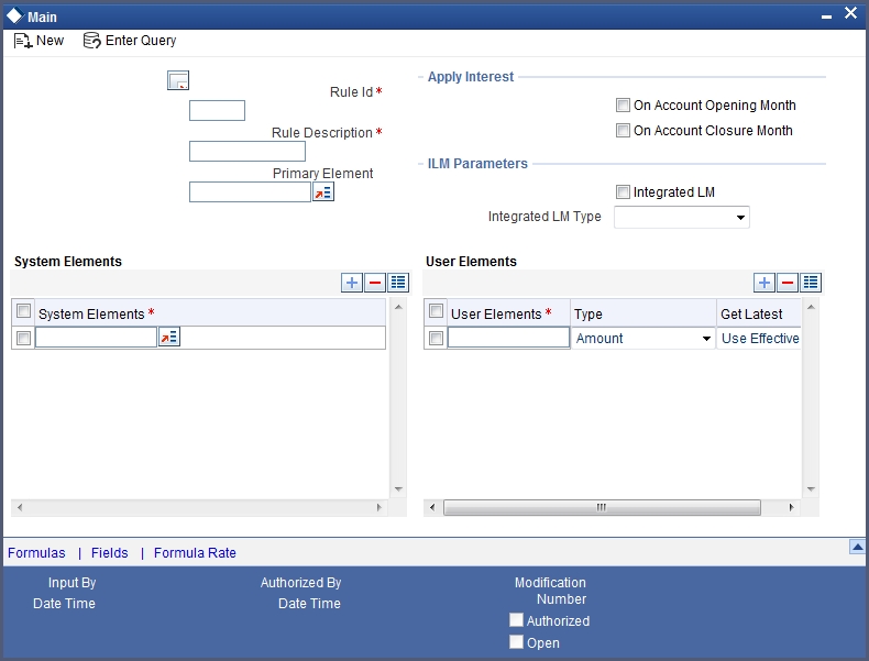

By attaching this ‘DIRT _TEST’ SDE to a rule, building that rule into an interest product and attaching the product to an account class, you can ensure that no DIRT is deducted from the interest on accounts under that account class. You have to specify the parameters for this SDE in line with the parameters that you set for the other SDEs that you use to calculate interest in the same rule.

By attaching these SDEs to a rule, building that rule into an interest product and attaching the product to an account class, you can ensure that these SDEs are used in the formula for computing the TDS amount for accounts under that account class. You have to specify the parameters for these SDEs in line with the parameters that you set for the other SDEs.
Refer to the chapter titled ‘Building Formulae’ of this user manual for more details on creating a formula.

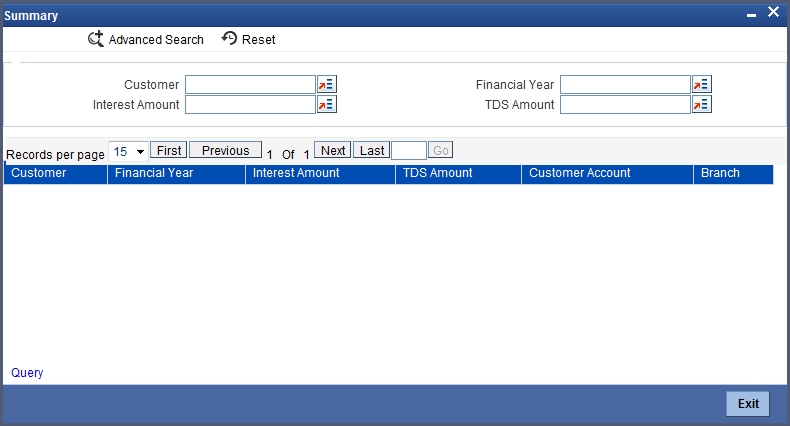

You can view the TDS details of the customer in the ‘Interest & Charges TDS Query’ screen. You can invoke the ‘Interest & Charges TDS Query’ screen by typing ‘TDSQUERY’ in the field at the top right corner of the Application tool bar and clicking the adjoining arrow button.
In the above screen, you can base your queries on any or all of the following parameters and fetch records:
Select any or all of the above parameters for a query and click ‘Search’ button. The records meeting the selected criteria are displayed.
System displays the following details pertaining to the fetched records:
