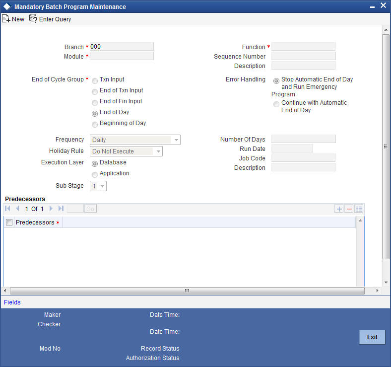

The system triggers the batch processes automatically based on the details maintained in ‘Mandatory Batch Program Maintenance’ screen.
To invoke the ‘Mandatory Batch Program Maintenance’ screen, type ‘EIDMANPE’ in the field at the top right corner of the application tool bar and clicking on the adjoining arrow button.
Specify the following details:
Module
Select the module code ‘RB’ from the adjoining option list.
Function Identification
Specify the function ID of batch that you wish to run. The adjoining option list displays all batch processes available for the module.
You can configure the batch to be run at various stages of day like EOD, EOTI etc.
For further details about this screen, refer the chapter ‘Setting- up Mandatory Programs for EOD’ in the AEOD User Manual.
