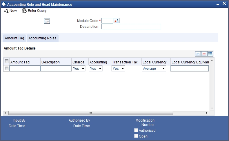

You can define the amount tags for accounting roles through the ‘Accounting Role and Head Maintenance’ screen You can invoke this screen by typing ‘UDDRLTAG’ in the field at the top right corner of the Application tool bar and clicking on the adjoining arrow button.
You can specify the following parameters for the module:
This tab is displayed by default when you invoke the screen.
Amount Tag
Specify the amount tag.
Description
Enter the brief description for amount tag.
Charge
Indicate whether the amount tag pertains to a charge or not by choosing one of the following options:
Accounting
Indicate whether accounting entries are required or not by choosing one of the following options:
Transaction Tax
Indicate whether transaction tax is applicable or not by choosing one of the following options:
Local Currency
Indicate the local currency preference by choosing one of the following options:
Local Currency Eq. Tag
Specify the amount tag for the local currency equivalent amount.

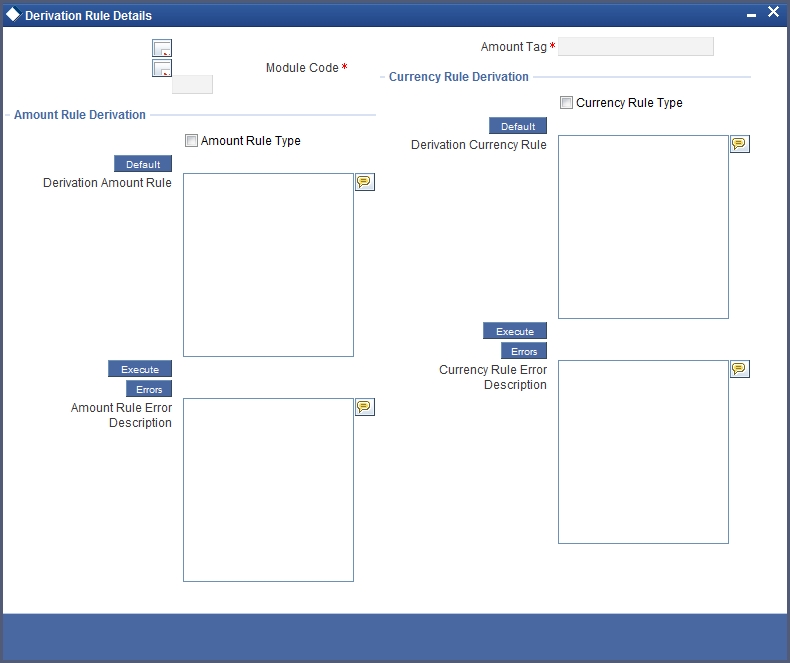

Click ‘Derivation’ button and invoke the ‘Derivation Rule Details’ screen to derive the amount and currency for the amount tag.
Here you can specify derivation logic for the following:
Module Code
The system displays module code here.
Amount Tag
The system displays the amount tag here.
You can specify the following details.
Amount Rule Type
Check this box if the amount has to be derived based on a specified condition. The amount for a particular tag can be derived based on a condition.
Derivation Amount Rule
If you have checked against the option ‘Amount Rule Type’, the system will derive the amount for the amount tag that is being defined. You can use the following as variables while creating the derivation rule:
You can use any of the following SDEs:
Assume that you have an account-level UDF called ‘OSCHGRATE’.
The derivation rule using the SDEs and UDF may be given as under.
DECLARE
l_osprin_amt number;
rate number;
BEGIN
L_osprin_amt:=(@SDE_VAL#PRINCIPAL_OUTSTAND);
rate: =(@UDF_UD#OSCHGRATE);
l_amount:=rate * l_osprin_amt;
END
Amount Rule Error Description
Enter a brief description about amount rule error that should be displayed in case the derivation fails.
The currency can either be derived from the existing account currency or can be maintained as a UDF field in the account or it can be hard-coded in the ‘Currency Rule Definition’ screen.
Currency Rule Type
Check this box if the currency for a particular amount tag has to be derived based on the derivation rule.
Derivation Currency Rule
Specify the rule based on which the system should derive the currency for the amount tag. You need to assign a value to ‘L_CCY’. For instance, the rule may be given as under.
BEGIN
SELECT currency
INTO l_ccy
FROM cltb_account_master
WHERE account_number = p_acc_no
AND branch_code=p_branch;
END;
Currency Rule Error Description
Enter a brief description about currency rule error that should be displayed in case the derivation fails.

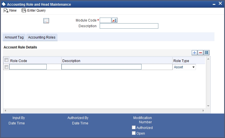

Click ‘Accounting Roles’ tab in the ‘Accounting Role and Head Maintenance’ screen.
In this screen you can enter the following details:
Role Code
Specify the role code.
Description
Enter a brief description about role code.
Role Type
Select the role type from the adjoining drop-down list. The following values are available:
