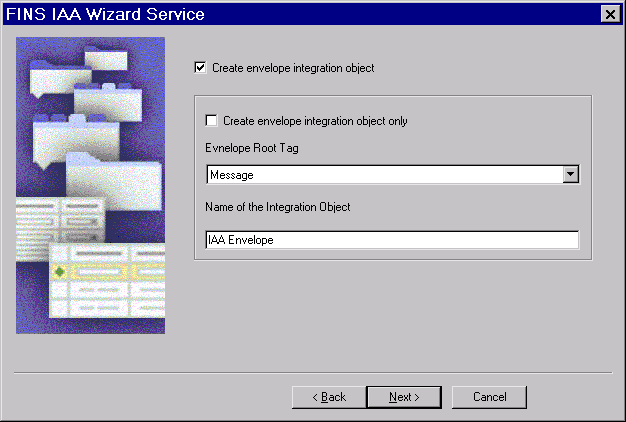

The envelope integration object is not required for all integration processes. If your integration process does not require envelope integration object you can skip this section by clicking Next. Otherwise you can build the envelope integration object using the following procedure.
To Create IAA envelope Integration Objects
  1. Determine whether or not you only need envelope integration object and select the appropriate option on the FINS IAA Wizard Service dialog box.
  2. Provide a meaningful name for the envelope integration object and click Next.
    NOTE:  It is recommended to use Message as you Envelope Root Tag unless you have customized your .DTD file.
    The next dialog box of the FINS IAA Wizard Service appears.
