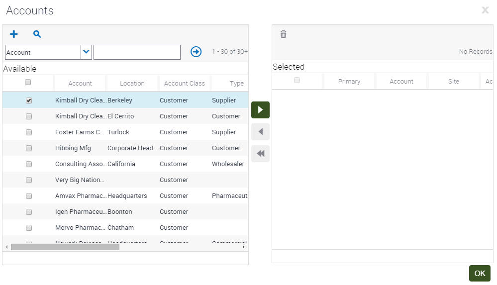

Multiple selection dialog boxes allow you to associate multiple records with one record. On different screens in the Siebel application, you can associate a record with an existing record in a multiple selection dialog box and with a new record in a multiple selection dialog box.
Figure 5-2 shows an example of a multiple selection dialog box.
Figure 5-2 Example of a Multiple Selection Dialog Box
Surrounding text describes Figure 5-2 .

    A multiple selection dialog box appears showing the list of available records and a list of selected records for the field.
  4. In the list of available records, select the record you want to associate with the current record, and click the move right button to move the record to the list of selected records.
    You can select multiple records by holding down the CTRL key and clicking each record. To select records that are contiguous, you can select the first record, hold down the SHIFT key, and select the last record.
