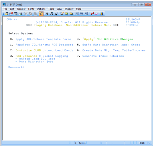

  1. On the Staging Database File Generation Menu, select option 5: Process Non-Additive Components, and press Enter.
    The Staging Database Non-Additive Schema Menu is displayed. The panel ID is SBLSADNP.
  2. On the Staging Database Non-Additive Schema Menu, select option 0: Apply JCL/Schema Template Parms, and press Enter.

  3. On the Staging Database Non-Additive Schema Menu, select option 1: Populate JCL/Schema PDS Datasets, and press Enter.

  6. On the Staging Database Non-Additive Schema Menu, select option 2: Customize CLOB Unload/Load cards, and press Enter.

  8. On the Staging Database Non-Additive Schema Menu, select option 3: Add Jobcards & Siebel Logging to Unloads/Loads and Data Migration Jobs, and press Enter.
