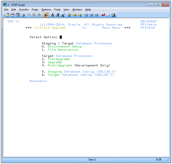

  1. Use the following command to display the Siebel In-Place Upgrade Main Menu:
    EXEC 'DSNHLQ.SIEBEL.EXEC'
    The Main Menu is displayed. The panel ID is SBLUPG8P.

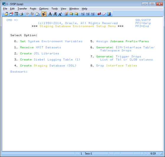

  2. On the Siebel Upgrade Main Menu, select option 0: Environment Setup, and press Enter.
    The Staging Database Environment Setup Menu is displayed. The panel ID is SBLSSETP. The options on this panel allow you to prepare files and set environment variables to create the staging database.
  3. On the Staging Database Environment Setup Menu, select option 0: Set System Environment Variables.
    The Staging System Variable Definitions panel appears. The panel ID is SBLSETVP.
