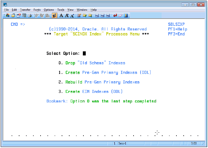

  2. Reselect option 9: SCINDX Index Processes, and press Enter.
    The Target SCINDX Index Processes Menu is displayed. The panel ID is SBLSIXP.
    Figure 13. Target SCINDX Index Processes Menu
  3. Select option 0: Drop Old Schema Indexes, and press Enter.
