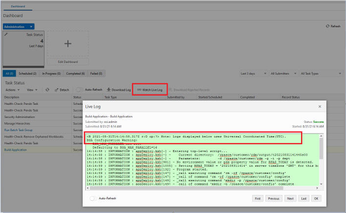

RPASCE in the cloud environment always runs in the UTC time zone. All the downloaded log files, as well as the live logs you view, display information in the UTC time zone only.
The following message is displayed in every log file for all OAT tasks:
<B 2021-08-31T15:17:15.154Z r:D op:?> Note: Logs displayed below uses Universal Coordinated Time(UTC).

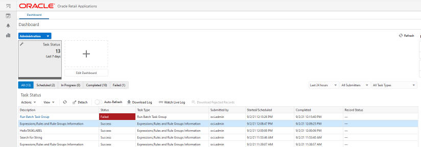

Drilling Down to Actual Logs

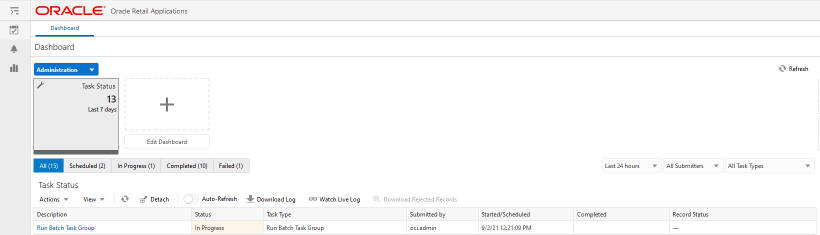

The Dashboard provides the functionality to drill down through the OAT task log files for long-running OAT tasks. This is useful for monitoring tasks that are in a running state; it can also be used to drill down to failed tasks and open the log files.
Figure A-2 shows drilling down to actual logs.

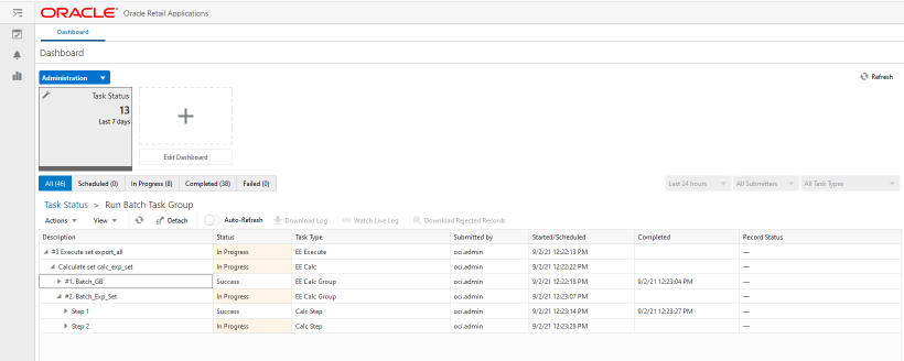

Figure A-3 shows drilling down to actual logs for a running task.

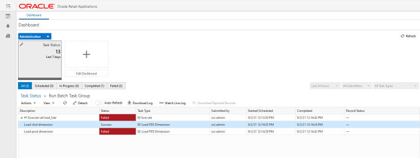

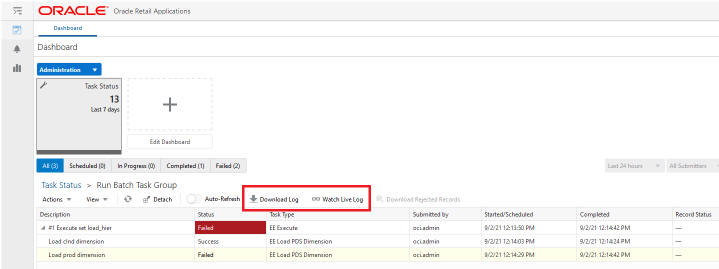

Figure A-4, Figure A-5, and Figure A-6 show drilling down to actual logs for a failed task.
Figure A-4 Drilling Down - Failed Task Part 1
Figure A-5 Drilling Down - Failed Task Part 2
Figure A-6 Drilling Down - Failed Task Part 3

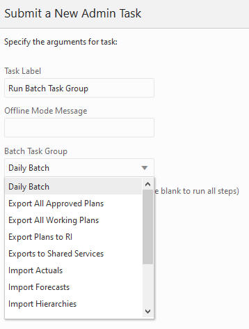

Missing Batch Task Group in OAT Wizard
After uploading the batch control files to the PDS, if you see that a batch task group is missing from the drop-down list, check the batch control file batch_oat_list.txt that was uploaded. This file holds keys to the value seen in the dropbox.
