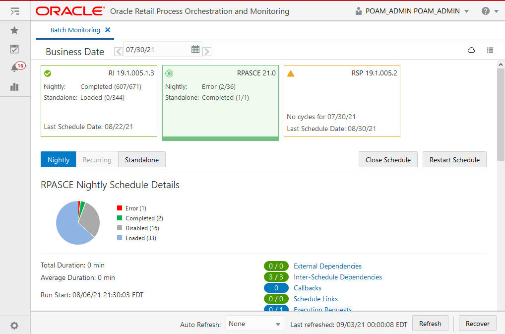

POM Batch Monitoring
The POM Batch Monitoring page, shown in Figure 8-1, is the dashboard for the batch process flows and jobs. On the monitor page, each job can be viewed and acted on and the business date can be viewed and modified. The business date is passed to RPASCE as the value of RPAS_TODAY for batch execution. The Nightly batch include all jobs in the process flow in Table 8-1. The Standalone batch includes only the ad-hoc job.
Figure 8-1 POM Batch Monitoring
Description of Figure 8-1 follows
Description of ''Figure 8-1 POM Batch Monitoring''

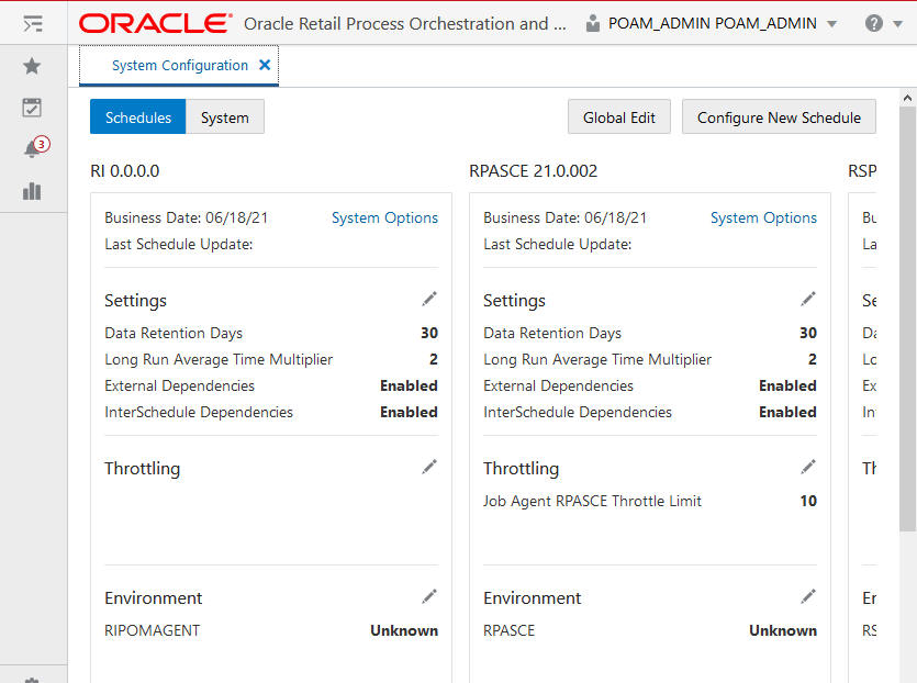

POM System Administration
On the POM System Administration page, shown in Figure 8-2,schedule properties can be modified that include System Options, Settings, Throttling, and Environment.
Figure 8-2 POM System Configuration
Description of Figure 8-2 follows
Description of ''Figure 8-2 POM System Configuration''

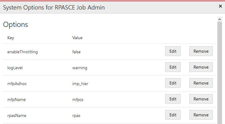

The System Options, shown in Figure 8-3, contain some values that are used in the job parameters. The logLevel is used by the server to determine the detail level of the log for the jobs. The values can be error, warning, information, debug, or all, with increasing details. The mfpAdhoc is used by the ad-hoc job as its batch control set name.
Figure 8-3 POM System Options
Description of Figure 8-3 follows
Description of ''Figure 8-3 POM System Options''

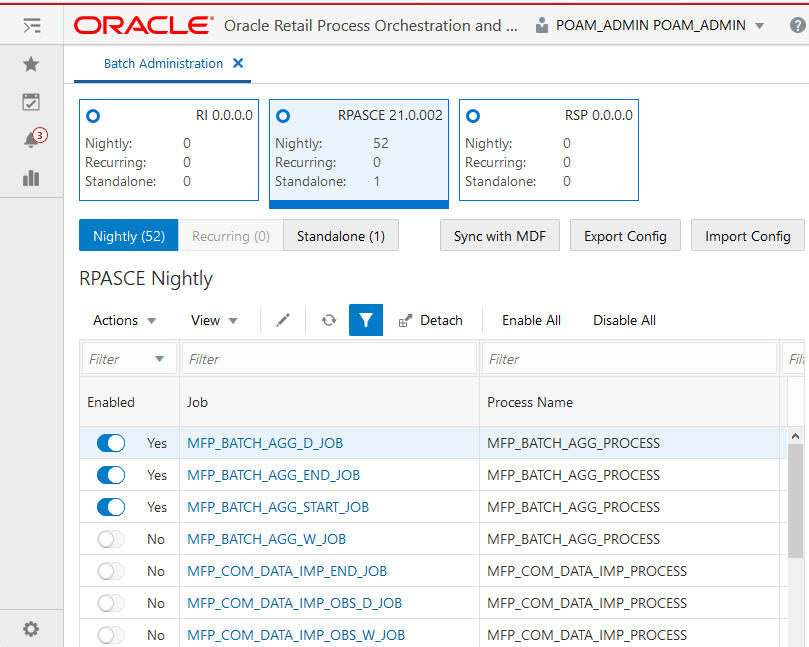

POM Batch Administration

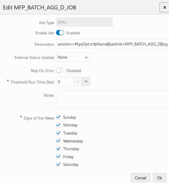

On the POM Batch Administration page, shown in Figure 8-4, each job in the Nightly batch can be enabled/disabled or modified. Clicking on the job brings up a dialog box, shown in Figure 8-5, where dependencies can be modified.
Figure 8-4 POM Batch Administration
Description of Figure 8-4 follows
Description of ''Figure 8-4 POM Batch Administration''
Figure 8-5 Editing POM Batch Administration Dependencies
Description of Figure 8-5 follows
Description of ''Figure 8-5 Editing POM Batch Administration Dependencies''
In the Edit dialog box, the parameters consist of name and value pairs separated by double vertical bars in the following format:
solution=#SysOpt.mfpName||batchid=MFP_BATCH_AGG_D||loglevel=#SysOpt.logLevel||rpastoday=#JobCtxt.businessDate
The #SysOpt values come from the System Options of the schedule, which can be modified from the System Configuration page. It is not recommended to modify the parameters on the Edit page. Instead, the System Options value must be changed.
An additional parameter, exclusive, can be added to the ad-hoc job. Be default, all RPASCE jobs submitted by POM are executed in exclusive mode; that is, online users cannot access the application while the batch jobs are running. If the exclusive parameter is set to 0, online users are allowed to access the application during job execution. Use this parameter cautiously to avoid any side effects.
solution=#SysOpt.mfpName||batchid=#SysOpt.mfpAdhoc||loglevel=#SysOpt.logLevel||rpastoday=#JobCtxt.businessDate||exclusive=0
The Days of the Week check boxes are used to enable the job on the checked day. For example, for a weekly job, only Saturday is checked.

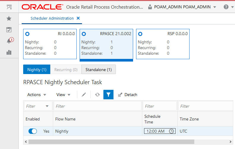

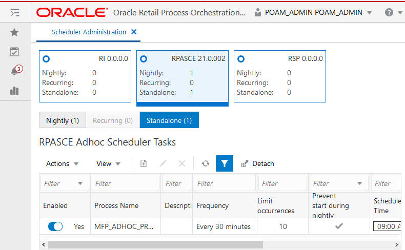

POM Batch Scheduling
The batch scheduling is done through the Scheduler Administration page. The Nightly batch, shown in Figure 8-6, is run every day, and only the start time can be scheduled. The Standalone batch, shown in Figure 8-7, has more scheduling flexibility. Both frequency and start time can be specified.
Figure 8-7 POM Standalone Batch
Description of Figure 8-7 follows
Description of ''Figure 8-7 POM Standalone Batch''
