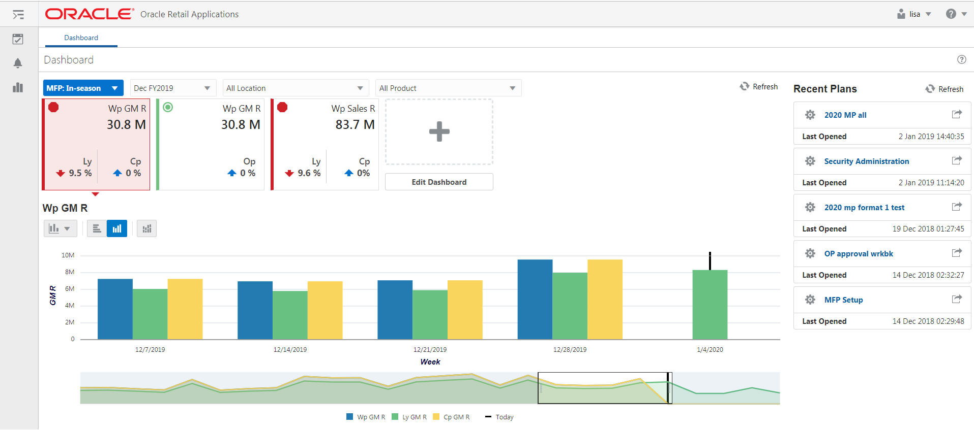

Figure 2-1 shows the view of a dashboard.

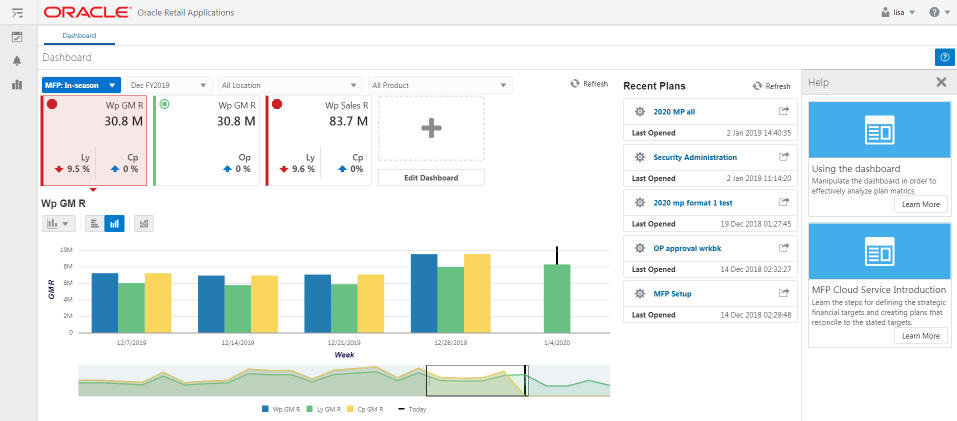

The help topics for the dashboard are visible on the right side panel, as shown in Figure 2-2.
Figure 2-2 Dashboard Help Topics
Description of Figure 2-2 follows
Description of ''Figure 2-2 Dashboard Help Topics''

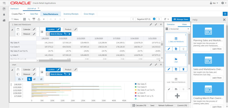

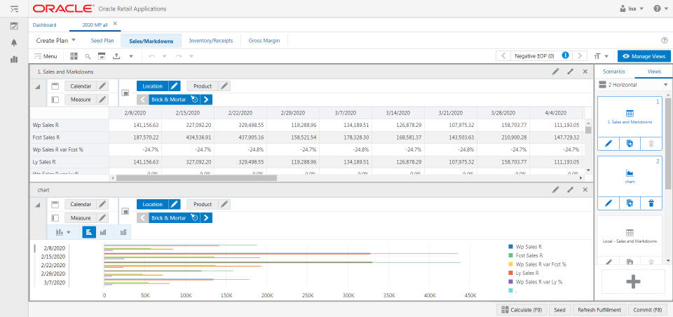

Figure 2-3 illustrates the workspace for the product MFPRCS.
Here the Step, Tabs, and View are visible.
Figure 2-4 MFPRCS Workspace with Help
Description of Figure 2-4 follows
Description of ''Figure 2-4 MFPRCS Workspace with Help''

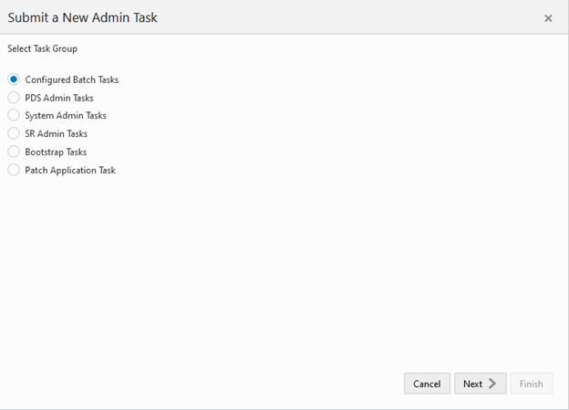

  2. Select Configured Batch Tasks under task group and click Next, as shown in Figure 2-5.
    Figure 2-5 List of Task Groups
    This image displays the list of task groups

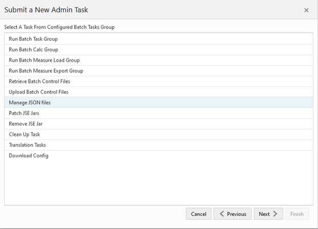

  3. Select Manage JSON files from the list of available tasks and click Next, as shown in Figure 2-6.
    Figure 2-6 List of Tasks Under Configured Batch Task Group
    List of tasks under Configured Batch Task group

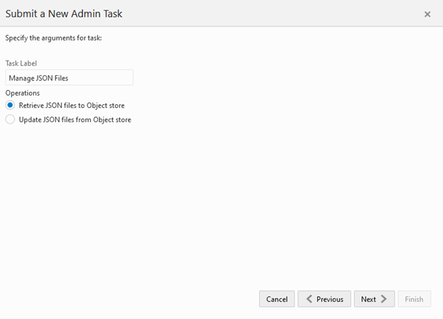

  4. Now the user can provide a task label and select the type of operation to be performed.
    • Retrieve JSON files to Object Storage: This operation performs the task of fetching the help JSON file from the RPASCE application. When this task is run, the help JSON file (with other JSON files) is bundled as a zip with label as <app_name>_json.zip and is placed in object storage under <SubNamespace>/planning/outgoing. The help JSON file is also prefixed with the app name as <app_name>HelpConfig.json
      Example: mfprcsHelpConfig.json
      Refer to Chapter 3, "Uploading and Downloading Files" for more details about downloading and uploading files to Object Storage.
    • Update JSON files from Object Storage: The user can update the help JSON file as per their requirements. Once updated, the file name must be prefixed with the app name as <app_name>HelpConfig.json. Then, this JSON file must be bundled as <app_name>_json.zip and placed in the <SubNamespace>/planning/incoming/config directory.
      When the Update JSON files from Object Storage operation is performed on the RPASCE UI, it fetches the zip bundle from the Object Storage location <SubNamespace>/planning/incoming/config and updates the application with the new changes from the help JSON file. The user must re-login to the application to see the changes.
Figure 2-7 Options to Fetch or Update the JSON Files
Options to fetch or update the JSON files

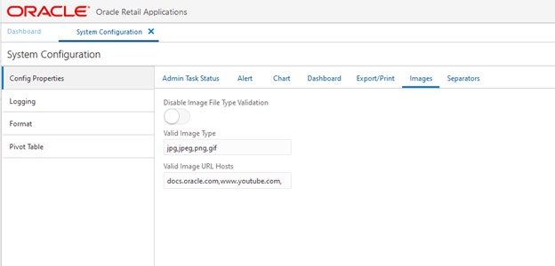

If the user updates the URLs for the help topics in the help JSON file, these URLs must be allowed so that the links are accessible from the RPASCE UI. To allow the URLs, the user must navigate to System Configuration > Config Properties > Images and append the URL host in Valid Image URL Hosts text box.
Figure 2-8 Location to Allow List the URLs
