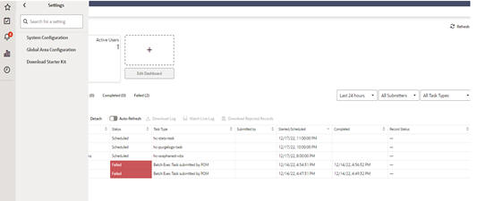

System Configuration provides administrators with the capability to update client-side system properties from the application. The administrator can now update various properties relating to administration status tasks, alert, chart, dashboard, export, image, logging, and separators, and format properties from the application. This feature lets you manage and support your team's operational needs.
The administration user can access the self-service feature from the Settings icon available at the bottom of the left sidebar menu.
Figure 16-1 Self-Service Feature

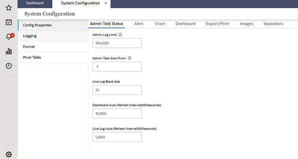

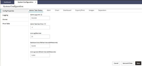

Admin Task Status
Use this tab, shown in Figure 16-3, to update the properties related to administration task status. The following properties can be updated:
  • Admin log Limit - Specify the number of lines in the administration logs. The range of permitted values is between 5,000 and 200,000.
  • Admin Task start from - Define the logging start from start (0) or end (-1) of the file.
  • Live Log Block Size - Enter the block size of the live log. The range of permitted values is between 20 and 30.
  • Use short name for entities - Toggle button to indicate whether you require short names for the entities in the status.
  • Dashboard Auto-Refresh interval - Update the auto-refresh interval time for the administration dashboard in milliseconds. The range of permitted values is between 1,000 and 86,400,000.
  • Live Log Auto-Refresh interval - Update the auto-refresh interval time for the live log. This is in milliseconds. The range of permitted values is between 1,000 and 86,400,000.
Figure 16-3 Admin Task Status
Description of Figure 16-3 follows
Description of ''Figure 16-3 Admin Task Status''

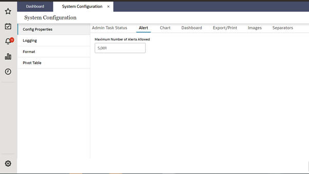

Alert
Use this tab, shown in Figure 16-4, to update the alert properties. You can update the maximum number of alerts allowed. The range of permitted values is between 1,000 and 10,000 alerts.

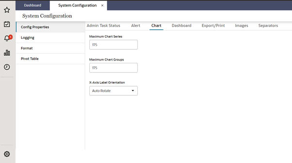

Chart
Use this tab, shown in Figure 16-5, to update the chart properties. The following properties can be updated:
  • Maximum chart series - The maximum number of series allowed in charts. The range of permitted values is between 100 and 200.
  • Maximum chart group - The maximum number of groups allowed to plot in charts. The range of permitted values is between 100 and 200.
  • X-axis Label Orientation - Select x-axis label orientation. The auto-rotate option is used to select the orientation of the x-axis labels, depending on the number of items in charts. The horizontal orientation option is used to display the x-axis label horizontally.

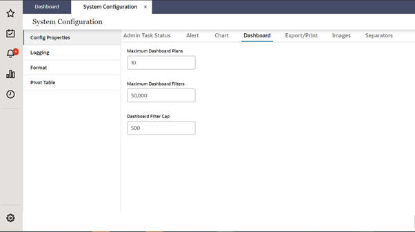

Dashboard
Use this tab, shown in Figure 16-6, to update the properties related to dashboards.
  • Maximum Dashboard Plans - The maximum number of plans for a dashboard. The range of permitted values is between 0 and 50.
  • Maximum Dashboard Filter - The maximum number of filters permitted in a dashboard. The range of permitted values is between 0 and 100,000.
  • Dashboard Filter Cap - The filter cap for a dashboard. The range of permitted values is between 0 and 1,000.
  • Show Retail Home Tasks - Toggle button used to show/hide retail home tasks.

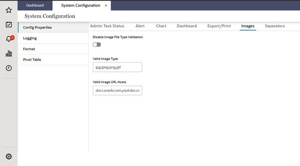

Images
Use this tab, shown in Figure 16-8, to update the following image-related properties.
  • Disable Image file type Validation - Toggle button to indicate whether or not you require file type validation for the images in your system.
  • Valid image type - The image file types that are valid for your application.
  • Valid Image URL hosts - The valid URL hosts for your application.

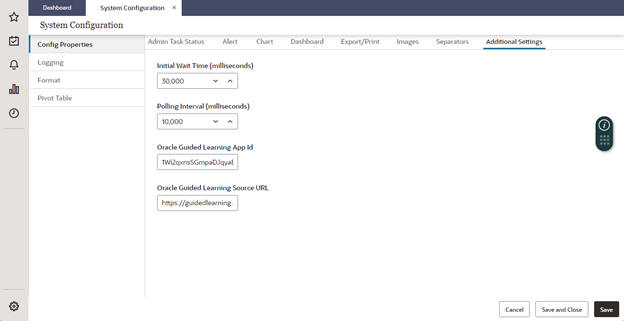

Additional Settings
This tab, shown in Figure 16-13, is hidden by default and can be accessed via Online Admin Tools.

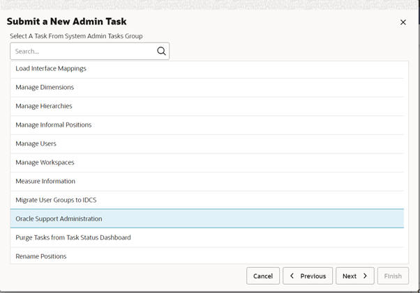

  1. Launch Online Admin Tools and select the System Admin Tasks. Click Next.
  2. Select Oracle Support Administration, as shown in Figure 16-11.
    Figure 16-11 Oracle Support Administration
    Description of Figure 16-11 follows
    Description of ''Figure 16-11 Oracle Support Administration''

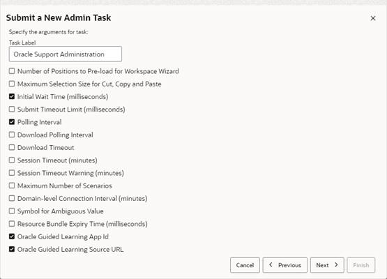

  3. Select the appropriate settings, as shown in Figure 16-12, and submit the task.
    Figure 16-12 Oracle Support Administration Settings
    Description of Figure 16-12 follows
    Description of ''Figure 16-12 Oracle Support Administration Settings''
  4. Once the task is complete, the Additional Settings tab, shown in Figure 16-13, becomes visible and the settings/configuration properties selected in the task are available.
    Figure 16-13 Additional Settings Tab
    Description of Figure 16-13 follows
    Description of ''Figure 16-13 Additional Settings Tab''

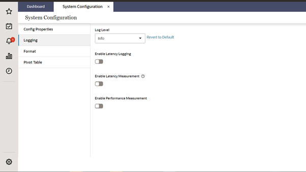

Logging

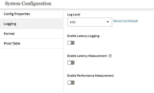

Use this tab, shown in Figure 16-14, to set the log level and enable/disable latency-logging, latency-measurements, and performance-measurements. You must save and log in again in order for the changes to take effect.
Log Level
Use the log level drop-down list to select appropriate log levels. The RPASCE Client application supports the following log levels.
Table 16-1 Log Levels
Log Level Name Log Level Definition
Off
Used to turn off all logs.
Fatal
Used to log severe errors that require immediate attention. These situations either impact the normal operation of the entire application or a component within the application.
Error
Used to log errors. Critical errors and information are logged at this level.
Warn
Used to log messages regarding potentially harmful situations. These situations do not affect the running of the RPASCE Client application, but may not give the desired result. For this reason, it is preferable to warn the user about such situations.
Audit
Used to log messages that indicate a change, including workbook builds, save, commit, and so on. Most of these may already be reflected in the UI or are available on Admin Task Status.
Info
Used to log general information about user actions and main events (for example, if the login was successful or not). This is the default log level.
Profile
Used to log performance characteristics of user actions.
Debug
Used for debug logging. At this level, more logging occurs than at the other levels. Debug information that can help in application debugging is provided at this level. This must only be used for debugging purposes, as the number of logs generated may cause performance issues. When a customer wishes to report a defect, customer support can advise the customer to turn on logging at this level, run the problem scenario, capture the logs, and attach them to the trouble report.
Verbose
Used for very detailed logging. At this level, more logging occurs than at the debug level. Fine-grained information that can help in application debugging is provided at this level. This must be used only for debugging purposes, as the number of logs generated may cause performance issues. When a customer wishes to report a defect, customer support can advise the customer to turn on logging at this level, run the problem scenario, capture the logs, and attach them to the trouble report.
All
Used to turn on all the logging.
Enable Latency Logging
Use the toggle button to enable or disable latency logging. Once enabled, the network latency from the user browser to the application is measured and logged at defined intervals. This can help the customer administrator to work with Oracle support on any network latency-related performance issues.
Enable Latency Measurement
Use the toggle button to enable or disable latency measurement. Latency measurements depends on Latency Logging and so that must also be enabled, along with latency measurements.

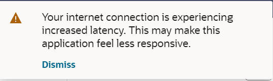

Once this is enabled, users will see the following warning when their network latency exceeds certain thresholds.

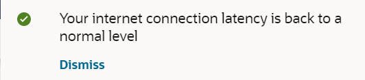

They will see the following information once their network latency returns to normal.
Figure 16-16 Normal Network Latency
Description of Figure 16-16 follows
Description of ''Figure 16-16 Normal Network Latency''
Enable Performance Measurement
Use the toggle button to enable or disable performance measurement. Once this is enabled, the performance timing icon appears on the left task menu (after the user logs in again). The performance values for the current user can be exported or displayed using appropriate sub-menu links.

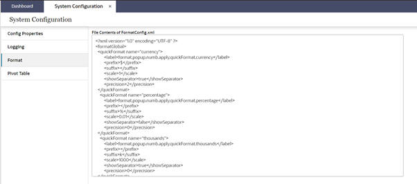

Use this tab, shown in Figure 16-17, to change the FormatConfig.xml file, which controls the formatting properties for the application (that is, currency, percentage, and millions separator).
To save your changes, click Save or Save & Close.
To apply the saved changes, you must re-log into the application.
Figure 16-17 File Contents of FormatConfig.xml
Description of Figure 16-17 follows
Description of ''Figure 16-17 File Contents of FormatConfig.xml''

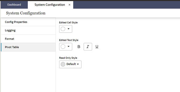

Pivot Table
Use this tab, shown in Figure 16-18, to change the format style of edited uncalculated cells. You can update the color of the edited cell background, edited cell text color, and style.
Note the following:

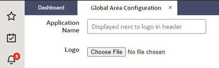

Global Area Configuration
The Global Area Configuration page allows an administration user to configure certain components of the branding area, including the application name and the logo.
The PLATFORM_SERVICES_ADMINISTRATOR_ABSTRACT group must be assigned to the user in IDCS or OCI IAM or the user will experience a 403 forbidden error after attempting to save.
Figure 16-19 Global Area Configuration Page
Description of Figure 16-19 follows
Description of ''Figure 16-19 Global Area Configuration Page''
The Global Area Configuration page can be reached through the Settings menu (Settings > User Interface > Global Area Configuration). After making changes, including updating the application name and uploading the logo, on this page, click Save or Save and Close to apply the new settings. To revert to the default settings, remove the custom value and click Save.

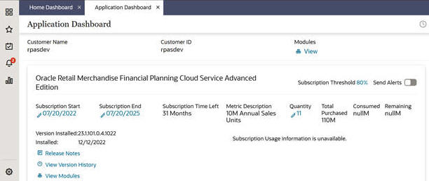

Monitoring Subscription Usage in Retail Home
All Oracle Retail cloud service subscriptions include a subscription metric that defines in some way the capacity of the systems provisioned as a part of the subscription. The actual metric varies across Oracle Retail cloud services.
For RPASCE applications, the subscription metric is tens of millions of annual sales in units, or 10M annual Sales Units, as it often appears.Users with administrative rights for Retail Home can view information on the quantity of units defined for their subscription and see information on actual usage over time for RPASCE application subscriptions (and any other Oracle Retail cloud service subscriptions) as well as for the AI Foundation component that is a part of every Oracle Retail cloud service subscription.This information is accessible on the Application Dashboard screen of Retail Home, shown in Figure 16-21.
Figure 16-21 Retail Home Application Dashboard
Description of Figure 16-21 follows
Description of ''Figure 16-21 Retail Home Application Dashboard''
For more information on accessing the Application Dashboard, as well as information on the information presented on that screen, refer to the chapter "Application Dashboard" of the Oracle Retail Home Administration Guide.
