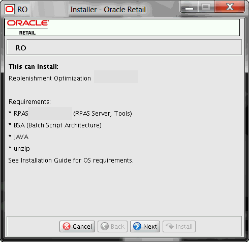

The RO Installation Window opens and shows the components that are installed during installation process as well as other required components. Click Next to continue.
Note: Oracle Retail Batch Scripting Architecture (BSA) must be installed prior to installing RO. For information about installing BSA, see the Oracle Retail Batch Script Architecture Implementation Guide. |

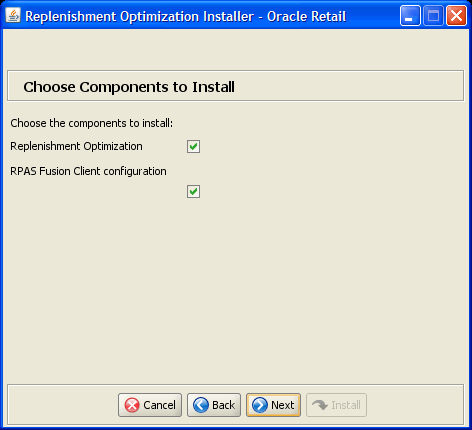

The Choose Components to Install Window opens.
Select the following options:
Replenishment Optimization — Select this option to install the RO server with the domain.
RPAS Fusion Client configuration — Select this option to install the RPAS Fusion Client configuration for RO. For more information on the configuration files included for the RPAS Fusion Client, see Configuration Files for the RPAS Fusion Client.

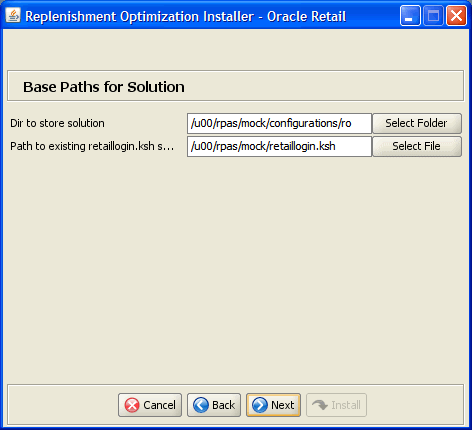

The Base Paths for Solution Window opens.
Enter the relevant information in the following fields and click Next to continue:
| Field | Description |
| Dir to store solution | Enter the directory path where your solution should be stored. |
| Path to retaillogin.ksh script | Enter the path and file name to the retaillogin.ksh script created during RPAS installation. |
Note: Ensure that the installation paths are located outside of the installer directory [RO Installation]. |

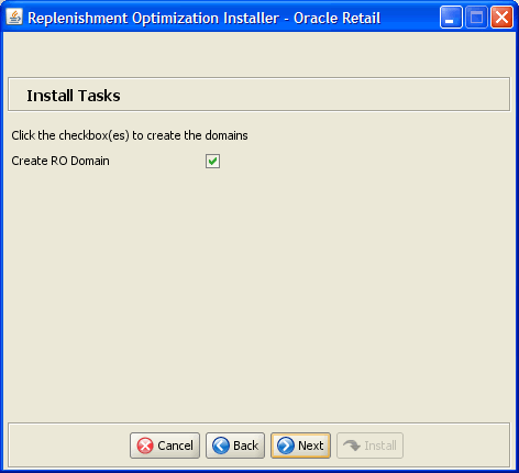

The Install Tasks Window opens.
Select or clear the Create RO Domain check box:
If you want to create the RO domain, select the Create RO Domain option, which is selected by default.
If you want to install all required components to support the RO domain, but not create the actual domain, clear the check box.
Note: Domain builds use the environment specified in theretaillogin.ksh environment setup script. If you change any environment details, edit the retaillogin.ksh script and any subsequent scripts called by retaillogin.ksh.
For more information about the |

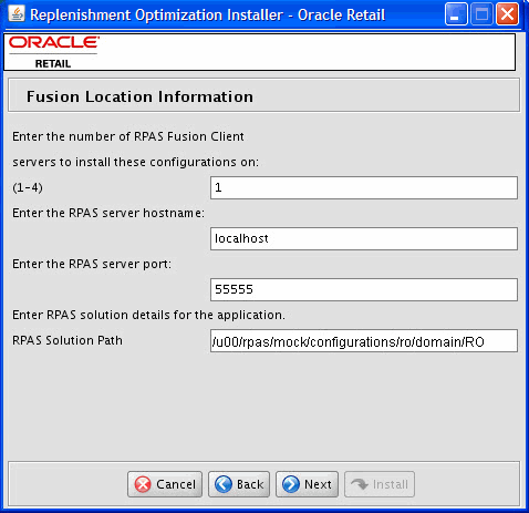

The Fusion Location Information Window opens.
Note: The Fusion Location Information windows open when you select the RPAS Fusion Client configuration check box on the Choose Components to Install Window.If you are not installing the RPAS Fusion Client configuration, proceed to step 8. |
Enter the relevant information in the following fields:
| Enter the number of RPAS Fusion Client servers to install these configurations on: (1-4) | Enter the number of servers running the RPAS Fusion Client where you want to install the RO configuration. In case the RPAS Fusion Client is running on a single server, enter 1. If you have a clustered installation, you can enter up to four servers |
| Enter the RPAS server hostname: | Enter the hostname of the RPAS server. |
| Enter the RPAS server port: | Enter the port number of the RPAS server. |
| RPAS Solution Path | Enter the location of the RPAS domain for RO. |

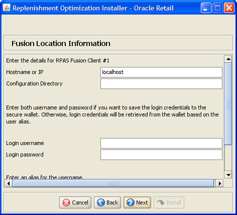

Based on the number of servers you entered, the Fusion Location Information (Details) Window opens.
Enter the server details in the following set of fields for each configuration:
| Hostname or IP | Enter the host name or IP address of the server where the RPAS Fusion Client is installed. |
| Configuration Directory | Enter the location of the config directory available at the location where the RPAS Fusion Client is installed. |
| Login username | Enter the user name to log on to the server where the RPAS Fusion Client is installed. |
| Login password | Enter the password associated with the user name. |
| Login username alias | Specify an alias name for the administrative user. Specifying an alias name for the administrative user enhances the security for the application. When left blank, the alias name defaults to the administrative user name. |
Note: Information such as user credentials for the RPAS Fusion Client is encrypted and stored in a secure location in the application installation directory. This location is called the Oracle Wallet.When the installation starts, the administrative user credentials are retrieved from the Oracle Wallet based on the alias name specified in this window. |

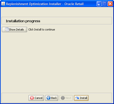

The Installation Progress Window opens. To start the installation, click Install.
This window displays installation progress. Click Show Details if you want to view the log output as the installation is performed. If you choose not to view the details, a graphical representation of the installation steps opens. As each step is completed, the text color changes to indicate installation progress.
You can toggle between the Show Details mode at any time during or after the installation.
When the installation process is finished, the Complete window opens. Click OK.
Note: When reviewing Installer output or logs, you may see the following message: [scp] Caught an exception, leaving main loop due to Socket closed. This message is harmless and does not indicate failure. |
If you viewed the installation through the graphical progress, you can now click Show Details to view the logs.
Once you are finished reviewing the installation, click Exit to close the installer application.
