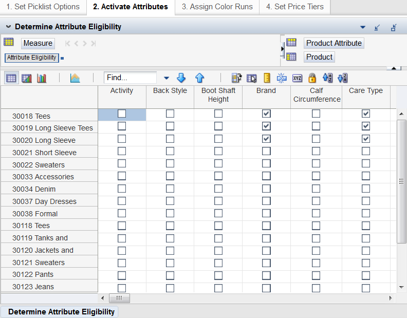

The Planning Administrator activates product attributes for an aggregate intersection of the product hierarchy. For example, only the handbag attributes should be activated for the handbag classes. By activating them, only the handbag merchants can see them. This helps to reduce clutter in the workbooks.
This is the only view on this tab.
Note: Price Tier is a mandatory Product Attribute. In this view, if the user does not manually set the Attribute Eligibility to true for Price Tier, it will be set to true for all subclasses during the commit process of this workbook. |

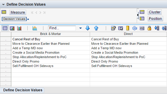

In this step, the Planning Administrator defines and maintains the list of possible Decision values from which a merchant selects in the Keep/Markdown/Drop process in the Weekly Analysis step of the task flow.
The solution comes packaged with a number of attribute measures (such as Brand, Color, and so on), but more can be added as the attribute hierarchy is DPM enabled. This means that new attributes may be added by a designated user using the Fusion UI. The Dynamic Position Maintenance option is available on the right click menu, when you click on the Product Attributes hierarchy.

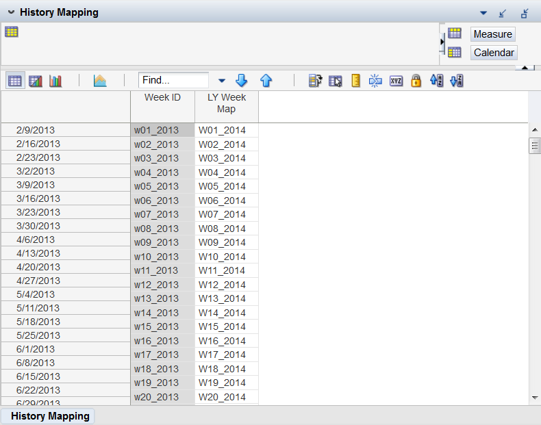

In this step, the Planning Administrator maps the history week to the weeks being planned.
In the Assortment Planning solution, actual values are loaded into the Working Plan (WP) version for elapsed time-frames and Last Year (LY) versions are derived using the WP version and a specified lag. Typically, this is performed by a standard lag of 52 weeks. Sometimes, there is the need to accommodate 53-week years or to shift weeks due to seasonality.
When setting History Mapping, the Planning Administrator enters values for the year they want to map to, not the year they are mapping from. For example, if the Administrator wanted to set the LY mapping for 2014, the Administrator should enter values for 2013, because those are the weeks being mapped to for 2014 LY. The Administrator should not map weeks that are not yet in the calendar master file, otherwise, an error occurs upon the workbook builds.
Three types of History Mapping can be entered:
One-to-One Week Mapping: Last Year lagged measures for 2013 will point to the same week number in 2014. This is used when This Year and Last Year are both 52-week years. In other words, 201452 (week 52 of 2014) map back to 201352 (week 52 of 2013).
One-to-Many: Last Year lagged measures for weeks 52 and 53 in 2017 are both mapped to Week 52 in 2016. This is used when the year you are mapping from (2017) has 53 weeks, but the year you are mapping to has 52. Note that the date entries should be separated by a space. In other words, 201752, 201753 (week 52 and 53 of 2017) map back to 201652 (week 52 of 2016).
Many-to-One Week Mapping: Last Year lagged measures for week 52 in 2018 points to the sum of values for weeks 52 and 53 in 2017 (weeks 4 and 5 of month 12). This is used when the year you are mapping to (2017) has 53 weeks, but the year you are mapping from (2018) has 52. In other words, 201852 (week 52 of 2017) maps back to 201752 and 201753 (week 52 and week 53 of 2017).

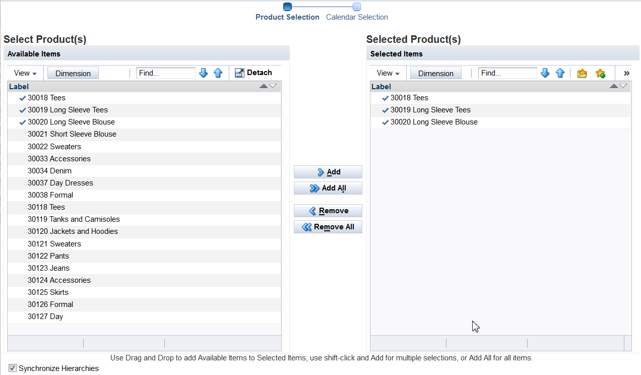

In the Select Product(s) page, select the subclasses for which size profiles and prepack definitions are to be defined. Click Finish.
The workbook is created.

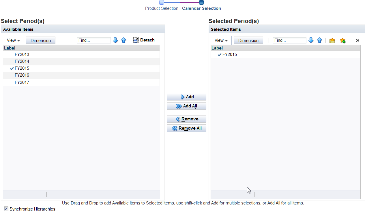

In the Select Product(s) page, select the merchandise levels for the MFP targets to be reviewed or maintained. Click Next.
In the Select Period(s) page, select the time periods for examination. Click Finish.

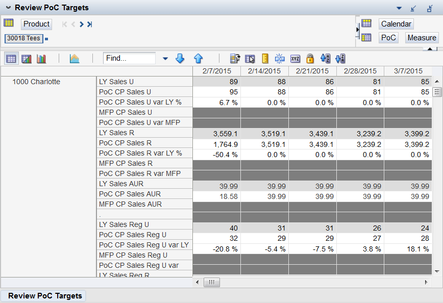

In this step, the merchant/trader can review the MFP targets, which may be used as a source for initializing the PoC level targets. The targets include Sales Retail, Sales Units, Gross Margin Retail, and Gross Margin %. If an MFP or Loc Plan solution is not being used, Last Year values can be used to spread the MFP plan to the Week, Subclass, and PoC Level.

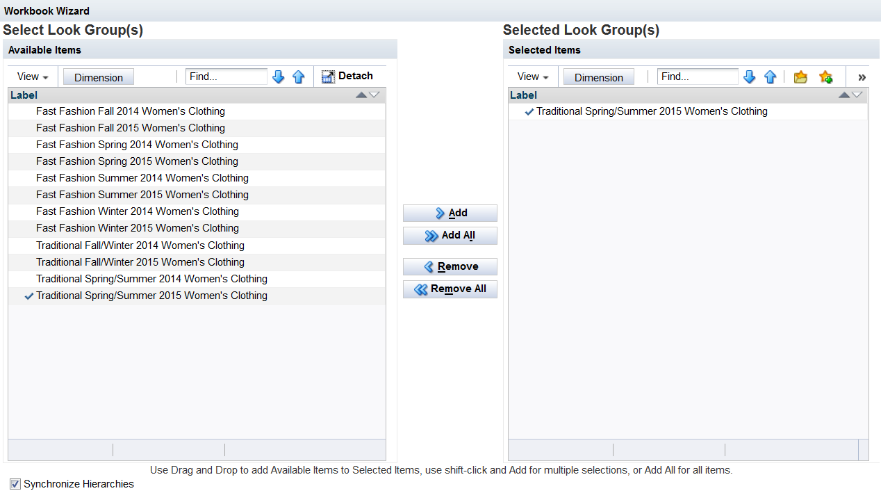

In the Select Look Group(s) page, select the Look Groups to be reviewed or maintained. Click Finish.
