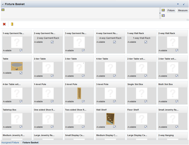

 | The Visual Merchant sets up fixtures and capacities (or loaded from an external source) in the Assortment Setup task. |

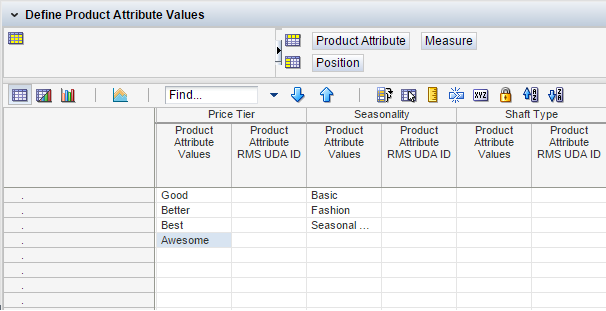

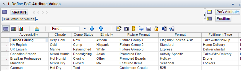

The Define PoC Attribute Values view enables the Planning Administrator to define and maintain sets of values for store, site, application, and network attributes.

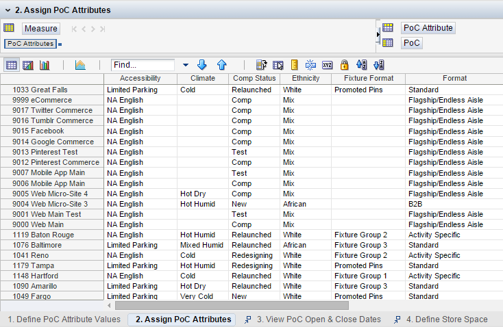

The Assign PoC Attributes view enables the Planning Administrator to associate stores with the appropriate store attributes.
| Note:The user does not need to assign the attributes to the PoCs in the Wholesale and Franchise channels. The assigned attributes are solely used in clustering and these Wholesale and Franchise channels do not go through the clustering process. |

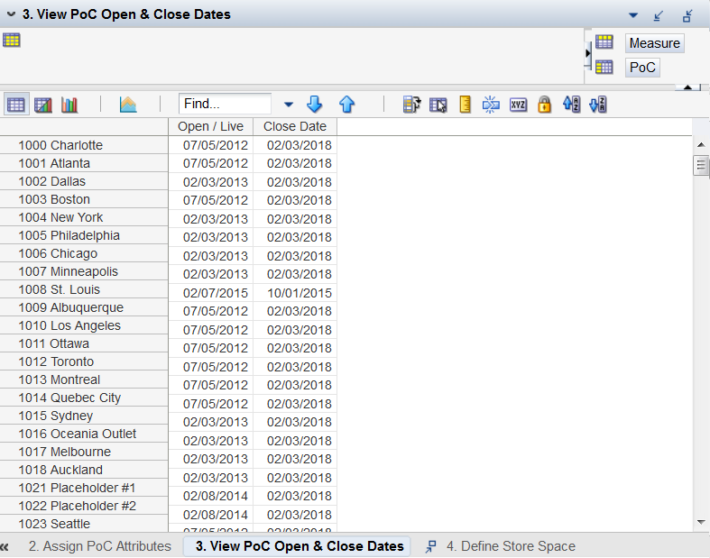

The store, site, application, and network closing and opening dates are defined and maintained in this view. These dates are not used in any calculation. They are for informational purposes only.

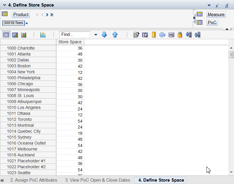

In this view, store space may be defined and maintained. It is used later in the Store Clustering workbook to group stores based on store capacity/constraints. While this view focuses on stores, this attribute may be used for sites, applications, and networks if needed.

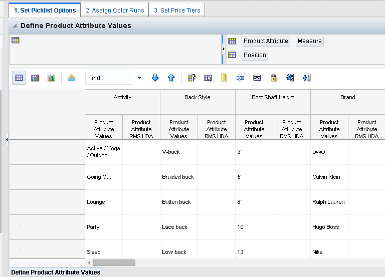

The Planning Administrator defines and maintains product attribute options that will appear on the picklists that merchants use when assigning attributes to a new style or style-color. The solution comes packaged with a number of attribute measures (such as Brand, Color, and so on), but more can be added as the attribute hierarchy is DPM enabled. This means that new attributes may be added by a designated user using the Fusion UI. The Dynamic Position Maintenance option is available on the right click menu, when you click on the Product Attributes hierarchy.
This is the only view on this tab.

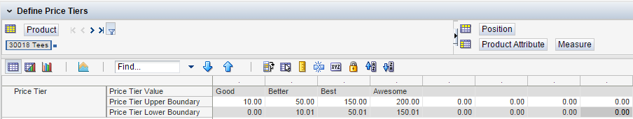

The Planning Administrator defines Price Tiers as Product Attribute Values in this view. The values for these Price Tiers are specified in the Set Price Tiers view. In Figure 2-8 four Price Tiers are defined: Good, Better, Best, and Awesome.
| Note:The sequence of Price Tier values should be entered or loaded in ascending order, from lowest price tier to highest price tier. For example, if four price tiers values are being planned: Good, Better, Best, and Awesome, the lowest price tier, Good, should be entered first followed by Better, Best, and Awesome. The price tiers should not be entered or loaded as Awesome, Best, Better, Good, or any other order that is not ascending. |

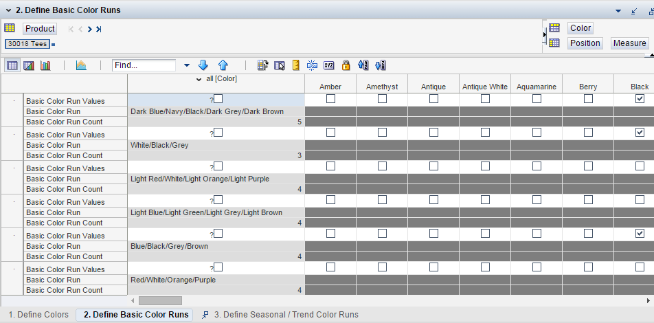

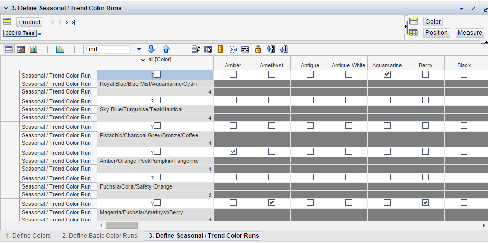

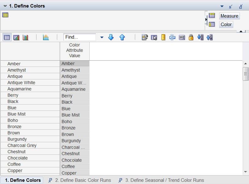

The Planning Administrator builds color runs for use in the Shopping List process. At this stage, the merchant likely does not know the colors carried for a style, but will likely know whether they wish to carry it in basic, trend, or classic colors. A color run is just a set of color families to be carried for the style (such as black, white and grey or green, purple and orange, and so on).
In this view, the Planning Administrator defines the color values. New colors are added using Dynamic Position Maintenance (DPM) in this view.
The basic color runs are defined and maintained in this view and used in the Create Shopping List task.

The Planning Administrator sets the price tiers labels and boundaries in this view for each subclass. The labels allow the Administrator to define the names for the price tiers. The labels were set in the previous view, Set Picklist Options. The lower boundary measure is defined as zero (0) for the lowest tier, the Good tier. The lowest boundary of other tiers is copied from the upper boundary plus .01 of the previous tier. This measure is read only and prevents overlaps between boundaries. The upper boundary measure is the upper limit for each price tier for each subclass. It is recommended to set the highest price tier upper boundary to a value high enough, for example 9999, to classify all items in that tier. Any items that have a price tier higher than this should be classified under the next highest price tier. The price tier upper and lower boundaries are used later to classify styles and style-colors by price tiers based on their planned price.
In Figure 2-12, the upper and lower boundaries are set for the four Price Tiers defined in the Define Product Attribute Values view. See Figure 2-8.

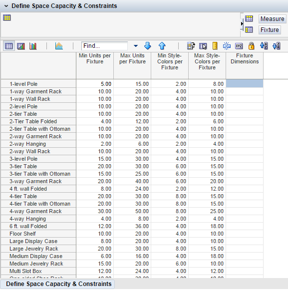

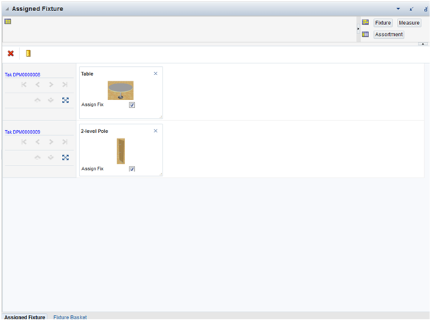

In this step, the Planning Administrator views or defines fixture dimensions, max/min units, and options per fixture. This information is used to determine the number of style-colors based on capacity in the Create Shopping List and Build the Wedge tasks.
These capacities can be set for sites, applications, and networks, not just for stores. For example, a catalog may have a fixed page count or a micro-app may be focused on a time-pressed shopper. The retailer may decide that only 50 styles should be made available to avoid having to spend lots of time scrolling and to save the shopper time by focusing on just the best options for the target of the micro-app.

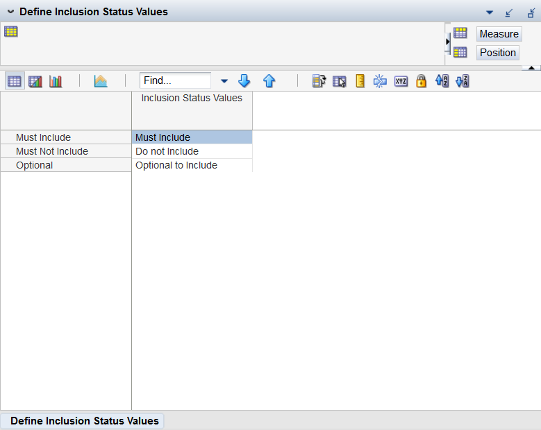

This step enables the Administrator to adjust the labels for the style-color inclusion status measure used in the Wedge Population Automation function in the Build the Wedge process. The default options are: Must Include, Must Not Include, and Optional. Any character choices may be entered.

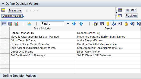

In this step, the Planning Administrator defines and maintains the list of possible Decision values from which a merchant selects in the Keep/Markdown/Drop process in the Weekly Analysis step of the task flow.

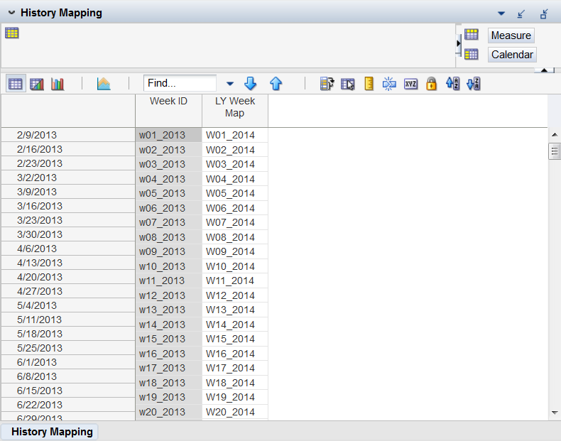

In this step, the Planning Administrator maps the history week to the weeks being planned.
In the Assortment Planning solution, actual values are loaded into the Working Plan (WP) version for elapsed time-frames and Last Year (LY) versions are derived using the WP version and a specified lag. Typically, this is performed by a standard lag of 52 weeks. Sometimes, there is the need to accommodate 53-week years or to shift weeks due to seasonality.
When setting History Mapping, the Planning Administrator enters values for the year they want to map to, not the year they are mapping from. For example, if the Administrator wanted to set the LY mapping for 2014, the Administrator should enter values for 2013, because those are the weeks being mapped to for 2014 LY. The Administrator should not map weeks that are not yet in the calendar master file, otherwise, an error occurs upon the workbook builds.
Three types of History Mapping can be entered:
One-to-One Week Mapping: Last Year lagged measures for 2013 will point to the same week number in 2014. This is used when This Year and Last Year are both 52-week years. In other words, 201452 (week 52 of 2014) map back to 201352 (week 52 of 2013).
One-to-Many: Last Year lagged measures for weeks 52 and 53 in 2017 are both mapped to Week 52 in 2016. This is used when the year you are mapping from (2017) has 53 weeks, but the year you are mapping to has 52. Note that the date entries should be separated by a space. In other words, 201752, 201753 (week 52 and 53 of 2017) map back to 201652 (week 52 of 2016).
Many-to-One Week Mapping: Last Year lagged measures for week 52 in 2018 points to the sum of values for weeks 52 and 53 in 2017 (weeks 4 and 5 of month 12). This is used when the year you are mapping to (2017) has 53 weeks, but the year you are mapping from (2018) has 52. In other words, 201852 (week 52 of 2017) maps back to 201752 and 201753 (week 52 and week 53 of 2017).

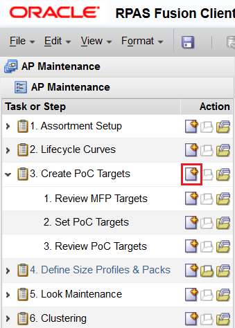

To build the Create PoC Targets workbook:
Select the New Workbook icon in the Create PoC Targets task.
The workbook wizard opens.
In the Select Product(s) page, select the merchandise levels for the MFP targets to be reviewed or maintained. Click Next.
In the Select Period(s) page, select the time periods for examination. Click Finish.
The workbook is created.

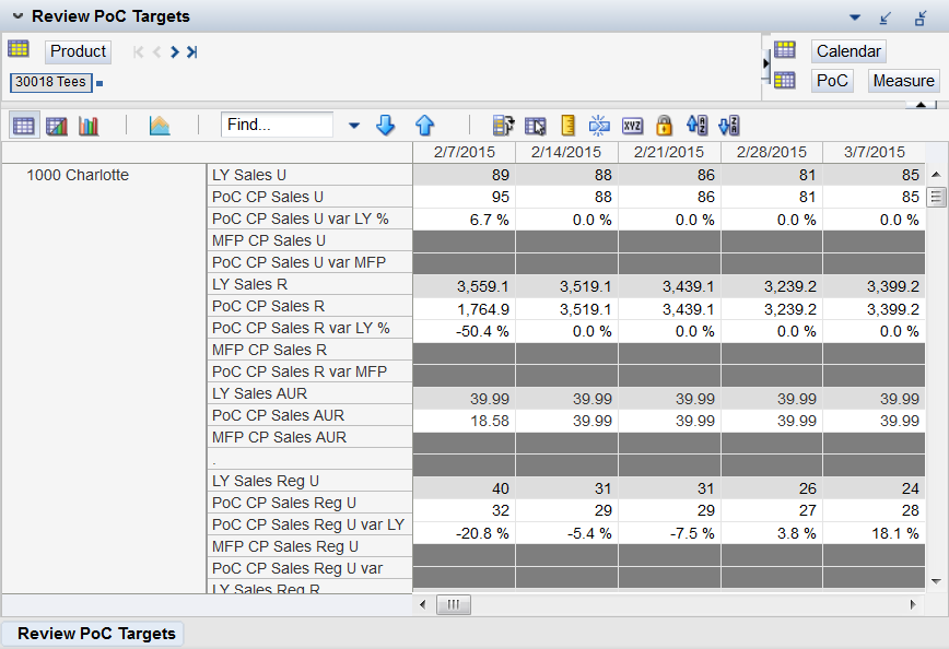

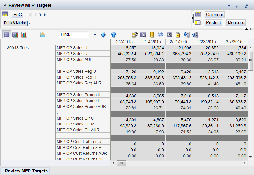

In this step, the merchant/trader can review the MFP targets, which may be used as a source for initializing the PoC level targets. The targets include Sales Retail, Sales Units, Gross Margin Retail, and Gross Margin %. If an MFP or Loc Plan solution is not being used, Last Year values can be used to spread the MFP plan to the Week, Subclass, and PoC Level.

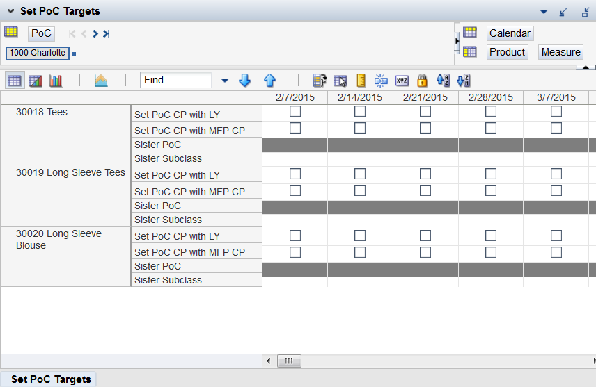

In this step, the merchant/trader selects a source calculating the targets and then runs the Custom Menu that creates them. There are several source options. You can use Last Year or MFP spread to store based on LY or copy from a Sister Subclass. All of these options can vary by any dimension of the Point of Commerce hierarchy (for example, mobile commerce can have one approach and stores in California another).
This step has one custom menu option.
Set PoC Targets
This custom menu option uses your selections to calculate PoC level targets. MFP is assumed to be at the subclass level.
To run the custom menu option:
Select one of the following Boolean measure settings:
Set PoC CP with LY
Set PoC CP with MFP CP
For new store and new subclass, select Sister Store and Sister Subclass.
For new store and existing subclass, select Sister Store only.
Access the Custom Menu Option and select Set Location Plan Targets.

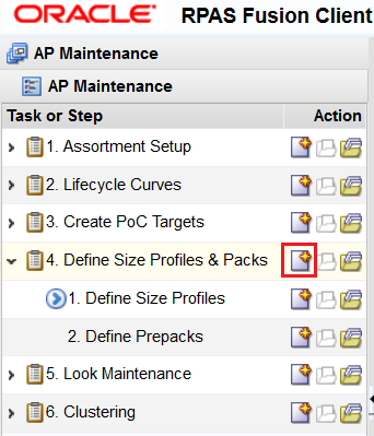

Select the New Workbook icon in the Define Size Profiles & Pack task.

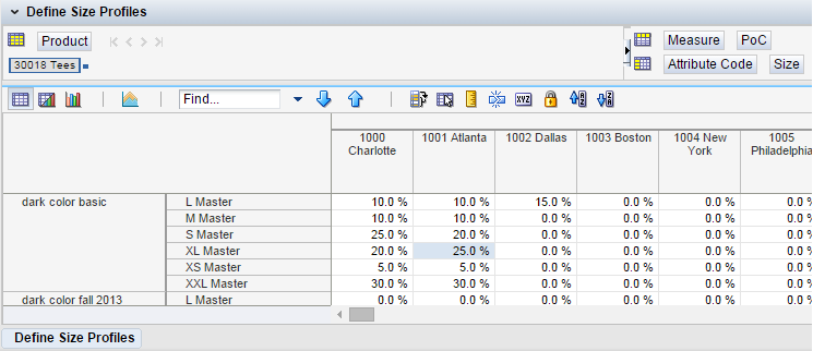

In this step, the designated Administrator defines and manages the pool of Size Profiles from which the merchant will later select. This information is typically interfaced from an external system, such as SPO, but may also be entered or edited manually when a SPO solution is not being used.
In this step, the designated Administrator defines and manages the pool of Prepack Profiles from which the merchant will later select. This information is typically interfaced from an external system, such as SPO, but may also be entered or edited manually when a SPO solution is not being used.

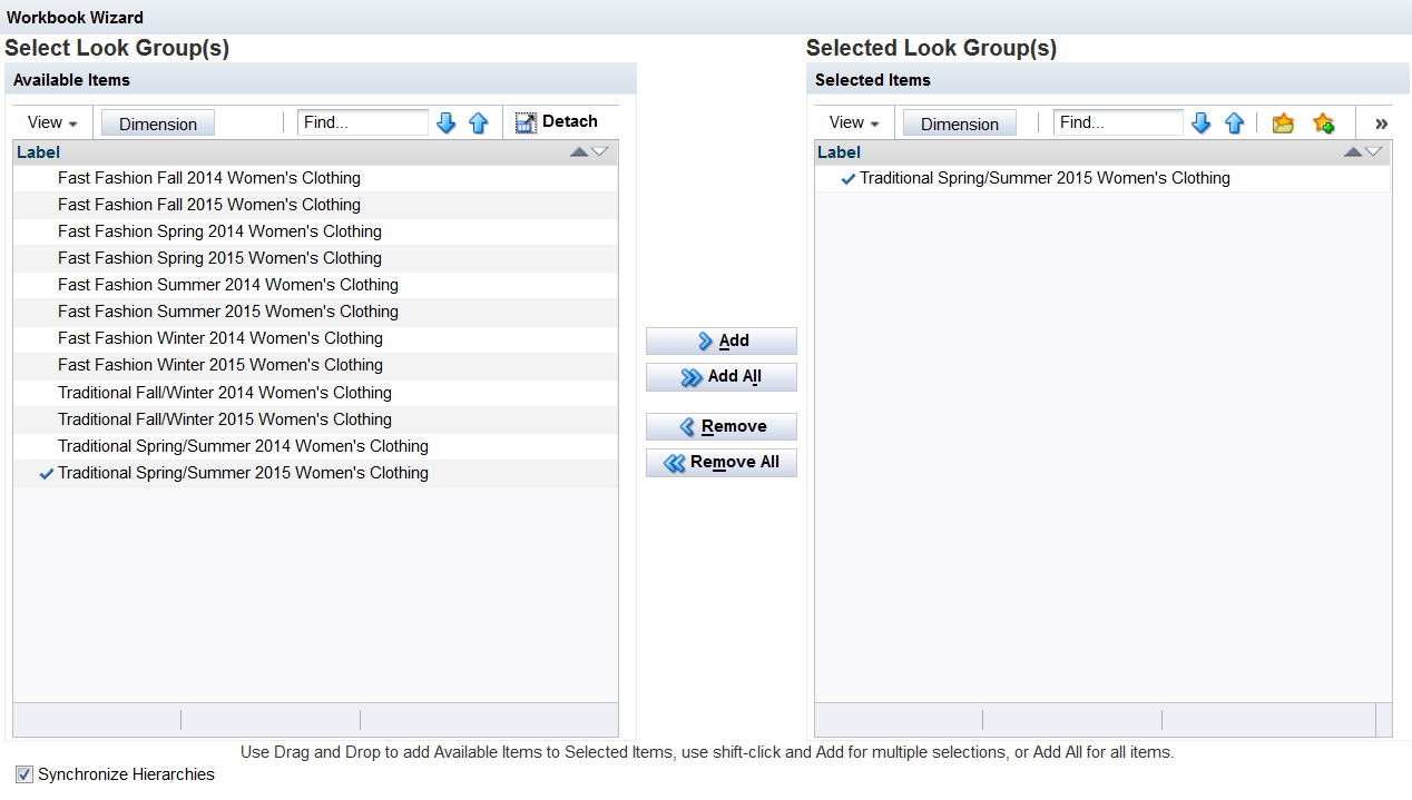

To create the Look Maintenance workbook:
Select the New Workbook icon in the Look Maintenance task.
In the Select Look Group(s) page, select the Look Groups to be reviewed or maintained. Click Finish.

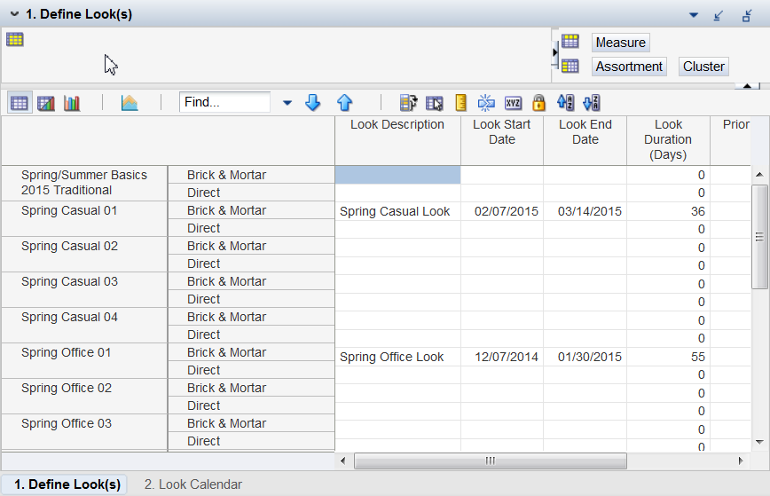

In this view, the Merchant/Trader defines all the pertinent aspects of a Look Group and its Looks and may review Looks using a visual representation of the Calendar hierarchy.
This step has the following views:
For information on the available custom menu option, see "Commit Plan" for this task.
In this view, the Look Groups and Looks are created/maintained.

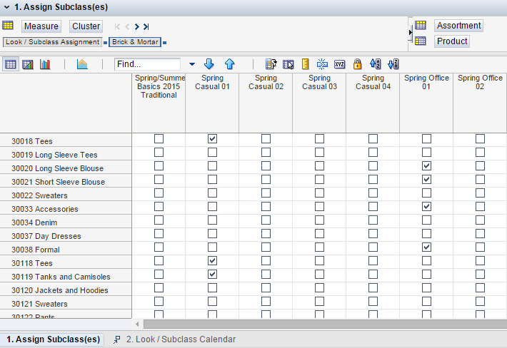

In this step, the merchant/trader defines and maintains subclass/look assignments.
This step has one custom menu option. For information on the available custom menu option, see "Commit Plan" for this task. This custom menu option is available in the Assign Subclass and Look/Subclass Calendar views.
In this view, the Merchant/Trader uses check boxes to indicate the subclasses that should be assigned to the Look. The subclasses can be assigned to multiple Looks as long as the Looks are not running in parallel. In another words, the Looks that contain the same subclasses cannot have overlapping start and end dates.

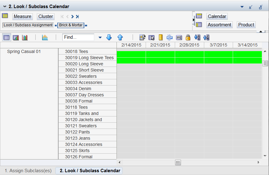

In this view, looks and their associated subclasses may be viewed along the Calendar hierarchy. This provides a user-friendly way to view successive Look Groups or Looks/Subclasses or to spot any gaps between Looks/Subclasses.

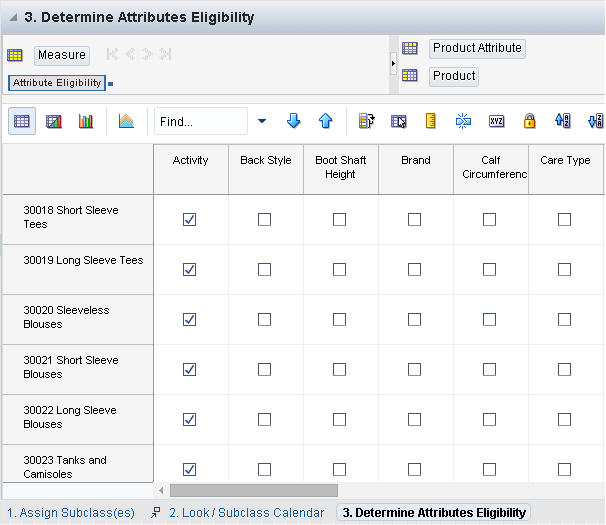

The Merchant/Trader activates product attributes for an aggregate intersection of the product hierarchy. For example, only the handbag attributes should be activated for the handbag classes. By activating them, only the handbag merchants can see them. This helps to reduce clutter in the workbooks.
| Note:Price Tier is a mandatory Product Attribute. In this view, if the user does not manually set the Attribute Eligibility to true for Price Tier, it will be set to true for all subclasses during the commit process of this workbook. |

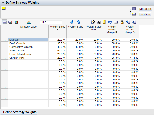

In this step, the merchant/trader designates the Strategy/Intent for each Look for use in clustering Points-of-Commerce into clusters and cluster parents. Each Strategy/Intent is defined and maintained in the Define Strategy/Intent Weights step of the Assortment Setup task.
This step has one custom menu option. For information on the available custom menu option, see "Commit Plan" for this task. This custom menu option is available in the Assign Strategy/Intent views.

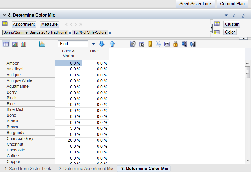

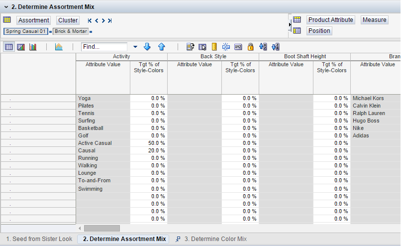

In this step, the Assortment Mix Targets by Product Attribute and/or Color can be determined (this step is optional) by specifying the percentage of Style-Colors by product attribute and color or by loading from an external source. These targets can be used throughout the assortment process to determine whether the assortment has the right mix of product attributes and colors, and so on. These will be shared with the Shopping List where they can be edited and then from the Shopping List spread to each cluster where again they can be edited. Once edited in the Wedge (if desired), they can be used by the Wedge Population Automation to recommend assortment decisions by Wedge (intersection of Cluster and Look).
In addition to the Commit Plan custom menu, this step also has the following custom menus:

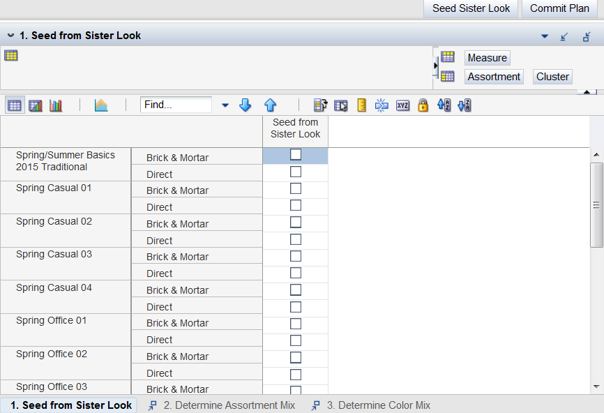

This custom menu option copies the percentage of style-colors and attribute priorities from the Sister Look to the look that the merchant/trader is planning.
The merchant/trader should first specify the Sister Look in the Define Look view, and then run the custom menu option to copy the measures previously mentioned.
To run this custom menu option:
In the Define Look view, specify Sister Look from a pick list of Looks in the Assortment hierarchy for the same channel.
In the Determine Assortment Mix view, select the Boolean Seed from Sister Look at the Look and Channel level measures.
Access the custom menu option and select the Seed from Sister Look measure.

| % of Style-Colors | Sister Look % of Style-Colors | Seeded at look/attribute level Normalized to 100% In Seed From Sister Look |
This custom menu option is available in the Seed from Sister Look view.
For information on this custom menu option, see "Commit Plan" for this task. This custom menu option is available in the Seed from Sister Look, Determine Assortment Mix, and Determine Color Mix views.

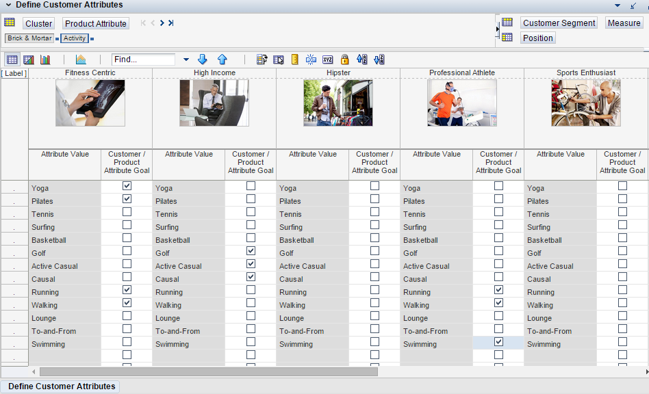

In this view, the merchant/trader selects which Looks should inherit values for % of Style-Colors and Attribute Priority from a Sister Look specified in the Define Look step. If the Seed from Sister Look custom menu is run without checking the Seed from Sister Look measure for at least one look/channel, a real-time alert is generated that notifies the user that this selection must be made.
In this view, the assortment mix is determined by specifying the % of Style-Colors by product attribute.
In this step, the merchant/trader determines the fixtures to be used for the Looks being planned.
The fixture image is dragged from the Fixture Basket view and then dropped into the desired Look on the Assigned Fixture view. The selected fixtures for the Look are then brought into the Shopping List and Wedge workbooks. After, the selected fixtures remain in the Fixture Basket, so the user can select them again for additional Looks, if needed.
