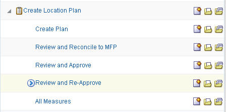

Location Planning is the process during which planners create the location plans at the Store level. These plans are then compared to and reconciled against the Merch Plan.

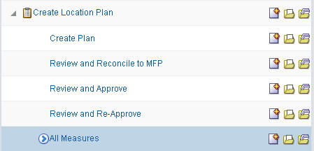

To build the workbook, complete the following steps:
Click the Create New Workbook icon in the Create Location Plan task.
The Product Selection step of the workbook wizard is displayed. Select the department you want to plan and move it to the Selected Items box. Click Next.

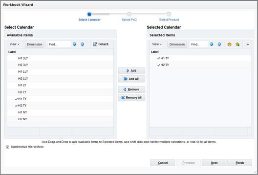

The workbook wizard opens at the Calendar Selection step. Select the halves that you want to plan and move them to the Selected Items box. Click Next.

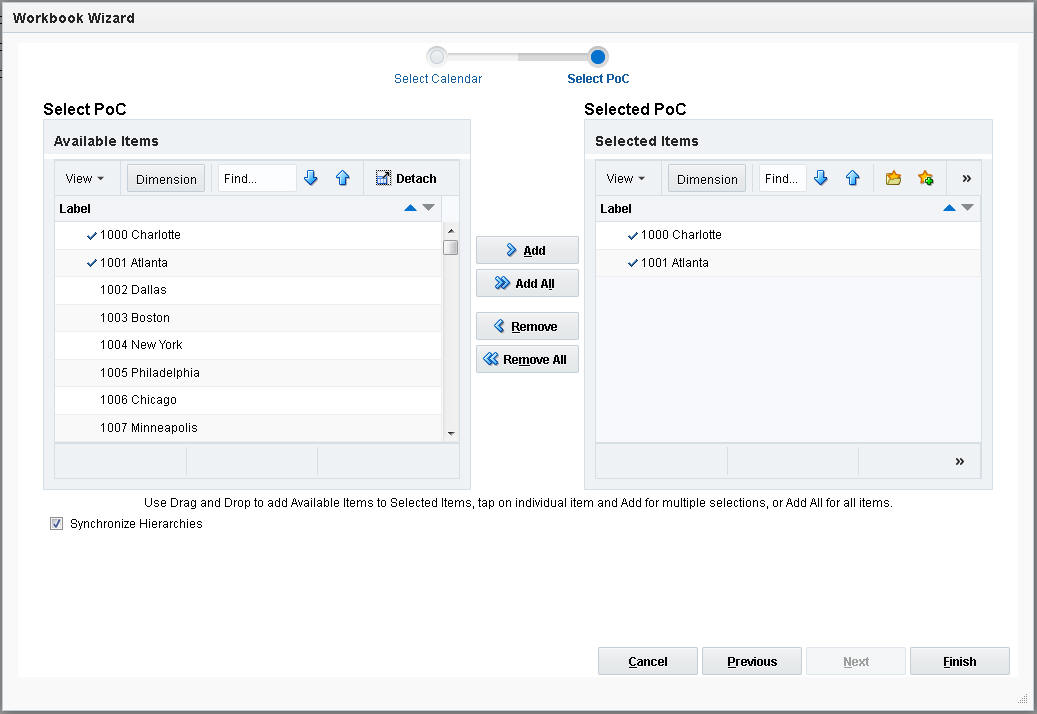

The Location Selection step of the workbook wizard is displayed. Select the channels you want to plan and move them to the Selected Items box. Click Finish.

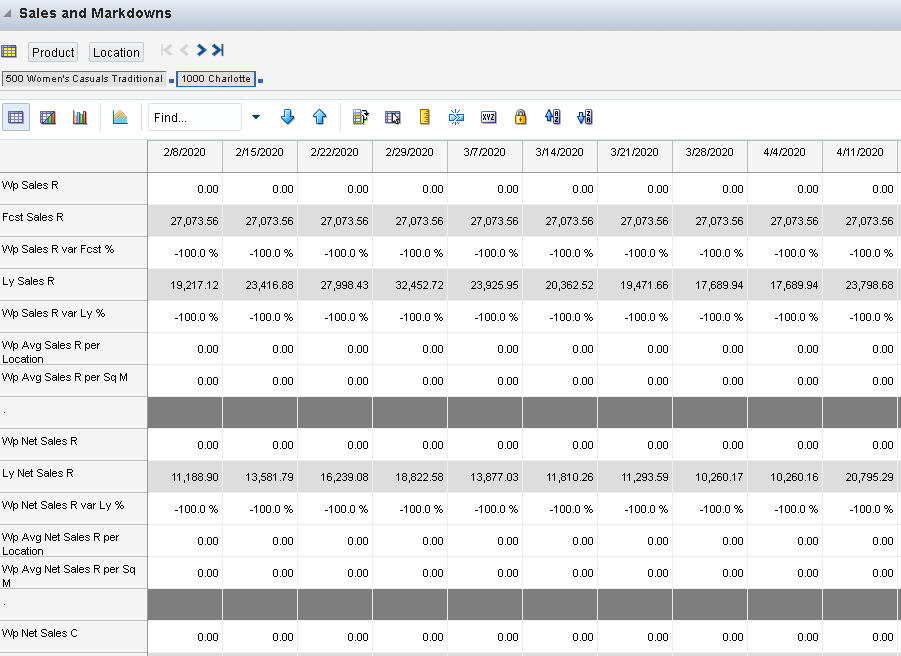

After seeding, the user can validate the seeded sales and markdown data in this view.

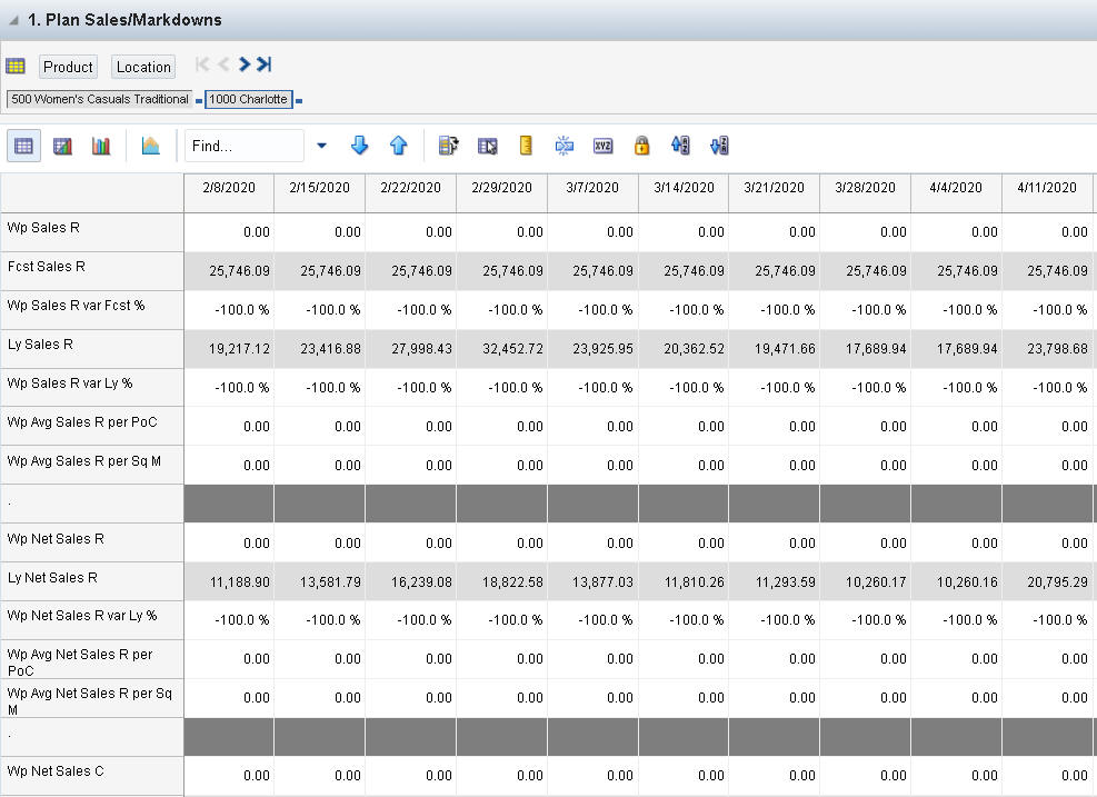

After you have seeded, develop the sales and markdown location plan for those departments. The second tab within the Create Plan step, Sales/Markdowns, has one default view: Plan Sales and Markdowns.

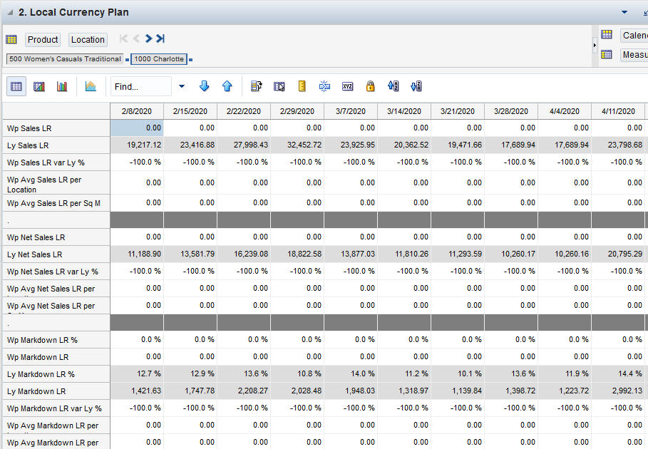

If Wholesale Franchise or Local Currency options are provisioned, then there are additional views to support planning Sales/Markdowns that specifically cater to these options.
Local Currency Plan

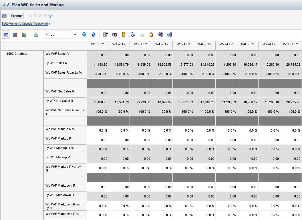

Plan W/F Sales and Markup
The Local Currency step displays your plan using the local currency conversion set up by the administrator.
If the Wholesale Franchise options are provisioned, then this additional view will be available to plan additional wholesale/franchise measures in this view.

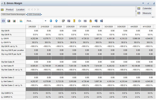

The third tab within the Create Location Plan step, Inventory/Gross Margin, has two default views: Plan/Receipts and Inventory and Gross Margin.

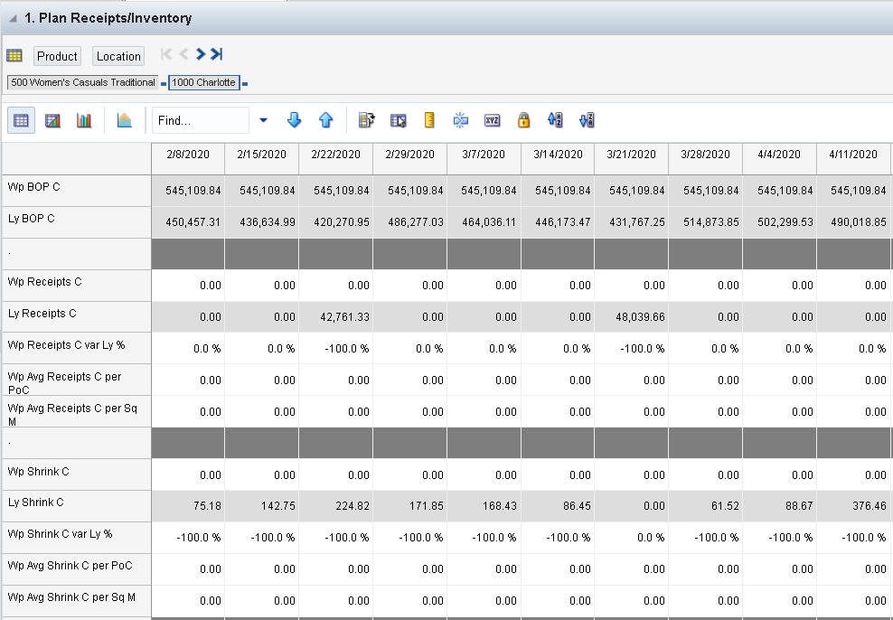

After you have developed the sales and markdown plan, you develop a receipts and inventory plan that can support the sales and markdown plan. The purpose of this step is to ensure that you have a receipt and inventory plan that supports the sales that you are projecting. Like the Plan Sales and Markdowns View, the Plan Receipts/Inventory view contains several Ly metrics that you can reference when setting your targets. Additional measures can be used to adjust your inventory targets.
Use the Gross Margin view to evaluate the gross margin created from your sales and markdown plan and receipts and inventory plan. Determine whether the planned gross margin meets your gross margin goal. If it does not, return to the Plan Sales and Markdown Plan and Plan Inventory and Receipt Plan steps to adjust your receipt markups and receipt flow. When you return to the Plan Sales and Markdowns view, adjust the markdown plans, but do not change the sales. Continue this process until you are satisfied with the gross margin.
If Wholesale Franchise or Local Currency options are provisioned, then there are additional views to support planning sales and markdowns that specifically cater to these options.

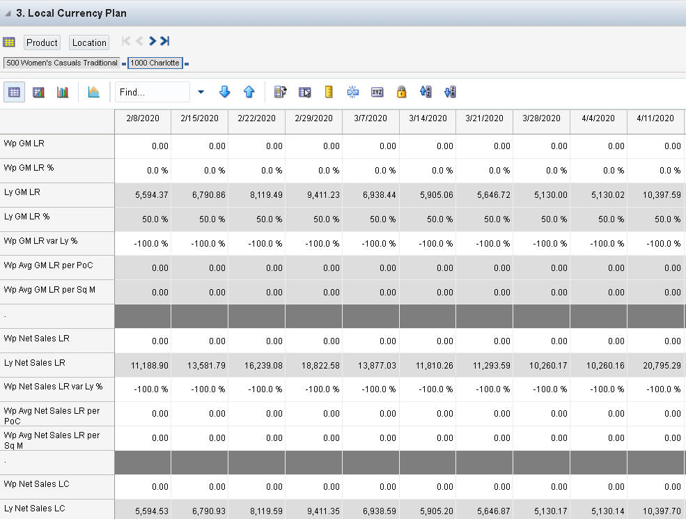

Local Currency Plan

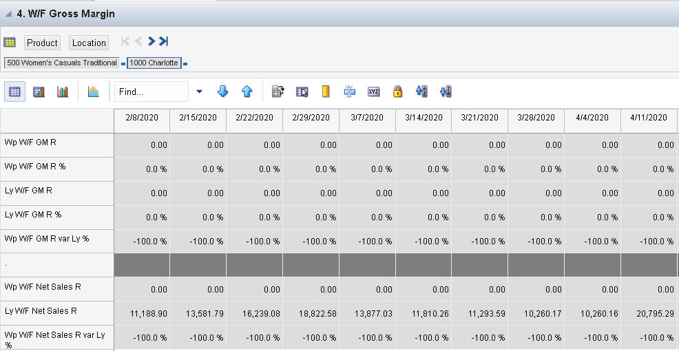

W/F Gross Margin
The Local Currency Plan view shows the Gross Margin plan using the local currency conversion set up by the administrator.
The W/F Gross Margin view shows the planned Wholesale Franchise Gross Margin if this option is provisioned.

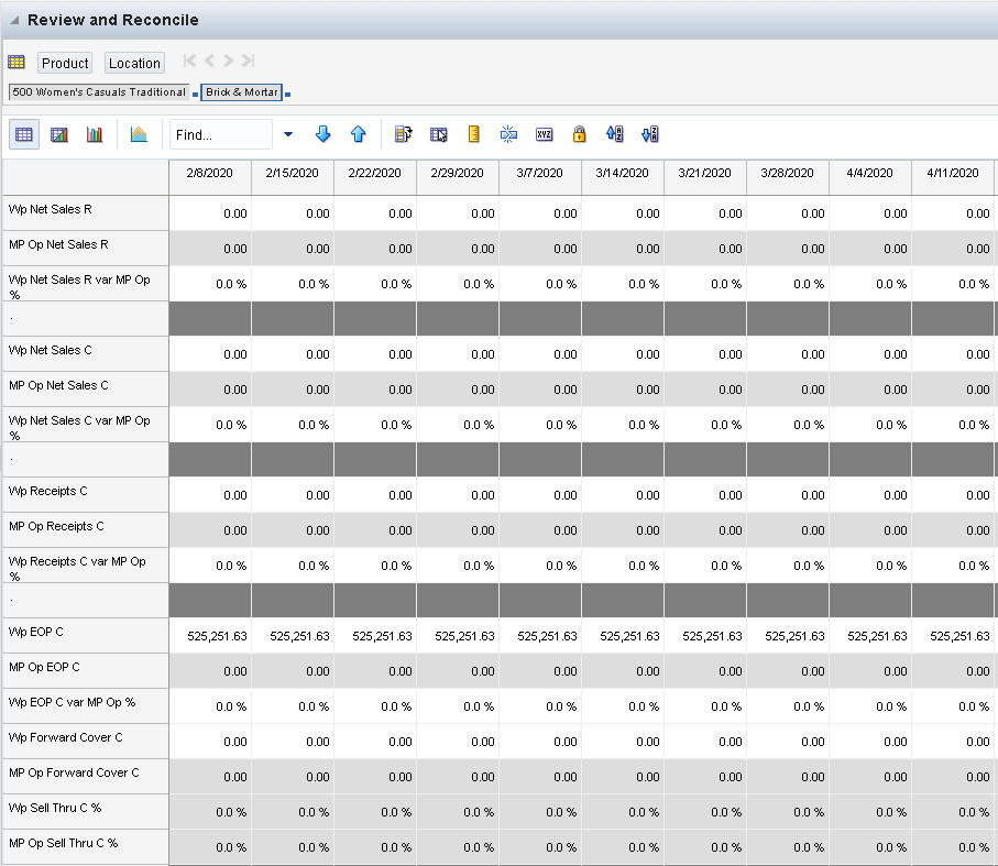

In this step, review and compare your targets to the top down targets to see if you meet the goals created by the top down user. Use the MFP OP and the MFP CP measure profiles to reconcile your location plan to the Merch Plan targets.

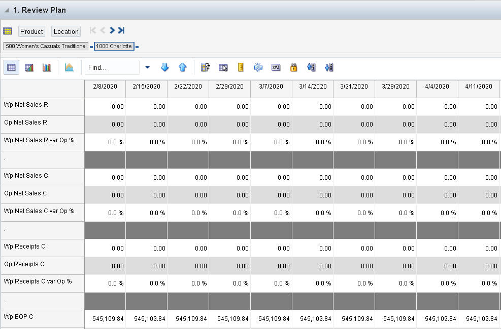

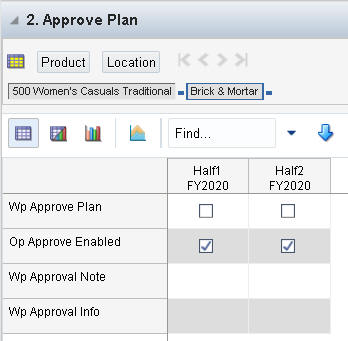

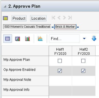

In this step, the location planner can review and approve the created location plan. The Review and Approve step contains two views: Review Plan and Approve Plan.

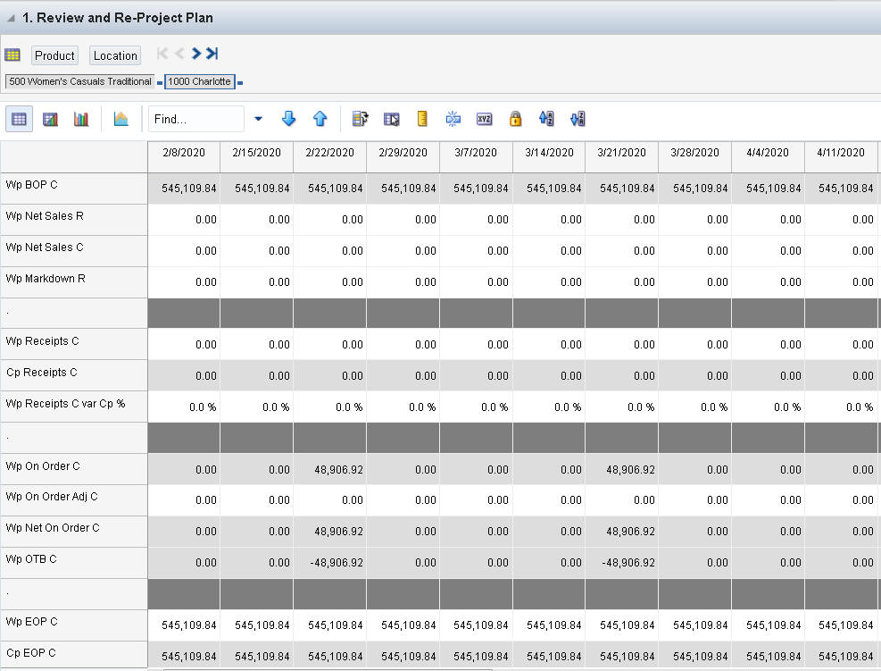

Use this step to review the location plan during in-season for On Order and Open to Buy and to update the plan and reapprove if necessary. The Review and Re-Approve step has two views: Review and Re-Project Plan and Approve Plan.
