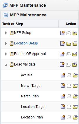

The MFP Maintenance activity consists of the following tasks:
MFP Setup
Location Setup
Enable Op Approval
Load Validate
This chapter focuses on the steps within the Load Validate task, which include:
Actuals
Merch Target
Merch Plan
Location Target
Location Plan
To use the Load Validate task, you must first build the workbook.
Once built, the workbook contains all measures that are either loaded or touched during the batch calculation process, providing an avenue by which an administrator can verify data loads and batch processes.

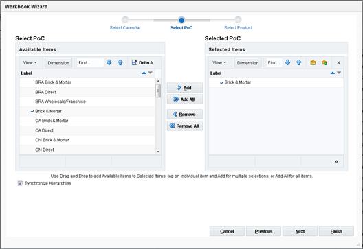

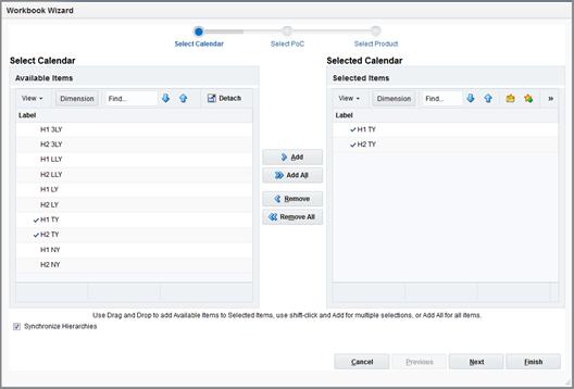

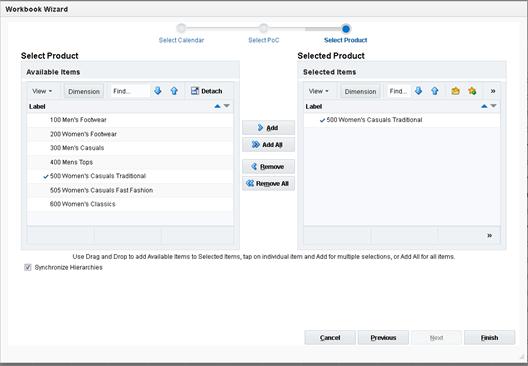

To build a Load Validate workbook, perform the following steps:
Click the New Workbook icon in the Load Validate step.
The Calendar Selection step appears. Select the years and click Next.
The Location Selection step appears. Select the channel and click Next.
The Product Selection step appears. Select the items and click Next.
The Data Load Validation workbook is built.

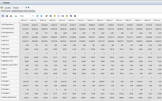

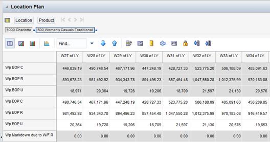

The Actuals step includes a single view of the same name, the Actuals view. Use this view to validate that the actuals data was loaded in the batch process.
Table 5-1 Actuals View Worksheet Measures
