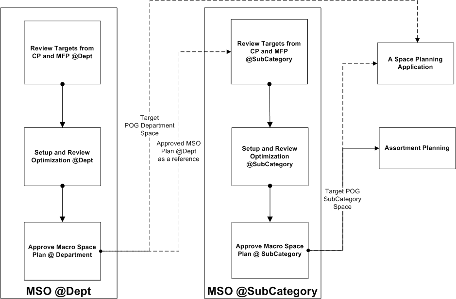

The following flowchart shows the MSO process flow in RCM:
  1. Start with MSO at the department level.
  2. Check the department level optimization results referred by a space management system and MSO @ Sub-Category.
  3. Perform MSO at the sub-category level.
  4. Share the sub-category level optimization results with the assortment planning and optimization process.
Figure 5-3 Macro Space Optimization Process Flow

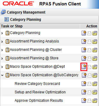

  1. Select the New Workbook icon in the Macro Space Optimization @Dept task.
    Figure 5-4 Macro Space Optimization @Dept Task
    The workbook wizard opens.

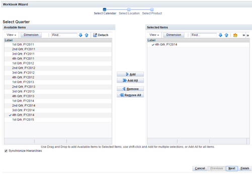

  3. Select the quarters and move them to the Selected Items box. Click Next.
    Figure 5-6 Workbook Wizard Select Quarter Page

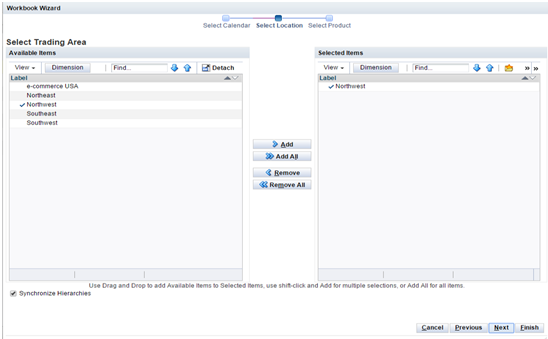

  4. Select the trading areas and move them to the Selected Items box. Click Finish.
    Figure 5-7 Workbook Wizard Select Trading Area Page
    The workbook is created.

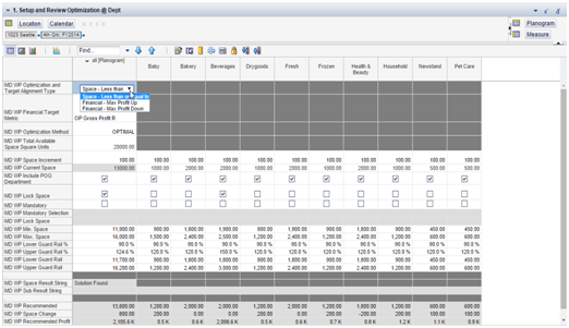

To run MSO and review the results:
  1. Set the constraints for optimization mechanics:
    • Optimization Type and Target Alignment Type: There are two types of optimization: Space-based and Financial parameter-based. The space-based optimization type has the target alignment type of Less than or Equal to. For Financial parameter-based, the two options include Max Profit Up and Max Profit Down. The combined options include:
      • Space - Less than or Equal to
      • Financial - Max Profit Up
      • Financial - Max Profit Down
    • Financial Target Metric and Optimization Method: Optimization can be based on the different financial target metrics which include MFP Gross Profit R and OP Gross Profit R. There is one optimization method available: Optimal.
  2. Set space constraints:
    • Upper guard rail % or Upper guard rail space: Upper guard rail space is used in optimization to define the upper limit of space allocation for any POG Department, so as to keep the optimization results within an upper bound value of space. It can be defined as a percentage of the current space.
    • Lower guard rail % or Lower guard rail space: Similar to the Upper guard rail, Lower guard rail space is defined as the lower limit of space allocation for any POG Department and can also be defined as a percentage of current space.
    • Max and min space: Max and min space values represent the highest upper limit and lowest limit of space that can be made available to any POG Department. Optimization process picks the lower of the max space and upper guard rail space and the higher of the min space and lower guard rail space as inputs while setting the range of optimization results.
    • Current space, total available space and space increments for POG Departments: Current space represents the space allocated to any POG Department in the current store layout. Total available space represents the total selling area of the store. Space increments are based on the shelves and fixtures specifications for different POG Departments, which determine the minimum length by which current space can be changed for a specific POG Department.
  3. Set the optimization scope per the business requirements:
    1. Select the POG Departments to be included in the optimization.
    2. Lock the current space for the POG Departments, if required.
    3. Select the mandatory POG Departments. Mandatory POG Departments should definitely be part of the final assortment. Checking the mandatory flag for a POG Department ensures that it gets a higher priority in space allocation from the available space.
  4. After setting the constraints, run the Optimize Dept custom menu.
  5. Review the optimization results in the form of recommended space and respective gross profit by comparing them with the set space constraints and targets in the Category Scorecard.
  6. Review the optimization results in the form of histograms.

Figure 5-9 shows an example of this view with the constraints set and optimization results derived at the POG Department level.
Figure 5-9 1. Setup and Review Optimization @ Dept View
Table 5-2 lists the measures available on this view.
Table 5-2 1. Setup and Review Optimization @ Dept View Measures
Label Description
MD WP Optimization Target and Alignment Type
Used to define the type of MSO and type of target alignment from a drop-down selection. The following options are available for selection: Space - Less than or Equal to, Financial - Max Profit Up, and Financial - Max Profit Down.
MD WP Financial Target Metric
Used to assign the target metric to be used as the basis for MSO. The options available are: MFP Gross Profit R and OP Gross Profit R.
MD WP Optimization Method
Method adopted by MSO is defined through this measure. There is one optimization method available: Optimal.
MD WP Total Available Space Square Units
Represents the total available space of the stores in square units used to allocate space to the POG Departments in the upcoming space plan or working plan.
MD WP Space Increment
Represents the incremental value of space in square units by which the space should be increased or decreased for a POG Department. This is based, in general, on the shelves and fixture specifications used in the department and store.
MD WP Current Space Square Units
Represents the current space, in square units, assigned to a POG Department at a store.
MD WP Include POG Department
Flag measure used to mark the POG Departments which should participate in MSO for space allocation.
MD WP Lock Space
Flag measure used to lock space for a POG Department in the MSO run. It is used to maintain the current space allotted to the POG Department in the upcoming space plan or working plan. The current space of the locked POG Department is deducted from the total available space to calculate the effective total available space used for allocating space for the rest of the POG Departments participating in MSO.
MD WP Mandatory
Flag measure used to mark the mandatory POG Departments, which should be given higher priority in space allocation from the total available space by MSO.
MD WP Lock Space Selection Error
Measure used to present the error messages if the Lock Space measure is checked for a POG Department without including the POG Department (through Include flag measure) for the MSO run.
MD WP Mandatory Selection Error
Measure used to present the error messages if the Mandatory measure is checked for a POG Department without including the POG Department (through Include flag measure) for the MSO run.
MD WP Min. Space
Minimum amount of space that can be allocated to a POG Department.
MD WP Max. Space
Maximum amount of space that can be allocated to a POG Department.
MD WP Lower Guard Rail %
User-defined lower limit space percentage output for a POG Department required from an optimization run. It is expressed as an absolute percentage of current space of a POG Department. It is used to control the lower limit of recommended space output for a POG Department, from an optimization run, so as to keep it within the range per the business requirements.
MD WP Upper Guard Rail %
User-defined upper limit space percentage output for a POG Department required from an optimization run. It is expressed as an absolute percentage of the current space of a POG Department. It is used to control the upper limit of recommended space output for a POG Department, from an optimization run, so as to keep it within the range per the business requirements.
MD WP Lower Guard Rail Space
User-defined lower limit space output for a POG Department required from the optimization run. It can be directly entered or calculated on the basis of MD WP Lower Guard Rail %. It is used to control the lower limit of recommended space output from an optimization run, so as to keep it within the range per the business requirements.
MD WP Upper Guard Rail Space
User-defined upper limit space output for a POG Department required from the optimization run. It can be directly entered or calculated on the basis of MD WP Upper Guard Rail %. It is used to control the upper limit of recommended space output from an optimization run, so as to keep it within the range per the business requirements.
MD WP Space Result String
Measure used to present the error messages applicable at the aggregate level in an optimization run. For example: Max Capacity is invalid.
MD WP Sub Result String
Measure used to present the specific error messages in the optimization run. It specifically points to the POG Department where some user-defined constraints are off-the-mark. For example: Invalid Min Max Constraints for a specific POG Department.
MD WP Recommended Space
Recommended space output for a POG Department from an MSO run corresponding to the recommended gross profit retail. The CP version of the measure is used to store the approved results.
MD WP Space Change
Difference between the recommended space and current space for a POG Department.
MD WP Recommended Gross Profit R
Recommended gross profit retail output for a POG Department from an MSO run corresponding to the recommended space. CP version of the measure is used to store the approved results.
MD WP Gross Profit Change
Difference between the recommended gross profit and working plan gross profit retail for a POG Department.
Custom Menu
