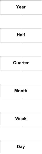

Figure 6-1 shows the CLND hierarchy in the RCM configuration.
| Name | Label | Hierarchy Type | Child |
| YEAR | Year | Main | SSN |
| SSN | Half | Main | QRTR |
| QRTR | Quarter | Main | MNTH |
| MNTH | Month | Main | WEEK |
| WEEK | Week | Main | DAY |
| DAY | Day | Main | None |
The Calendar hierarchy represents time in all RPAS solutions. It is a required hierarchy. RPAS requires a dimension named day (Day). This level is not displayed in the solution.
Category Management has many measures with a time component. Most "actuals" data (such as sales, cost, margins, and markdowns) is stored at the week level. Many calculations (such as market share and market growth) and index-type information (loyalty, penetration, and buyer conversion) are used at the quarter level. Basic RPAS functionality allows the user to view time-dependent data at any desired aggregate level.
With this in mind, a retailer implementation can structure the Calendar hierarchy in any way that best suits the retailer's functional needs. Dimensions other than week and quarter have been included in the Category Management configuration for the purpose of illustration. They can be modified or removed without requiring changes to any other elements of the Category Management configuration. Other dimensions and hierarchy branches may also be added without requiring changes to other elements of the Category Management configuration.

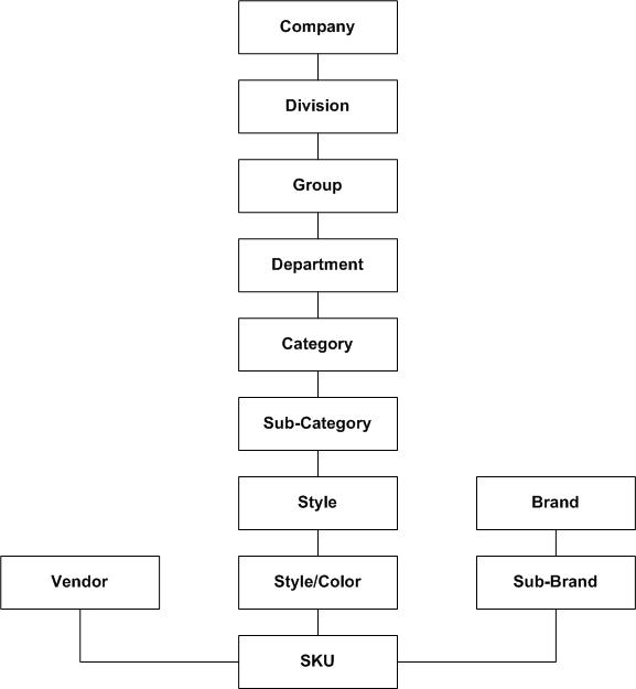

Figure 6-2 shows the PROD hierarchy in the Category Management configuration.
| CMMP | Company | Main | DVSN |
| DVSN | Division | Main | PGRP |
| PGRP | Group | Main | DEPT |
| DEPT | Department | Main | CLSS |
| CLSS | Category | Main | SCLS |
| SCLS | Sub-category | Main | STYL |
| STYL | Style | Main | STCO |
| STCO | Style/Color | Main | SKU |
| SKU | SKU | Main | None |
| VNDR | Vendor | Alternate | SKU |
| BRD | Brand | Alternate | SBRD |
| SBRD | Sub-Brand | Alternate | SKU |
The product hierarchy represents the retailer's merchandise (that is, merchandise that the retailer sells through its retail channels). Much of the work in Category Management focuses on the category and sub-category levels. Some workbooks and worksheets are focused on working with data at the SKU level. Style and Style-color levels are included in the configuration in between SKU and Sub-category.
A Category Management domain is typically partitioned at Department level or higher. Partitioning the domain above category allows multiple categories to be compared and analyzed side-by-side.
Several alternate rollups are provided for SKU. One relates SKU to Vendor and the other to Sub-brand and Brand. These alternate rollups provide additional insight and options for analysis.
The product hierarchy is also the base on which dynamic hierarchies are built. These dynamic hierarchies are created based on a consumer decision tree (CDT). They form an additional alternate hierarchy based on SKU. The dynamic hierarchies are based on product attributes (see Product Attributes (ATTR) Hierarchy) and can have a varying number of levels. Further, the rollup path can differ for different products.
Note: Any changes to this hierarchy must be accompanied by changes to all the elements that employ the particular level that is being modified or removed. Adding levels or branches or changing labels should not require any changes to the Category Management configuration.Further, any changes to the product hierarchy should be replicated to the right-hand side product hierarchy (PROR). This is important in keeping cross-product information available and up-to-date. For more information, see "Right-Hand Side Product (PROR) Hierarchy". |

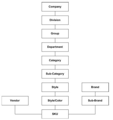

Figure 6-3 shows the Right-Hand Side Product (PROR) hierarchy in the Category Management configuration.
| CMMR | Company | Main | DVSR |
| DVSR | Division | Main | PGRR |
| PGRR | Group | Main | DEPR |
| DEPR | Department | Main | CLSR |
| CLSR | Category | Main | SCLR |
| SCLR | Sub-category | Main | STYR |
| STYR | Style | Main | STCR |
| STCR | Style/Color | Main | SKUR |
| SKUR | SKU | Main | None |
| VNDR | Vendor | Alternate | SKUR |
| BRDR | Brand | Alternate | SBRR |
| SBRR | Sub-brand | Alternate | SKUR |
The right-hand side product hierarchy (RHS Product or PROR) needs to be an exact replica of the main product hierarchy. The purpose of this hierarchy is to allow RCM to store and use various cross-product quantities related to Demand Transference (DT). Examples of these quantities include Item-Item Similarities, Demand Transferred, Substitutable Demand, and so on.
The DT calculations are always related back to SKUs in the main product hierarchy. So there is no partitioning done or dynamic hierarchies built on PROR.
Note: Any changes to the main product (PROD) hierarchy must be replicated into the right-hand side product (PROR) hierarchy. This ensures that the demand transference data and calculations are complete and reliable. |
