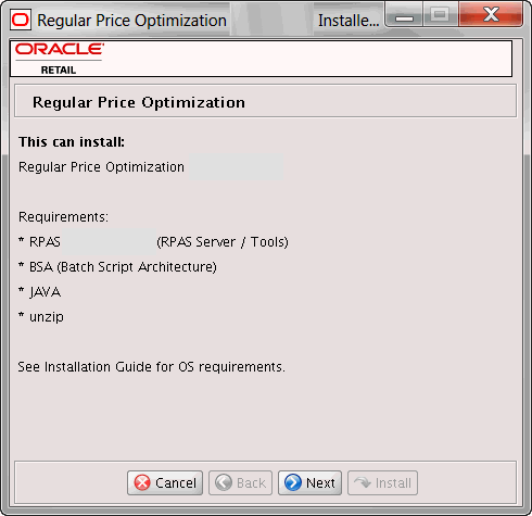

  6. The Regular Price Optimization Installer Window opens and displays the components that are installed during the installation process, as well as the required components.
    Click Next to continue.
    Oracle Retail Batch Scripting Architecture (BSA) must be installed prior to installing RPO. For information about installing BSA, see the Oracle Retail Batch Script Architecture Implementation Guide.

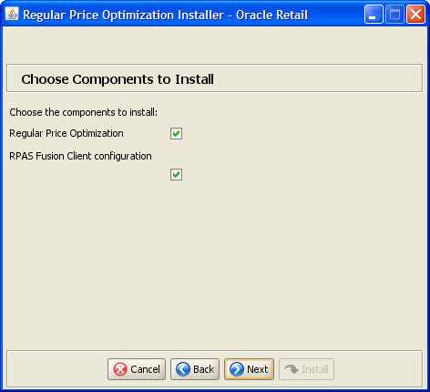

  7. The Choose Components to Install Window opens.
    Figure 2-2 Choose Components to Install Window
    Surrounding text describes Figure 2-2 .
    Select the following options:
    • Regular Price Optimization – Select this option to install the RPO server with the domain.
    • RPAS Fusion Client configuration – Select this option to install the RPAS Fusion Client configuration for RPO. For more information on the configuration files included for the RPAS Fusion Client, see Configuration Files for the RPAS Fusion Client.
    If you do not want to install the RPAS Fusion Client configuration, clear this check box and skip steps 10 and 11.

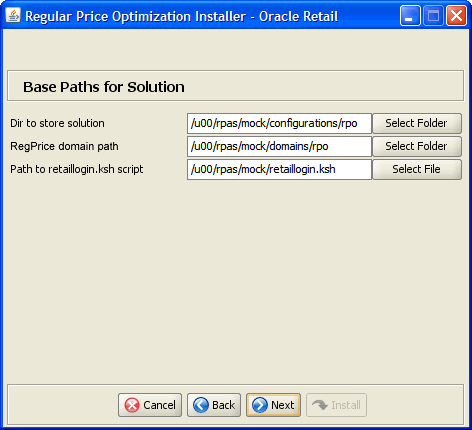

  8. The Base Paths for Solution Window opens.
    Figure 2-3 Base Paths for Solution Window
    Surrounding text describes Figure 2-3 .
    Enter the relevant information in the following fields:
    • Dir to store solution - Enter the directory path where your solution should be stored.
    • RegPrice domain path - Enter the directory path where domains for this solution should be stored.
    • Path to retaillogin.ksh script - Enter the path and file name to the retailogin.ksh script created during RPAS installation.
    Ensure that the installation paths are located outside the installer directory [RPO Installation].

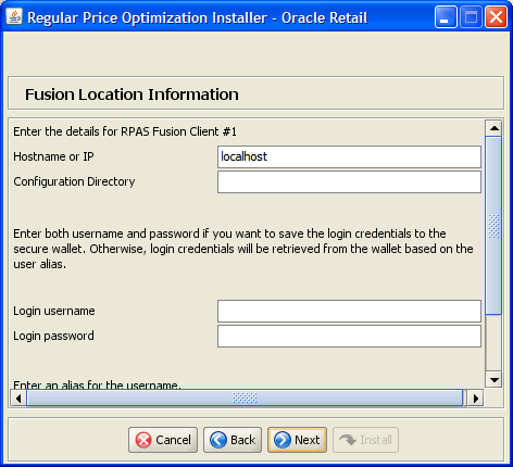

  11. Based on the number of servers you entered, the Fusion Location Information (Details) Window opens.
    Figure 2-6 Fusion Location Information (Details) Window
    Surrounding text describes Figure 2-6 .
    Enter the server details in the following set of fields for each configuration:
    Field Description
    Hostname or IP Enter the host name or IP address of the server where the RPAS Fusion Client is installed.
    Configuration Directory Enter the location of the config directory available at the location where the RPAS Fusion Client is installed.
    Login username Enter the user name to log on to the server where the RPAS Fusion Client is installed.
    Login password Enter the password associated with the user name.
    Login username alias Specify an alias name for the administrative user. Specifying an alias name for the administrative user enhances the security for the application. When left blank, the alias name defaults to the administrative user name.

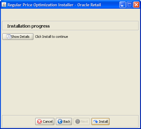

  12. The Installation Progress Window opens. To start the installation, click Install.
    Figure 2-7 Installation Progress Window
    Surrounding text describes Figure 2-7 .
    This window also displays the progress of the installation routine. Click Show Details to view the log output as the installation is performed. If you do not select to view the details, a graphical representation of the installation steps appears. As each step is completed, the color changes to show you the progress.
    You can toggle between detailed mode at any time during or after the installation.
