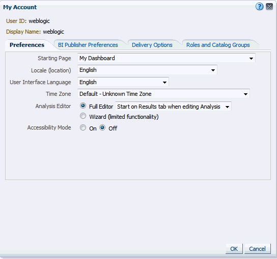

Operational Insights Dashboards and reports displays the reports in the same language as ReSA by accepting the Lang parameter from the ReSA system. However the locale setting are independent of the locale setting in ReSA. The language and Locale can be set for a user using the My Account OBIEE preferences as shown below. The language setting in OBIEE My Account preferences is however overwritten by the Lang parameter passed from ReSA once the reports are accessed from within ReSA (embedded in ReSA).
Figure 6-2 My Account option

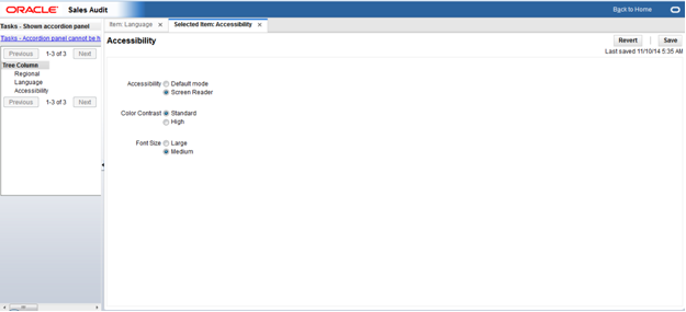

  3. From the Tasks pane, click Accessibility to open the Accessibility tab.
    Figure 6-4 Accessibility Tab
  4. Select Screen Reader to enable accessibility mode and click Save.
    Figure 6-5 Enabling the Screen Reader

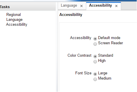

  2. From the Tasks pane, click Accessibility to open the Accessibility tab.
    Figure 6-7 Accessibility Tab

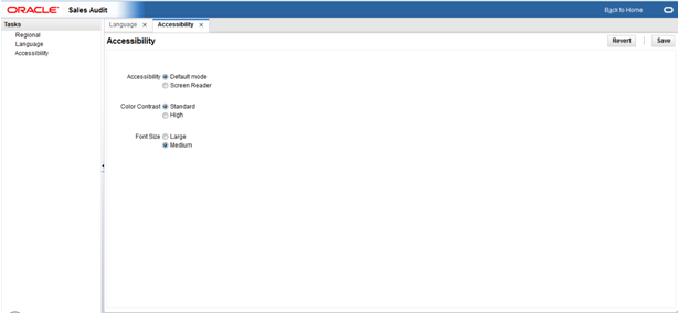

  3. Select Default mode.
    Figure 6-8 Accessibility Settings
  4. Click Save to save the settings.
