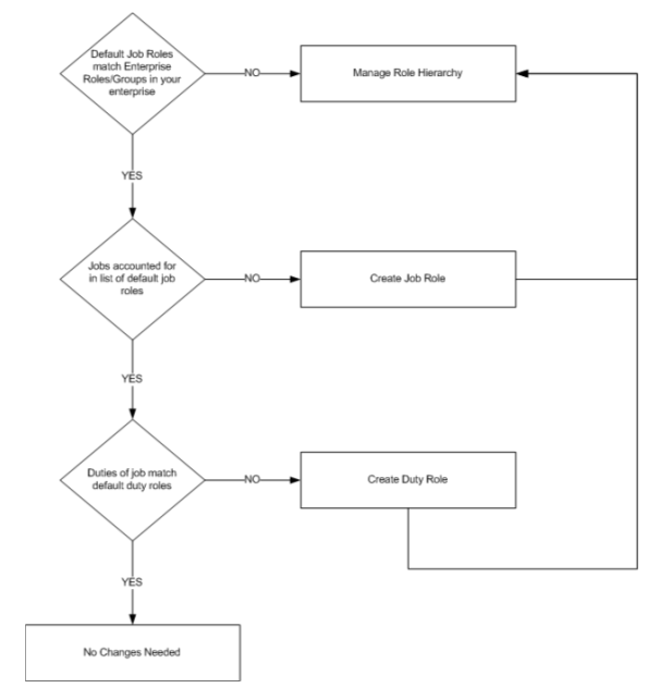

Retail role hierarchies are structured to reflect the Retail business process model.
Job roles inherit duty roles. For example, the ReIM application administrator Job role inherits the SYSTEM_OPTIONS_MAINTENANCE_DUTY roles.
<app-role> <name> SYSTEM_OPTIONS_MAINTENANCE_DUTY </name> <class>oracle.security.jps.service.policystore.ApplicationRole</class> <members> <member> <class>oracle.security.jps.internal.core.principals. JpsXmlEnterpriseRoleImpl</class> <name> REIM_APPLICATION_ADMINISTRATOR_JOB </name> </member> </members></app-role>
Duty roles inherit Privilege roles. Duty roles can inherit one or more other Duty roles.
Example: DOCUMENT_MANAGEMENT_DUTY inherits DOCUMENT_INQUIRY_DUTY role.

Note: Make sure that the policy store is loaded with the default security configuration. For more information, see the Post Installation steps in the Oracle Retail Invoice Matching Installation Guide. |
The common decisions made to match your enterprise to the default security reference implementation include the following:
Do the default job roles match the equivalent job roles in your enterprise?
Do the jobs in your enterprise exist in the security reference implementation?
Do the duties performed by the jobs in your enterprise match the duties in the security reference implementation?
Important: It is important when constructing a role hierarchy that circular dependencies are not introduced. The best practice is to leave the default security configuration in place and first incorporate your customized application roles in a test environment. |
Retail applications provide a way in which retailers can modify the default roles to map to their security groups through the Retail Application Administration Console (RAAC).

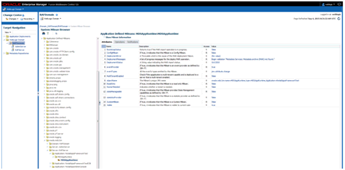

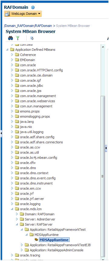

Perform the following steps to access the MDSAppRuntime MBean.
Login to the Oracle Enterprise Manager by navigating to the URL in the following format:
http://<host>:<port>/em/
From the Navigation menu, under WebLogic Domain, right-click on the application domain and navigate to System MBean Browser from the context menu.
Choose the correct domain based on your installation. The figure below displays RAFDomain.
Under Application Defined MBeans, locate MDSAppRuntime which can be found under the following folder structure:
> oracle.mds.lcm > Server: AppServer > Application: Application Name > MDSAppRuntime
Choose the correct server and the Retail Application name based on your installation. The figure below displays RAFServer and RetailAppsFrameworkTest application.
Click MDSAppRuntime management bean (MBean).
Select the Operations tab to view the operations available for the MDSAppRuntime MBean.
These are the operations which can be used in managing MDS Customizations. The exportMetadata, deleteMetadata, importMetadata, createMetadataLabel, listMetadataLabels, deleteMetadataLabel, and promoteMetadataLabel; will be briefly discussed in the following sections.
