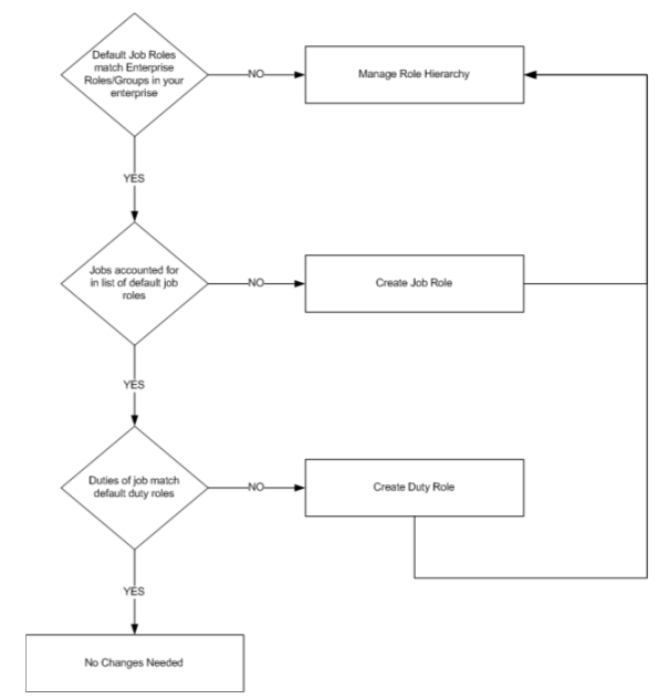

The common decisions made to match your enterprise to the default security reference implementation include the following:
  • Do the default job roles match the equivalent job roles in your enterprise?
  • Do the jobs in your enterprise exist in the security reference implementation?
  • Do the duties performed by the jobs in your enterprise match the duties in the security reference implementation?
Figure 3-2 Decisions for Default Security Reference Implementation
Important:
It is important when constructing a role hierarchy that circular dependencies are not introduced. The best practice is to leave the default security configuration in place and first incorporate your customized application roles in a test environment.

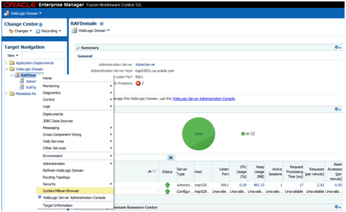

  2. From the Navigation menu, under WebLogic Domain, right-click on the application domain and navigate to System MBean Browser from the context menu.
    Choose the correct domain based on your installation. The figure below displays RAFDomain.
    Figure 3-3 RAFDomain window

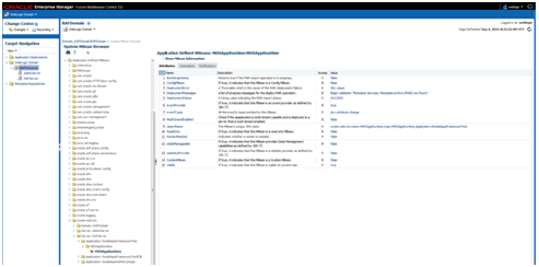

    Figure 3-5 MDSAppRuntime window

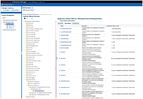

  5. Select the Operations tab to view the operations available for the MDSAppRuntime MBean.
    Figure 3-6 Operations Tab window
    These are the operations which can be used in managing MDS Customizations. The exportMetadata, deleteMetadata, importMetadata, createMetadataLabel, listMetadataLabels, deleteMetadataLabel, and promoteMetadataLabel; will be briefly discussed in the following sections.

  2. Import metadata by selecting the importMetadata operation available from the Operations tab.
  3. For fromLocation, enter the path of the directory or archive from which the documents will be imported.
    Example: /tempDir/downloads/mdsExport/RetailAppsFrameworkTestMDS.zip
  4. For excludeBaseDocs, select true. A Boolean value indicating whether to exclude base metadata documents from being imported.
  5. For docs, click the pencil icon. On the Edit Parameter popup, click Add, and in the Element box, enter a list of comma-separated, fully qualified document names or document name patterns.

Creating Metadata Labels
  1. Navigate to the MDSAppRuntime management bean (MBean), as described in the section "Using the System MBean Browser and the MDSAppRuntime MBean".
  2. Create metadata label by selecting the createMetadataLabel operation available from the Operations tab.
  3. For label, enter a valid name of the new metadata label to be created.
  4. Click Invoke, located at the upper-right corner of the page, to proceed with the operation.
  5. A confirmation message will display in the page. Click Return to return to the list of operations.

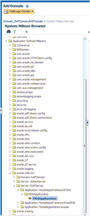

Promoting Metadata Labels
  2. Create metadata label by selecting the promoteMetadataLabel operation available from the Operations tab.
  3. For label, enter a valid name of the new metadata label to be promoted. Promoting metadata labels can be used to roll back to an earlier version of the document, as captured by the label.
